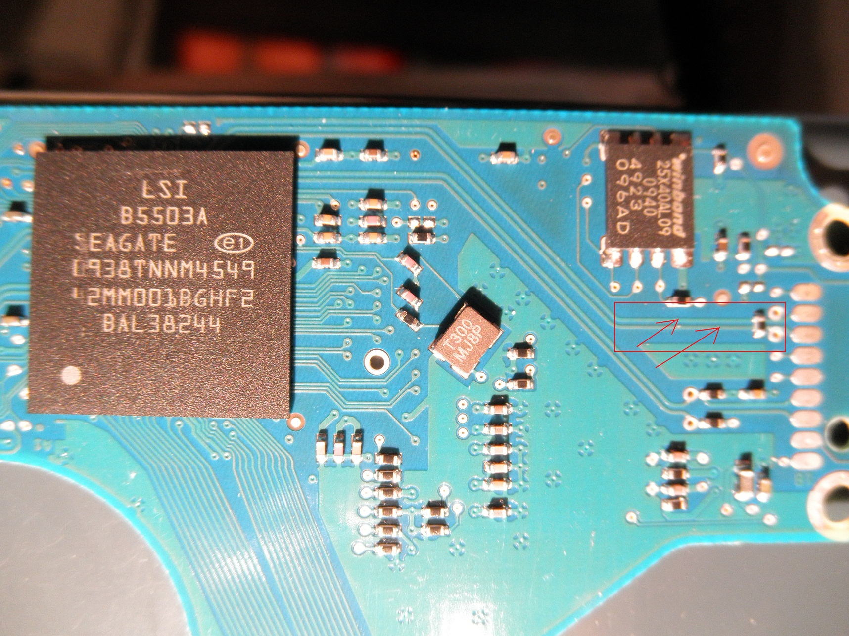

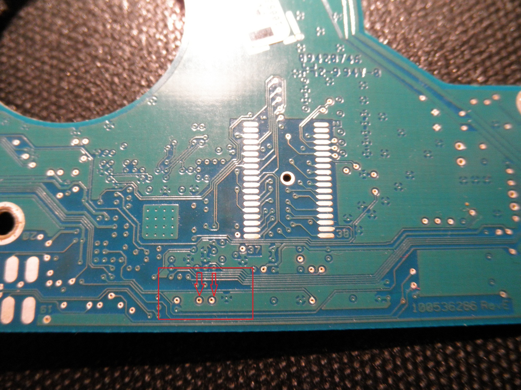

We have a Momentus 5400.6 model ST9500325AS, which gives the HDD Lock (LED: 00000CC) and Translation Violation (0gb) errors when PC-3000 utility starts. We have a couple of questions:
1. We are not certain which contacts to short when performing the HDD Lock fix. I have attached two photos, one showing the chip side and the read-write channels we believe to be the correct ones. The other photo shows the contacts we think correspond to those on the other side of the board. Are these the ones to short during the fix?
2. This drive spins when starting up, but only when in BSY. When it enters drive ready state it stops spinning. Am I correct to think the HDD Lock fix can only be done when the drive is spinning? Can we do it when the drive is in BSY state?

Could someone please advise on the short points for this procedure. Specifically where they are? Thanks
