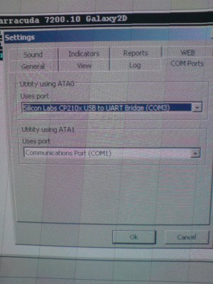

my seting :

You should set CP210 to both ATA0 and ATA1. If other utility that use terminal is open on other channel, like samsung or seagate, terminal will not work. Try other disk also to be sure.
