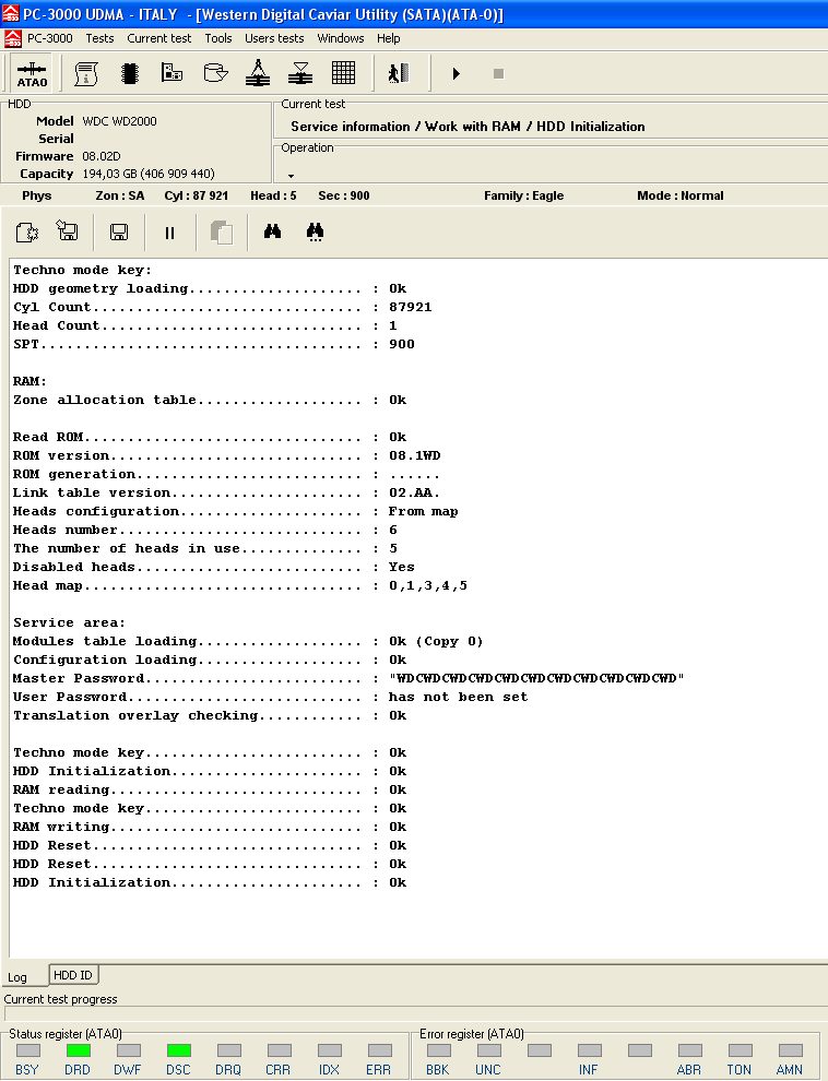

With New Version (4.9.1) it's possible to change head map in ram also for Caviar 32Cyl.
i have try to change headmap -> go to HDD ID -> F5 but no ID no LBA
so i try to HDD initialization-> HDD ID->F5 and i get wrong LBA.
There is some workaround?
hdd model is WD2000BB-00GUC00

What head map have you set in RAM?
0 0 0 0 0?
If so try to set
1 1 1 1 1
