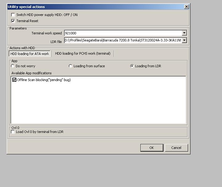

You write in your news that we can put off "of-line scan"
Which menu activate that function (I downloaded and uploaded my PC3000 UDMA with ver 4.04)

Leave PC-3000 Seagate utility open and switch to Data Extractor.
Then create a new task and check "Utility actions" option and proceed.
Selecting this option will let you use loader for Seagate drives and solve "Add to pending" message bug.
Please see the attached picture.
