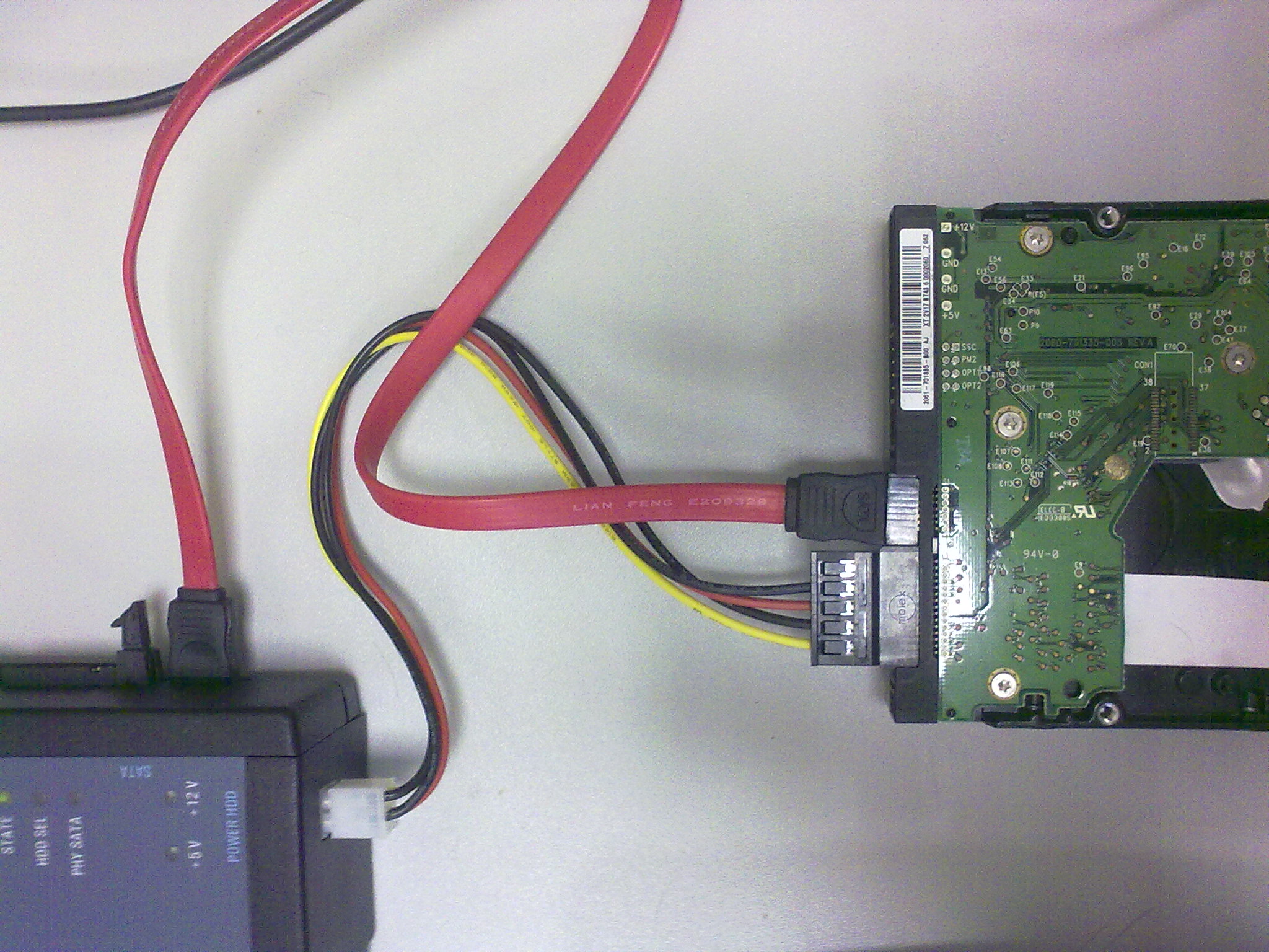

Just got our PC 3000 portable today. I am comparing the items that are in the box and in the manual and seems the pata-sata adaptor is missing. But I also notice there's a sata port thats built-in in the PC 3000 Portable adaptor and it also has its own power adaptor, which was not mentioned in the manual and from the product website. Is this a new version? Do I still need a separate ATX Power Supply?
Can anyone share a photo showing the connection of the PC, the hard drive and the PC 3000 Portable adaptor.
Re: Is there a new version of PC 3000 Portable
Postby ACE_Admin » 10.05.11, 13:51
Dear Topeetan
It looks like I have sent you the photo. Anyway it would be useful to watch the photo with sata drive connected to PC-3000 Portable. New device did not need sata-pata adapter since it has a built-in port near IDE port. Please check my picture below.
