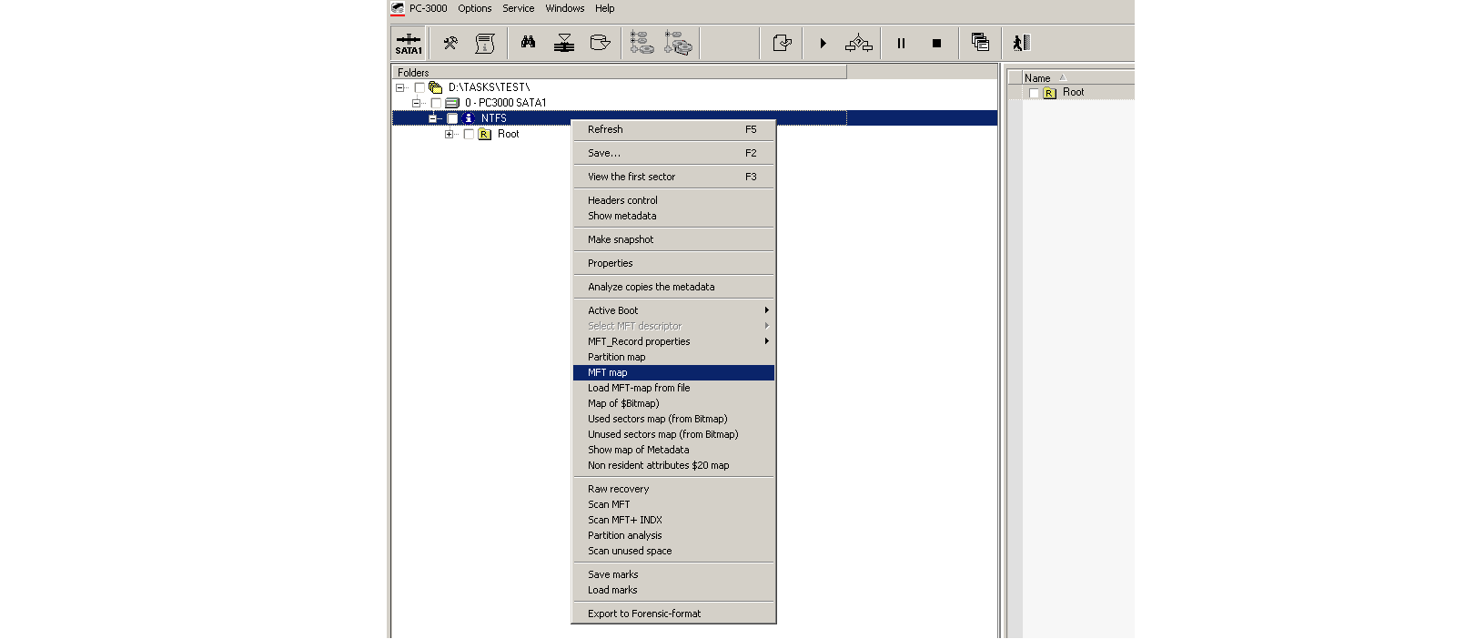

For sure, PC-3000 can calculate hash for any map, whole drive or any LBA range.
I think it's useless to make a map of whole drive because it may take a lot of time (software must read all sectors).
It's much more wisely to calculate hash of all filesystem metadata.
Below are some screenshots that can guide you

yes, it takes a large amount of time to calculate fot eh whole drive.
So in your pictures are you just hashing that particular data partition?
Which "filesystem metadata" are you suggesting?
