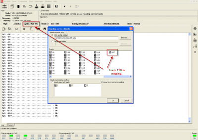

Has anybody else been experiencing that there is a bug in the WD Marvell utility, in that when saving the tracks using "Read tracks" command, the last track is not showing in the list of all tracks?
See attached picture.

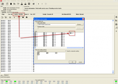

I think that happens because tracks start their numbers from 0th track.

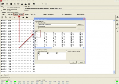

Not so sure. Please, check yourself on ROYL drives for example.
Here is another instance, two pictures of the same drive's tracks:
