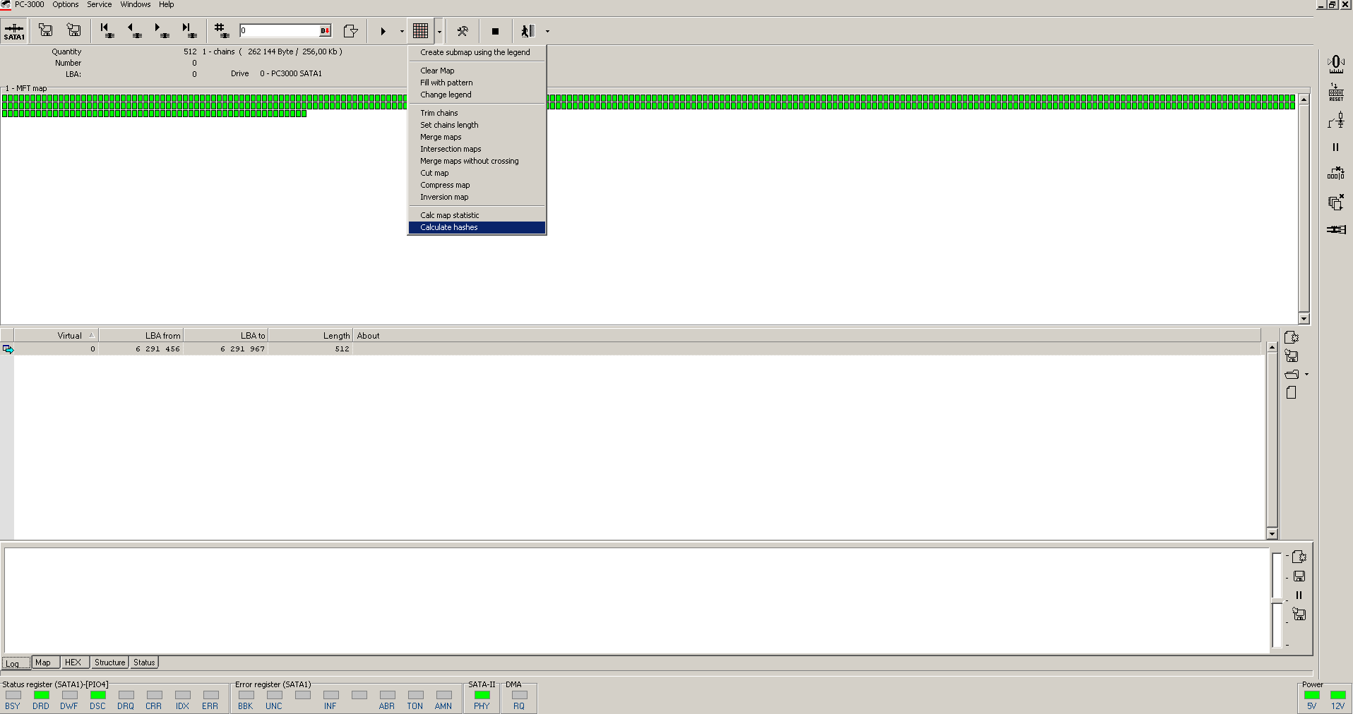

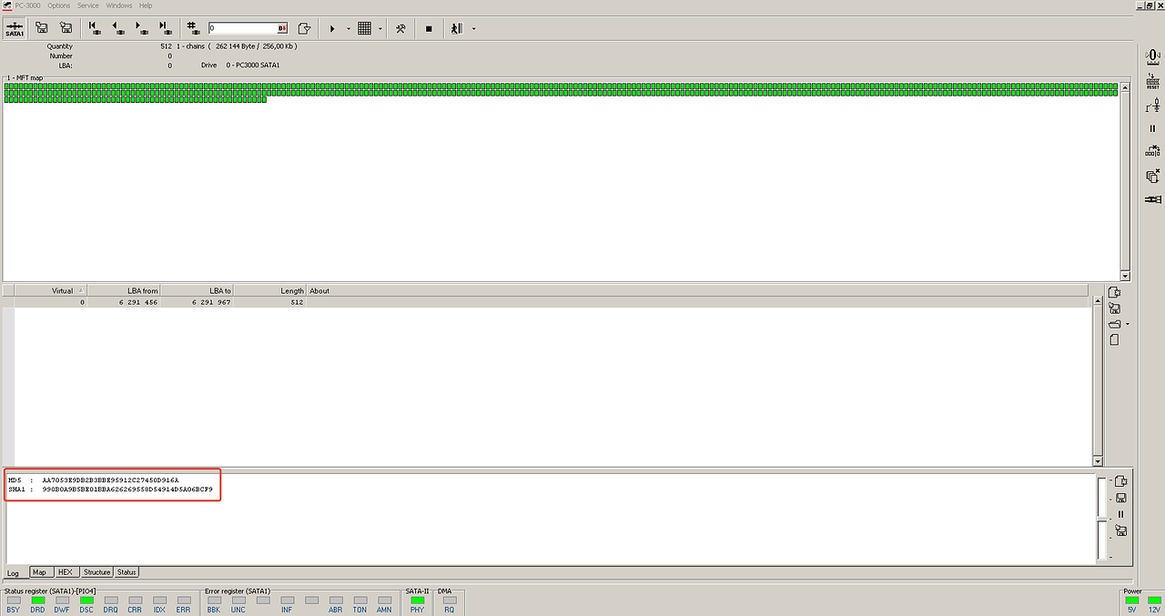

For sure, PC-3000 can calculate hash for any map, whole drive or any LBA range.
I think it's useless to make a map of whole drive because it may take a lot of time (software must read all sectors).
It's much more wisely to calculate hash of all filesystem metadata.
Below are some screenshots that can guide you

So in your pictures are you just hashing that particular data partition?
Which "filesystem metadata" are you suggesting?
