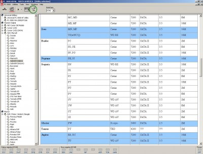

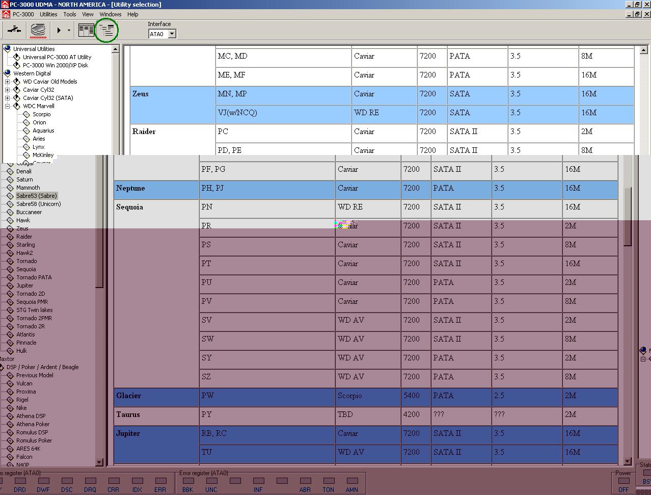

Actually all information about drive's families is locaded in "HDD Refrence" function.(see screenshot 1.jpg)

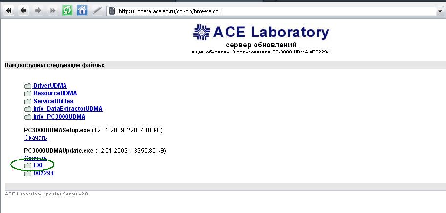

To make it available you have to download and install files from EXE folder inside your update box. (see screenshot 2.jpg)
This function works only with version 3.49 or higher.
