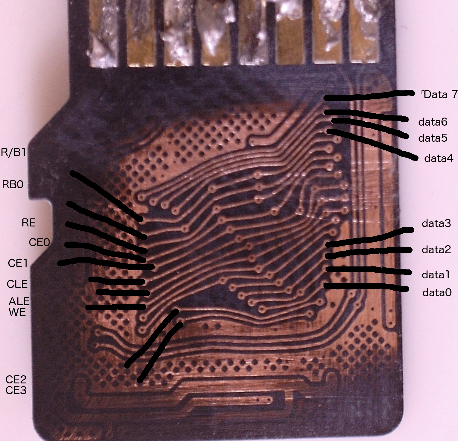

Postby lka124 » 23.02.18, 10:40
Does anybody know the pinout for this card ?
jerema
Posts: 75
Joined: 19.10.16
Reputation: 3 / (26)
Re: Fujifilm 32GB Micro-SD Card
Postby jerema » 23.02.18, 23:26
try this config.

Did you try it with undervoltig, maybee the controllership is damage ?

yes, i tryd it
