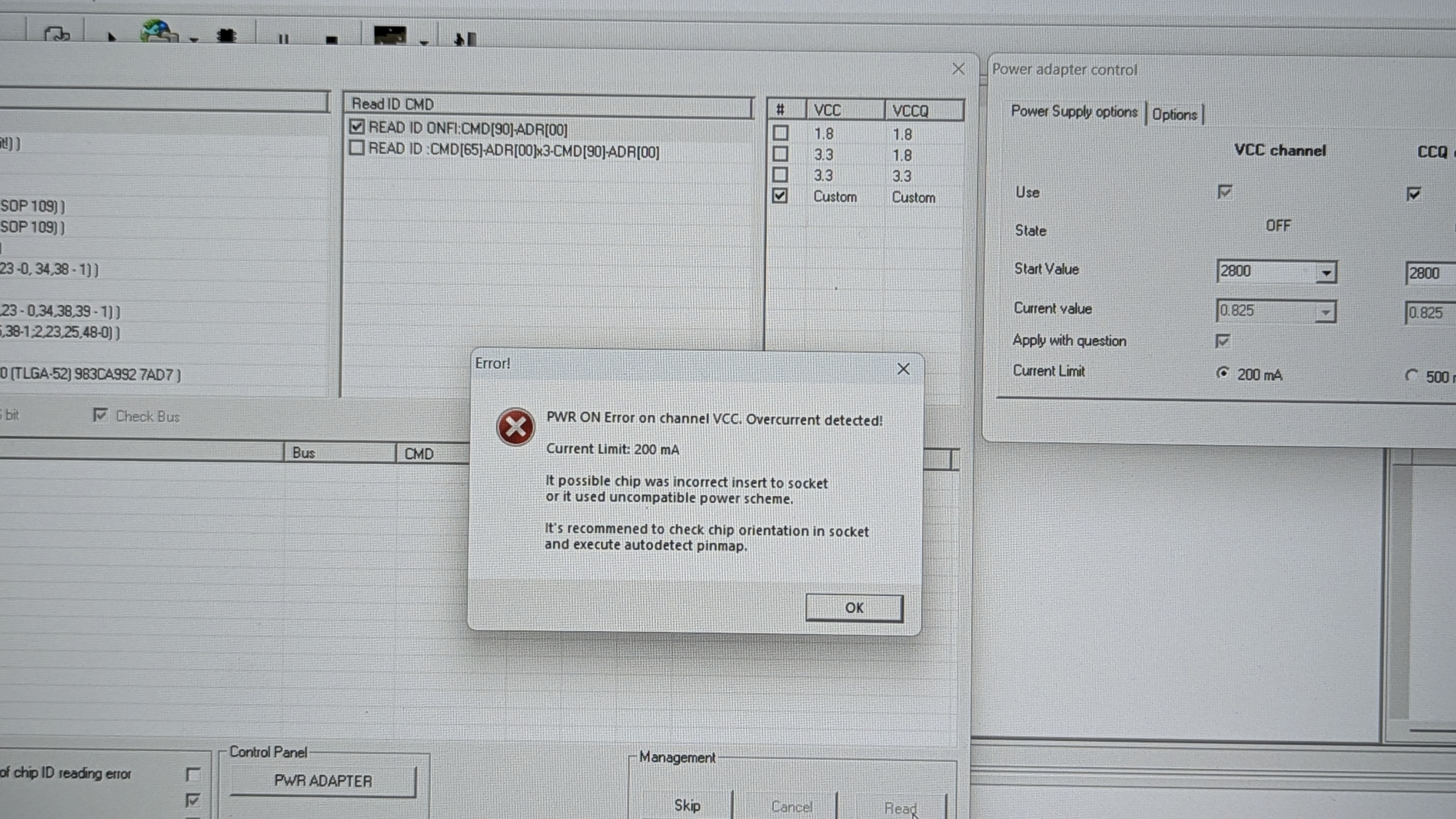

I have a microsd Card Type 1

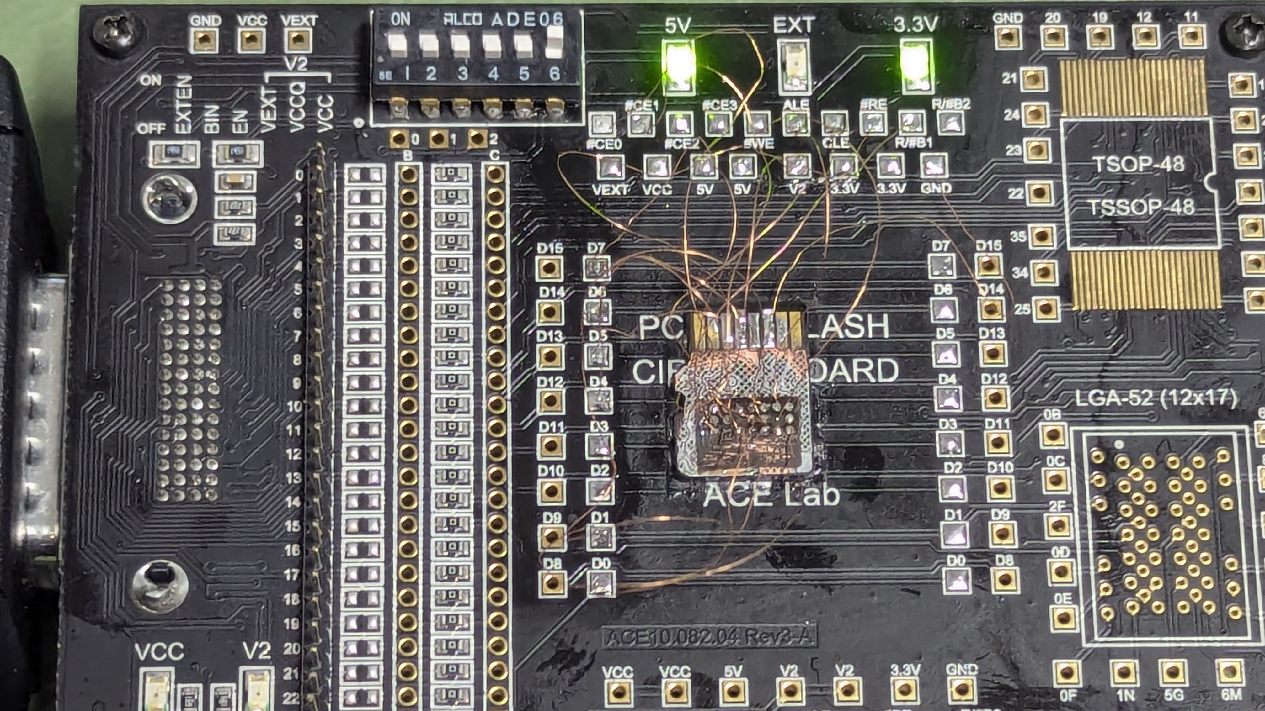

I soldered it on the circuit board as done on the description.

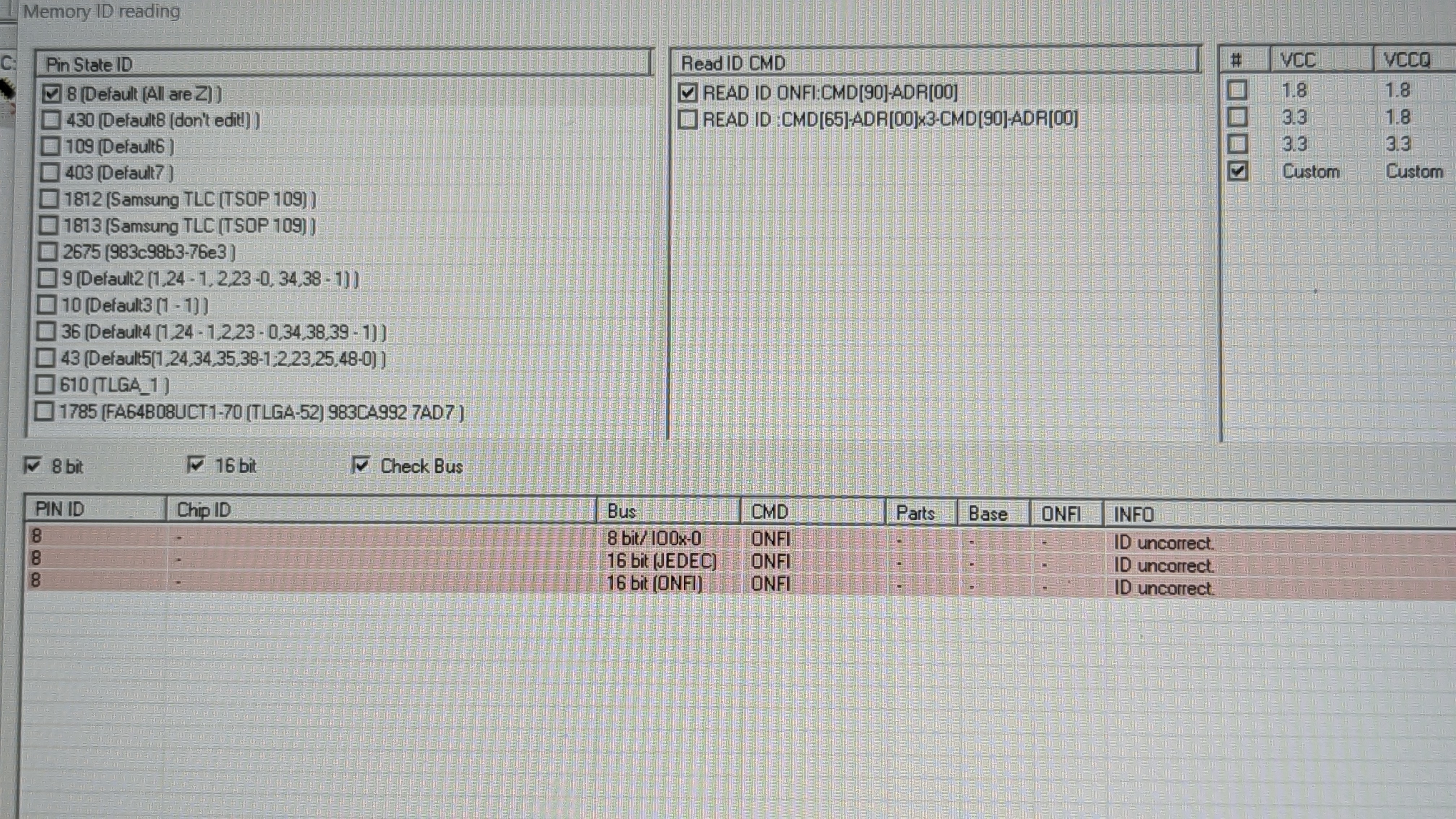

But I am not possible to read the chip ID correctly.
Is there a solution for this problem?

Most probably soldering is bad and you have some shortage. Check it with multimeter.
