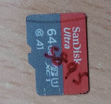

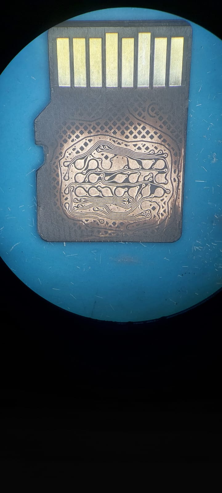

i have sandisk ultra 64gb micro sd dead i have think which layout is matches 1,4,5 any one pls suggest me ...

Sandisk are always using mSD Type 1:
http://www.pc3000flash.com/solbase/mono ... 4&lang=eng
