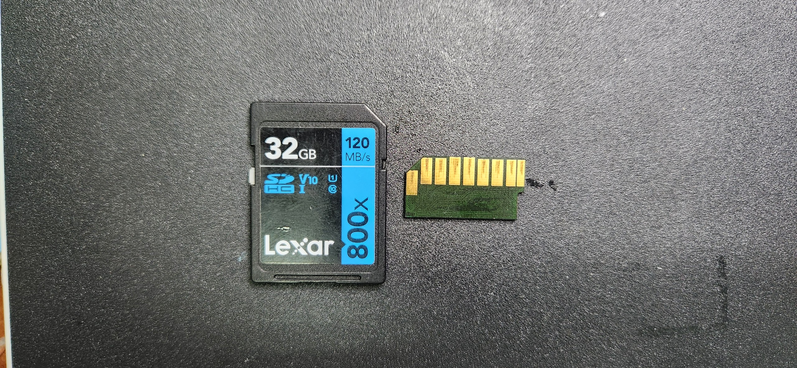

Can someone check their data base for this particular SD card from Lexar?? SD Lexar 32Gb 800x 120mb/s
Is the card Recoverable??
OR the card has LDPC and ECC?? :( :( :(
Some pics

We've developed a pinout for this unit, but it has dynamic SM XOR.
Re: SD Lexar 32Gb 800x 120mb/s Help
Postby Roman_TS » 27.03.23, 09:56
We could try to research the dump. Probably it would be possible to extract the dynamic XOR pattern.
