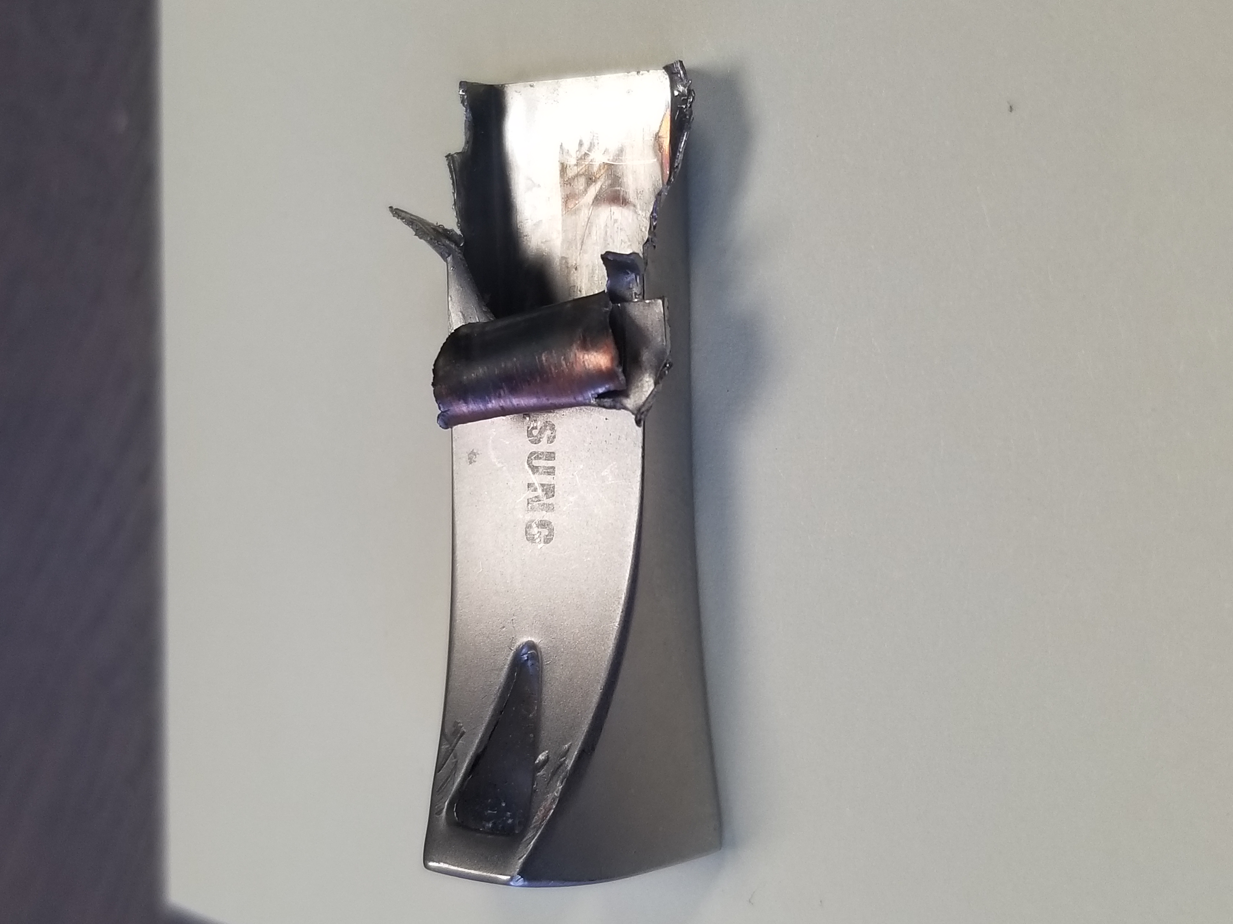

Received one and it it's almost completely encapsulated with a one piece metal casing with only the opening at the front.
Anyone have any luck getting it out of the casing to start the job?

They are just glued in, so if you are lucky you can heat up the enclosure and pry it out being careful not to damage the chip.
If you get a particularly stubborn one, you can open up the sides with a fine pair of snips and peel it back like a can of sardines until you get to the chip.

Nice. I figured heat was involved but I couldnt find gaps from the front to start safely lifting the chip.
I was also thinking to chop the back side wide open, heat it and then start lift from both sides, but the way you did it looks like it works.
Hopefully you recovered it.
Thanks for your input.

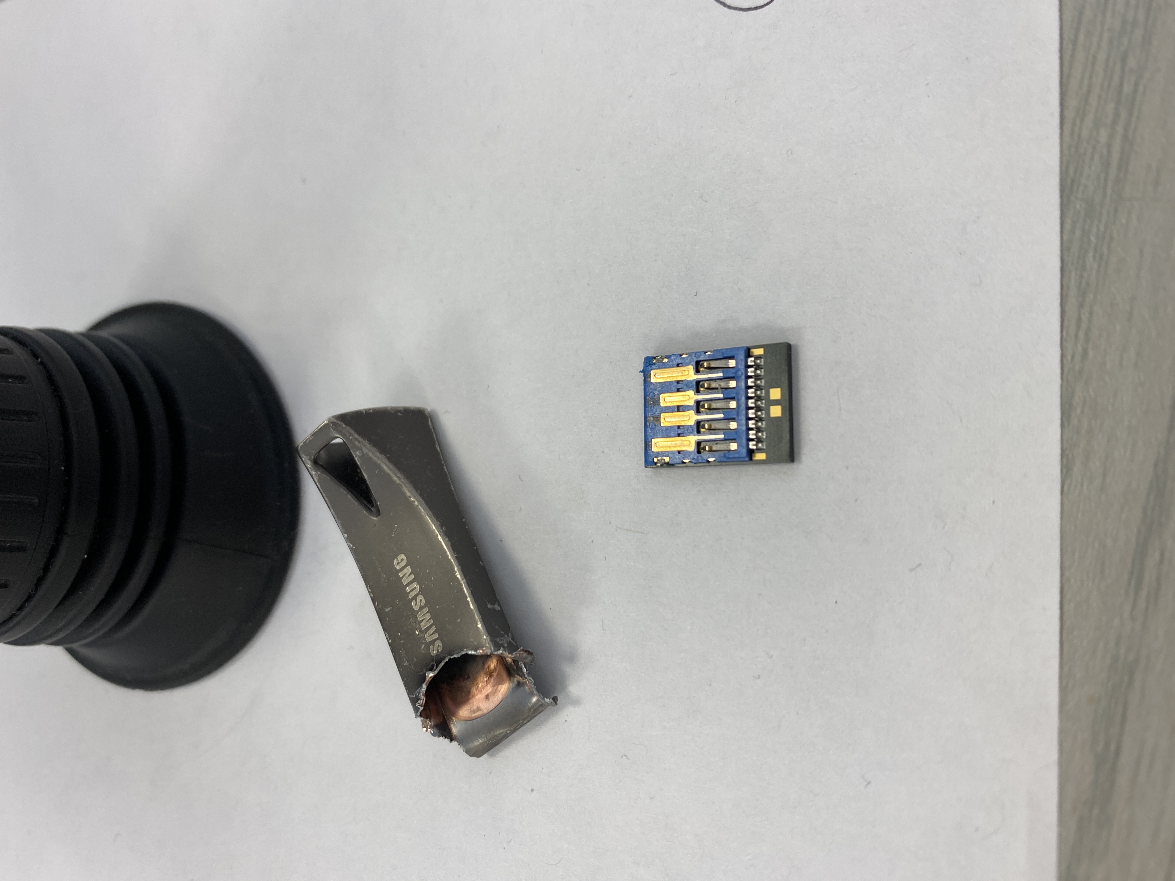

Small little thing.
I've only seen one like this once before. I assume the blue USB interface/adapter has to be removed?
Can this be connected with Ace Labs standards adaptors?

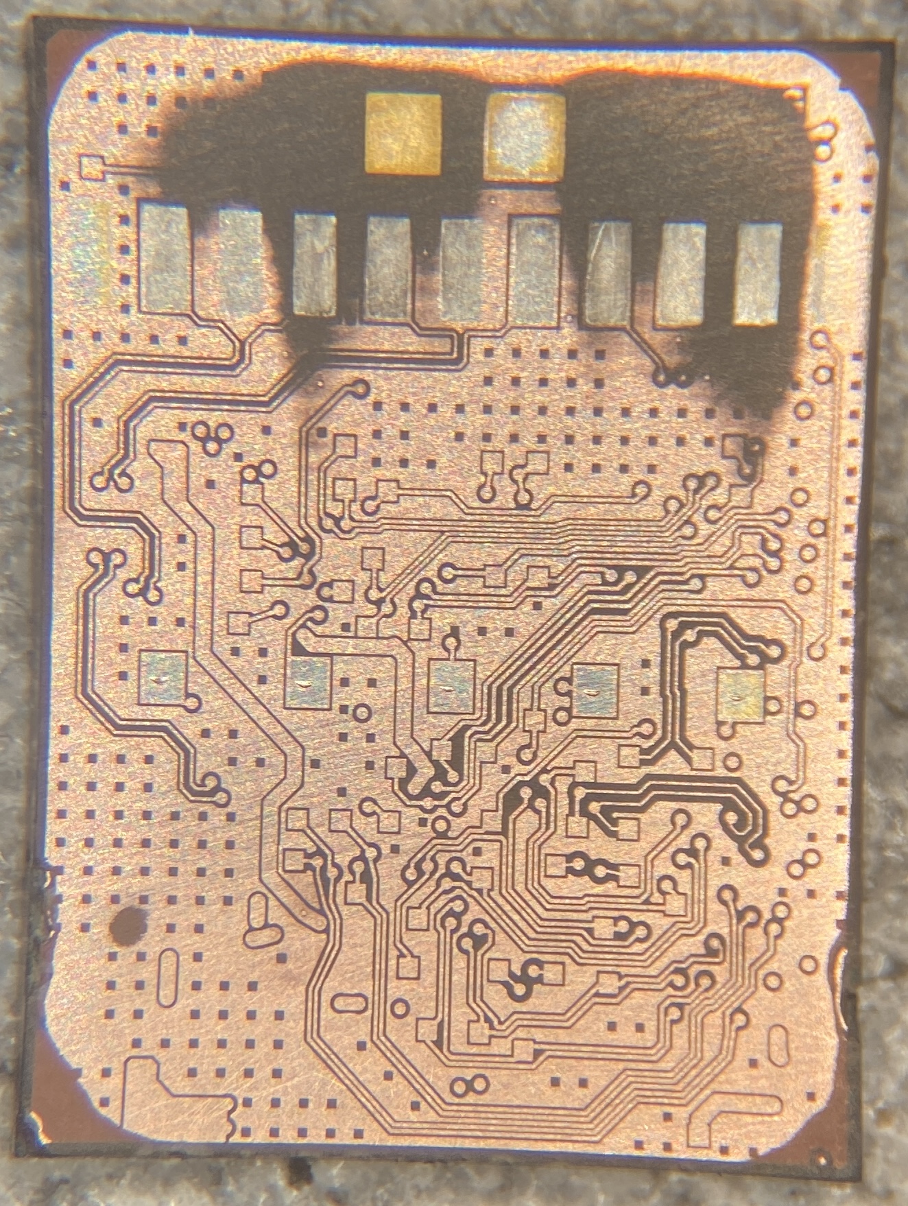

If chip looks like above:
ID: ec 1e 98 3f
or
ID, ec 1e 98 bf
then it will be SM3280 - not encrypted, standard BCH

Is the CPU inside this one SM5280? Seems to match the first one.
