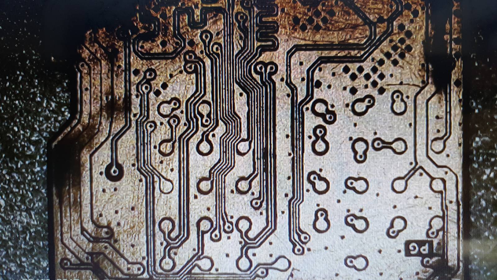

Hello guys,
I need help identifying the pinout of a SanDisk Ultra 32GB [2257TX514033].
Since I am new to physical data recovery I would be appreciated to know common sources where to find such pinouts beside the PC3000 Solutions Center.
Much thanks in advance!

MicroSD v247 from our database. Case use LDPC, chip-off is not possible for current day.
https://www.flash-killer.com/images/mon ... arvika.jpg
