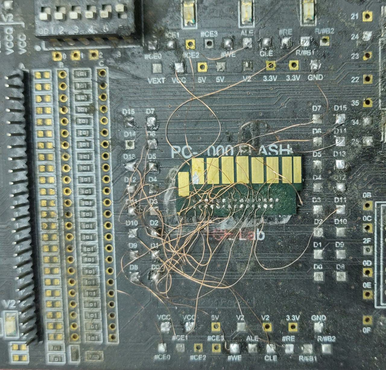

Hi,
I am stuck and could not find any diagram of this type of SD Card.
On Database i found related diagram but with 14 pin layout (A-N).
But what i have is the card with 15 pin layout (A-O). Trying to match 14 pin diagram (A-N) is shorting VCC and GRND.
I have attached pictures of chip number and also of pin diagram i have attached. As you can see here we have 15 pins in 1st line and in 2nd there are 14 pins.

Hello. Try to skip first 2 pins (one in first and one in second row) from the left part and try to solder it again. Should help.
