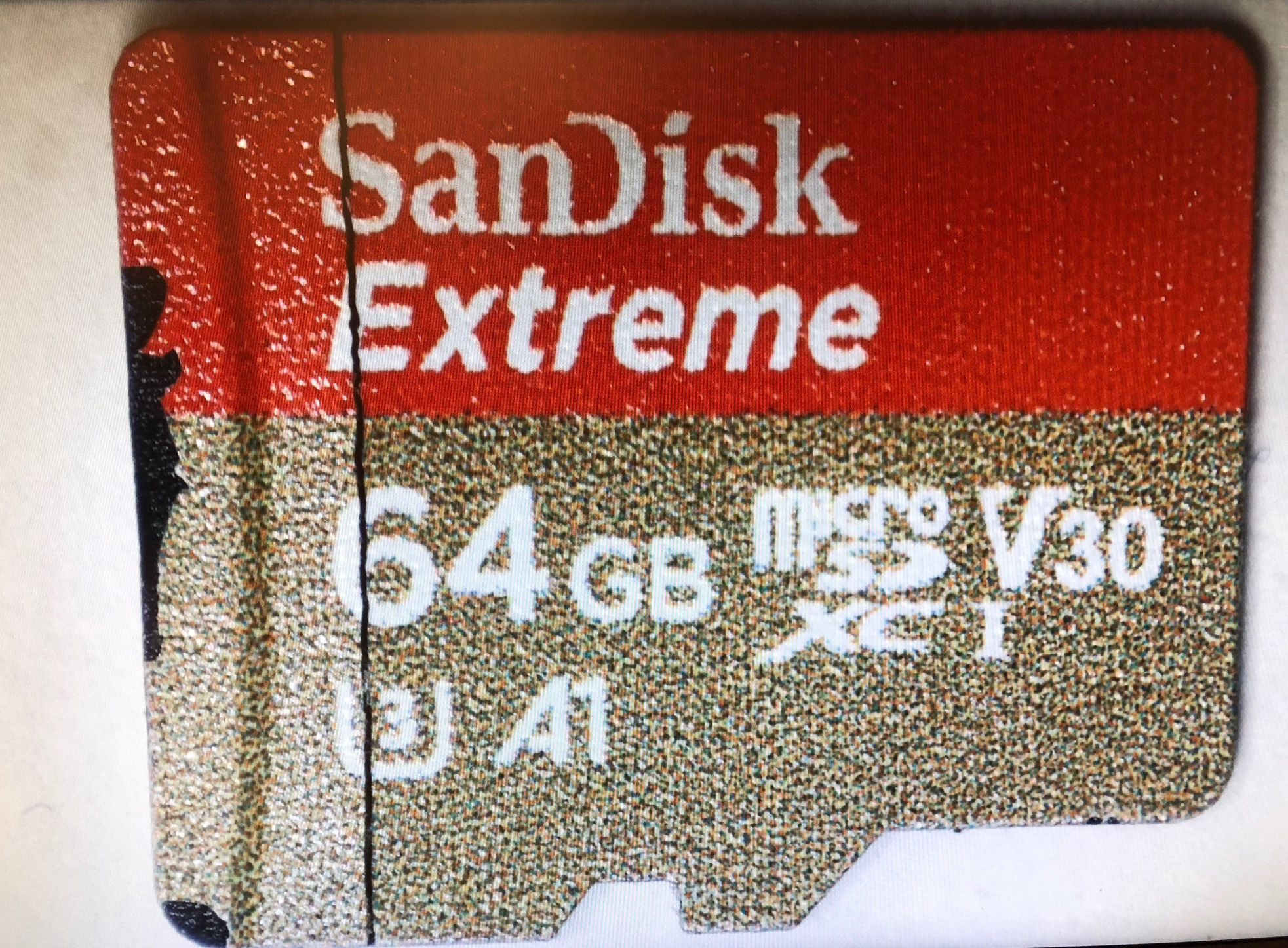

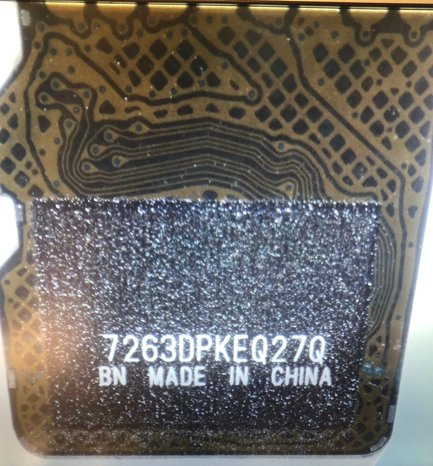

Anyone know Type and Pinout for this SanDisk Extreme card? Couldn't find it in the monolith database.
Btw.. Don't mind the crack :lol:

Remove coating and you will find standard 3 x 7 under it

Ok, thanks. I was thinking i might be some known pinout under the square field, but didn't want to start before checking..

Re: SanDisk Extreme 64GB - which type and pinout?
Postby Roman_TS » 09.08.19, 09:29
Should be recoverable, but of there are a lot of video inside - need to wait next update of PC-3000 Flash which will brings Sandisk Translator.
UPD. Sorry, I didn't saw the scratch on the picture. In this case - it's impossible to recover the chip.

I studied the crack, it goes about 80-85% into the card. But the paths on the card seems to be ok. But I'm noe sure how deep into the card the electronics goes, and how much is plastic only..
Postby arvika » 23.08.19, 23:42
Very small chance for recover. Crystal inside MicroSD cover almost all "surface" of the card. Any crack usually makes recovery impossible.
