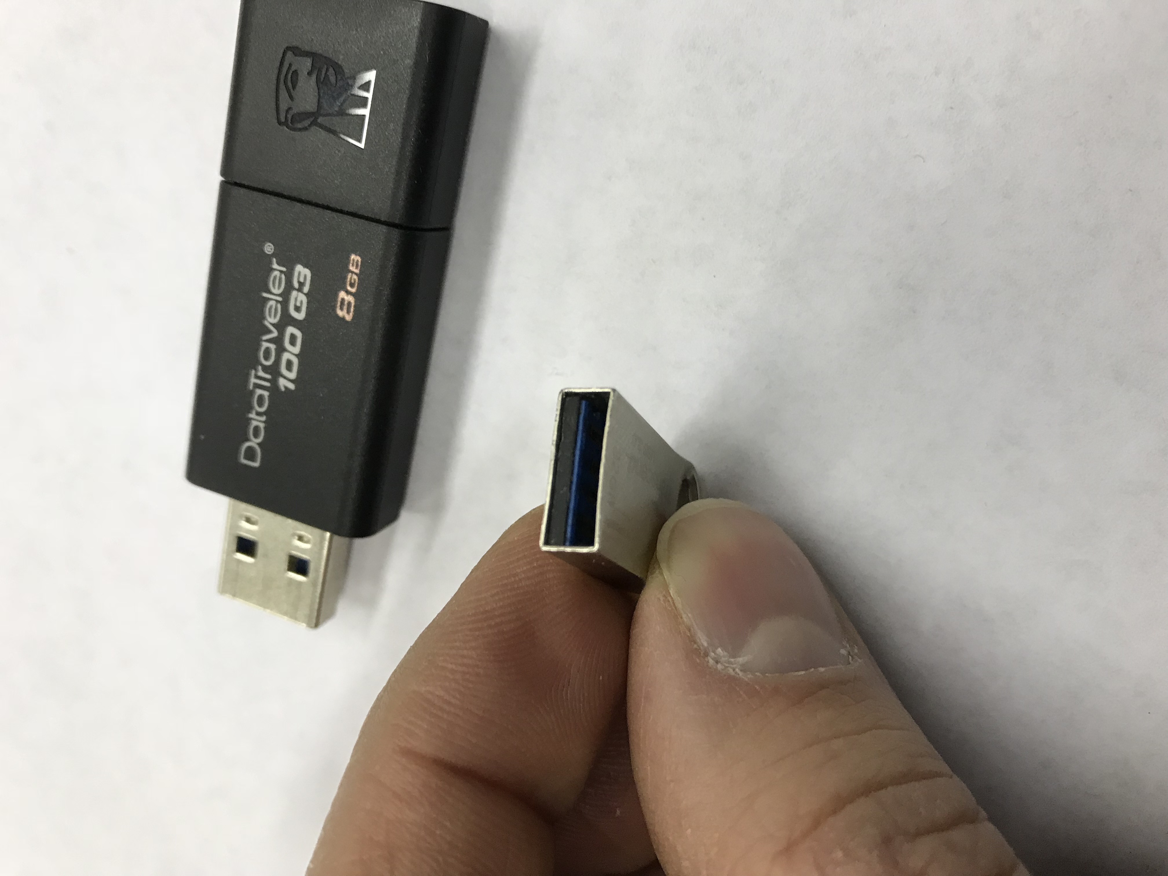

Any idea how to safely get this monolith out? It’s enclosed in metal except for the plug side.
The full size flash drive is for size reference.

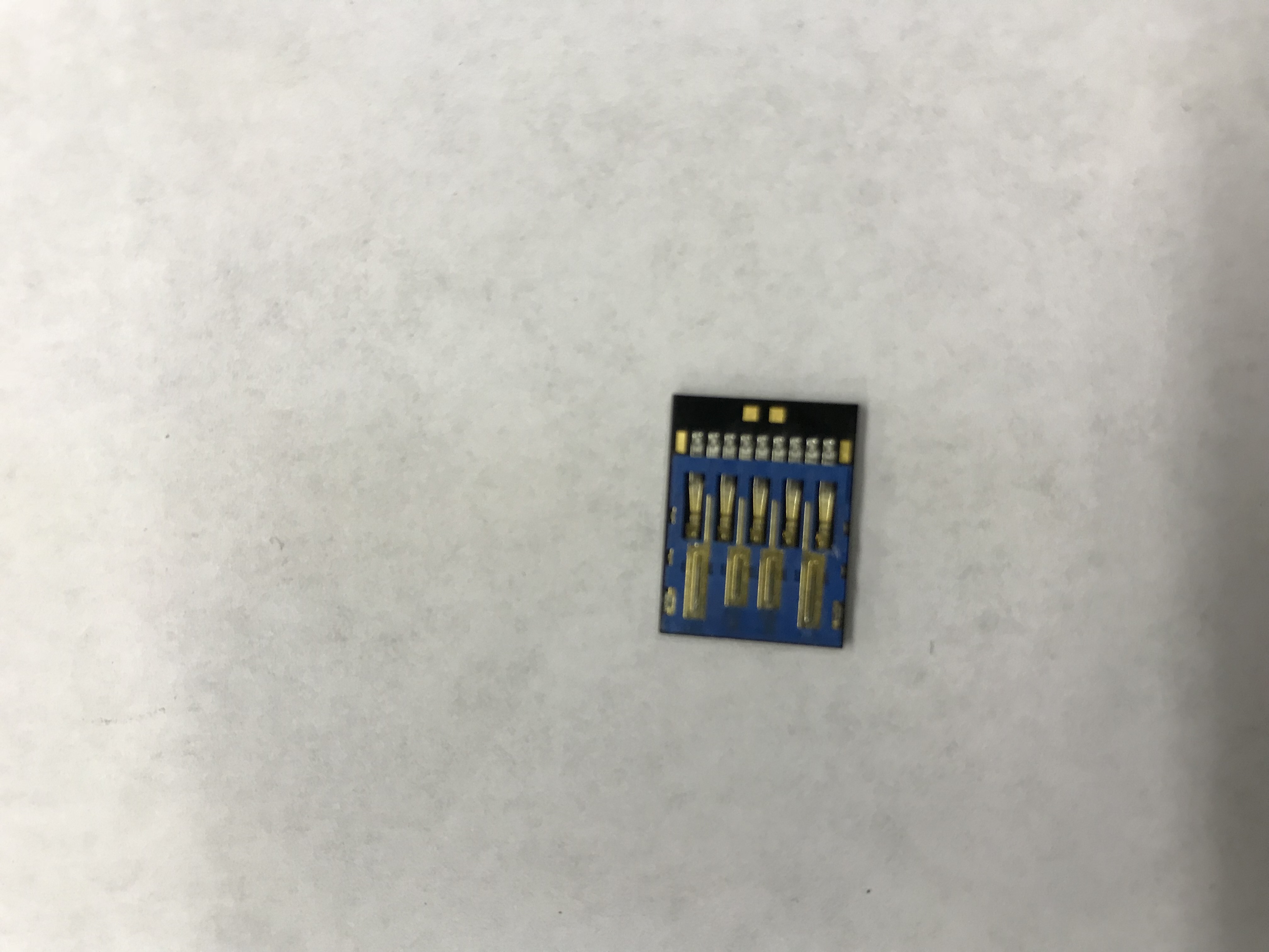

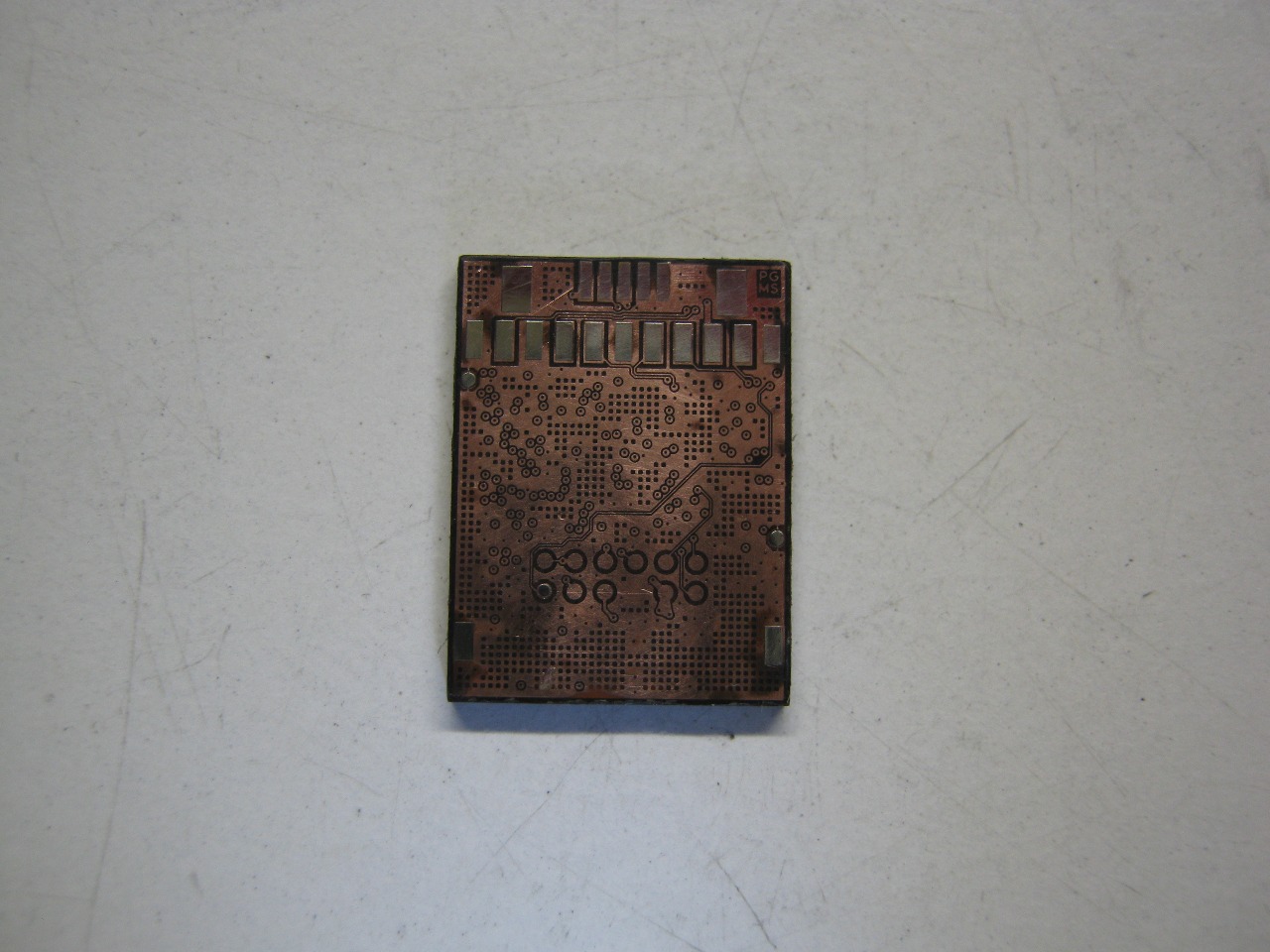

I took off the metal piece by piece .
Here’s what’s inside. It doesn’t look like the typical monolith. Do I have to remove the plastic piece with the pins? It looks like its soldered on.
Re: Tiny monolith transcend 32 GB
Postby AJ2008 » 24.01.18, 12:04
You need to remove to expose the surface which you will need to scratch to remove the top coating - then you will see tracks and from this pattern you need to determine if a pin map if available that you can use as reference to wire connection to.

Postby osity » 30.01.18, 06:41
It looks like it need to be soldered off.....

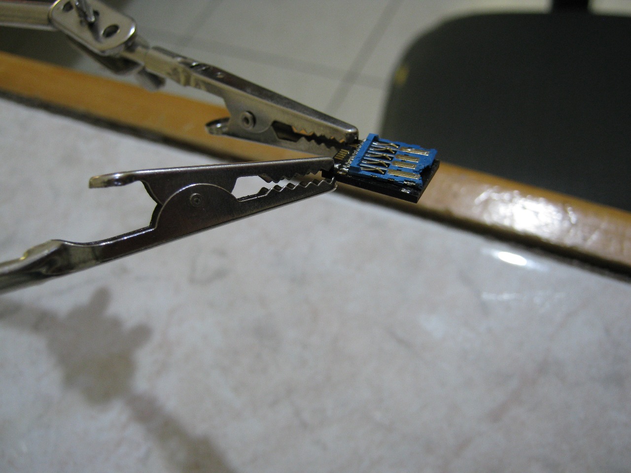

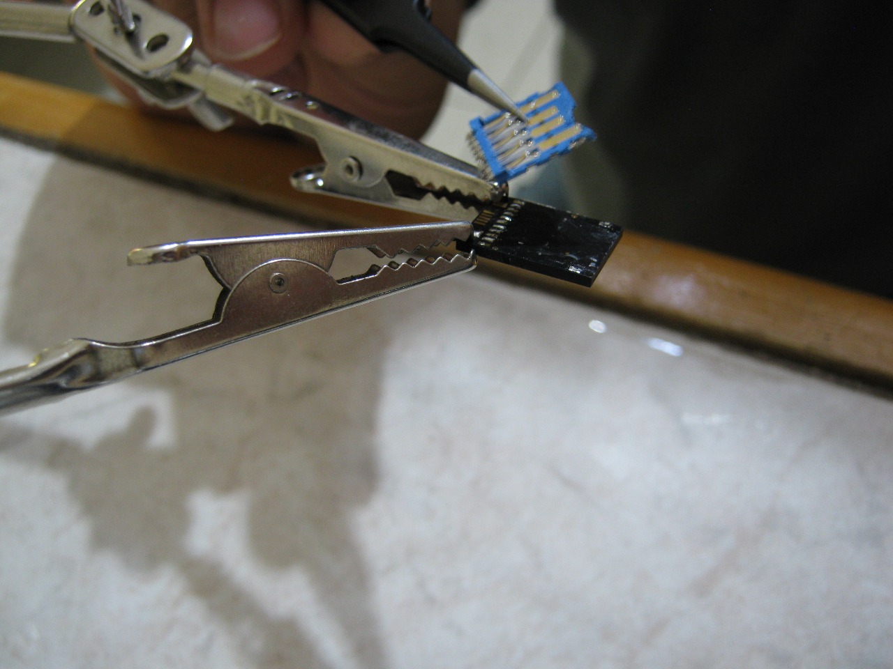

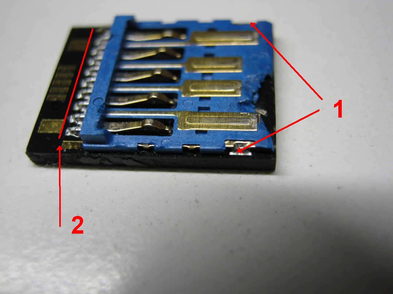

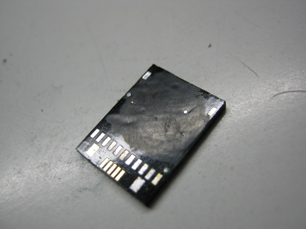

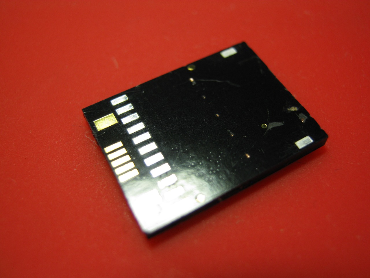

May be is litte late... I hope be usefull for you:
A. With soldering iron and helped whith a cuter knife, remove the points 1 (first picture), result second picture.
B. With hot gun remove the points labeled 2 (first picture), result 3rd picture

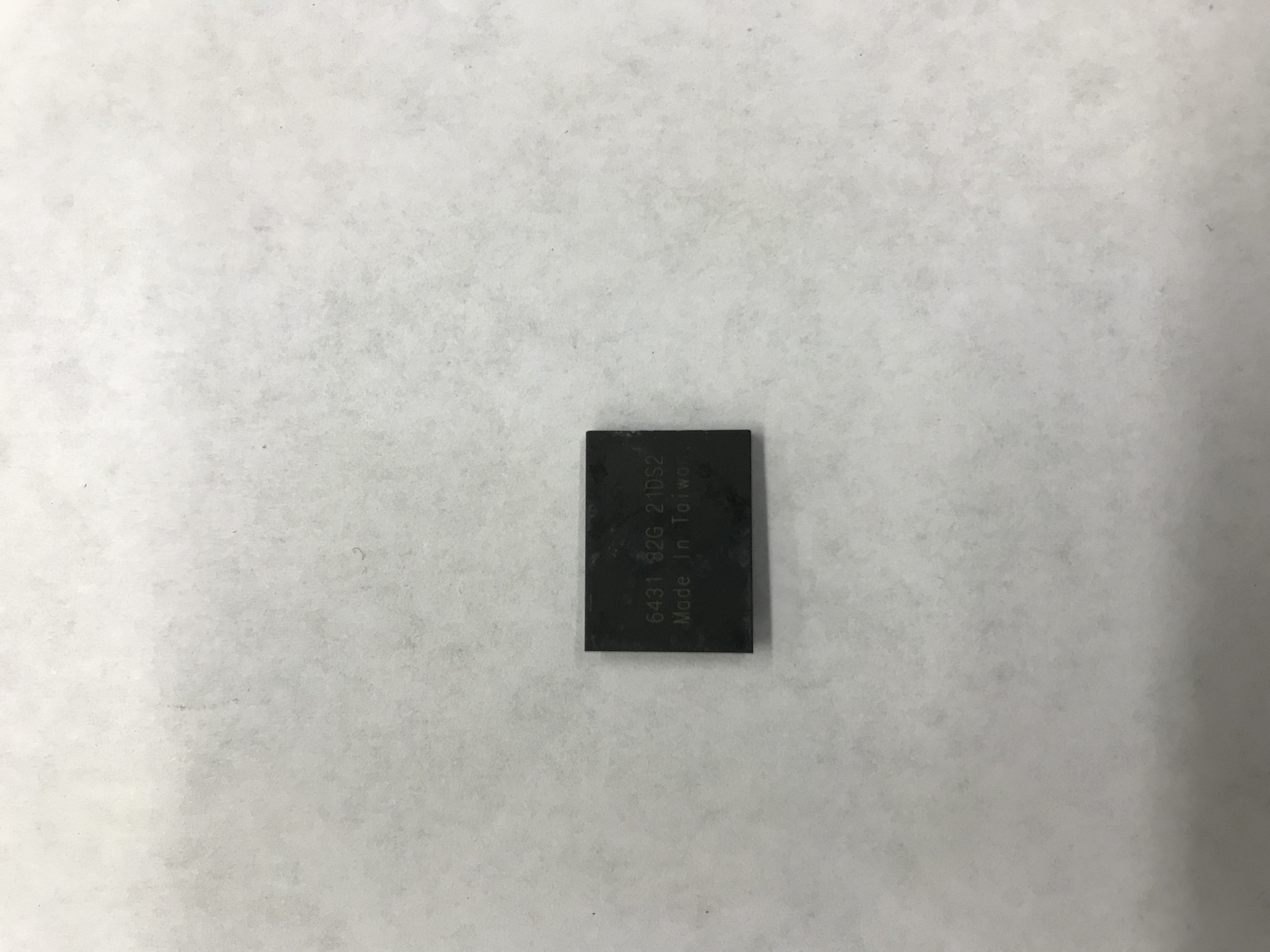

C. Remove solder and clean the monolith
D. Remove epoxy using your better procedure
E. Technological pins are exposed... now the problem is I haven't the pinout... this is a SuperSpeed (USB3.1) port that is the reason 9 pin conection.
Next step is get a logical analizer and learn to identify each pad activity.
