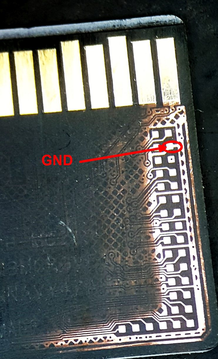

It look similar with Type 3 in AceLab DB, but i check pin 1A and 1B and they are not GND..
Any tips??
Thanks in advance

I got one typ3 , where pin 1a and 1b does not exist.
Start from below and found the VCC with Multimeter. Then you know where is pin 11a , then check if 8b, 9a,9b are ground with multimeter.

I'd bet this is GND:
If you look carefully you'll see there's a trace from that one leading to all that mesh which is usually all GND.

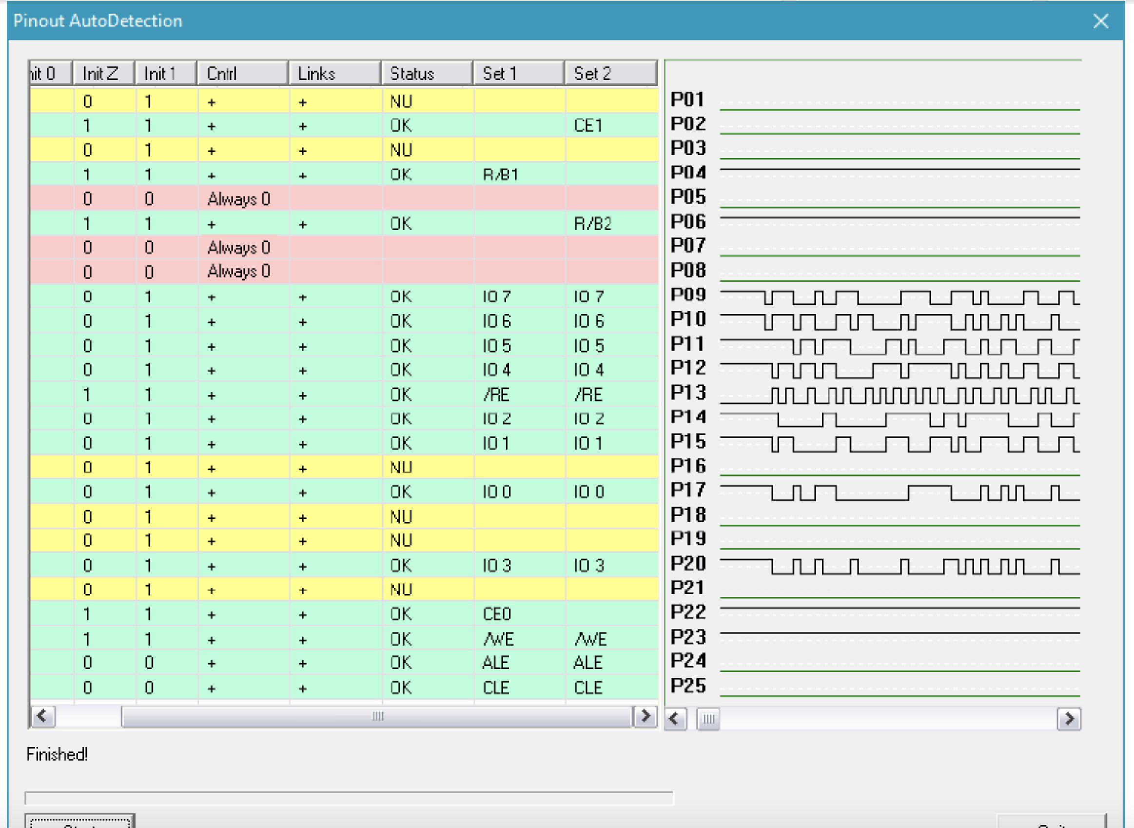

@LabGenius: SpiderBoard allows solder free connection to card but it will not allow you to find pinout. For this you need Logic Analyzer and Excel to correctly debug and assembly in correct sequence I/O lines....

With the new update, there is a option to search pinout. I tried it and it works in some case.
