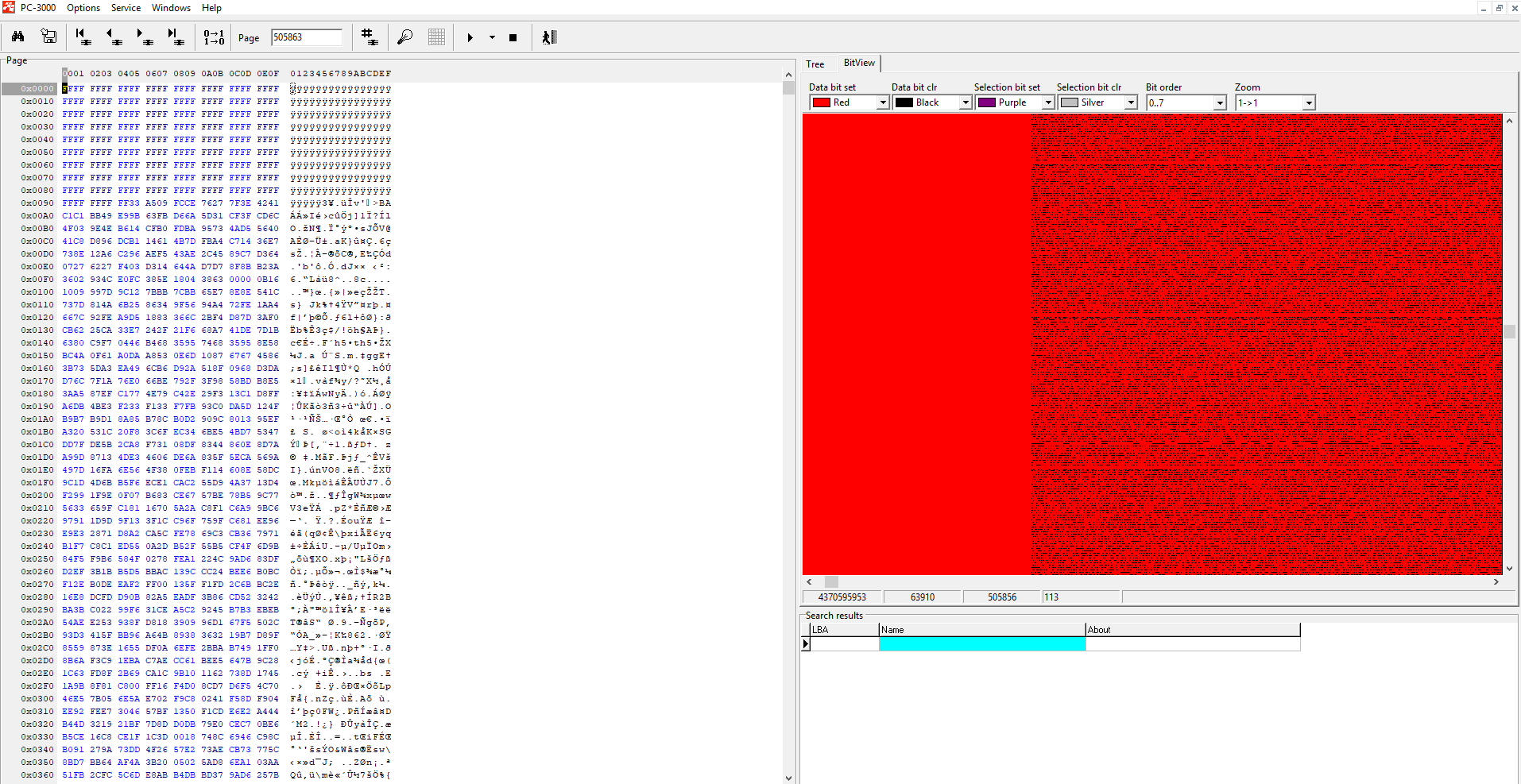

Select page designer view, and scroll to around 50% of dump then post screenshot of how it looks

Postby edbrandt » 13.02.18, 13:50
Here you are... This was read at 3.3V

I am not sure that your read is a good one, even at this new 3.3V read. The page designer view shows 'noise' that represents how data is stored, and in your case it looks 'wrong'. If the configuration of the chip is good, then the chip itself must have some errors, but in any case I think the read you have is not right.
I am not an expert in such situations, maybe there is someone here who can help more or can point out something I missed or got wrong, but for me it seems like this is not recoverable with the dumps taken already.
