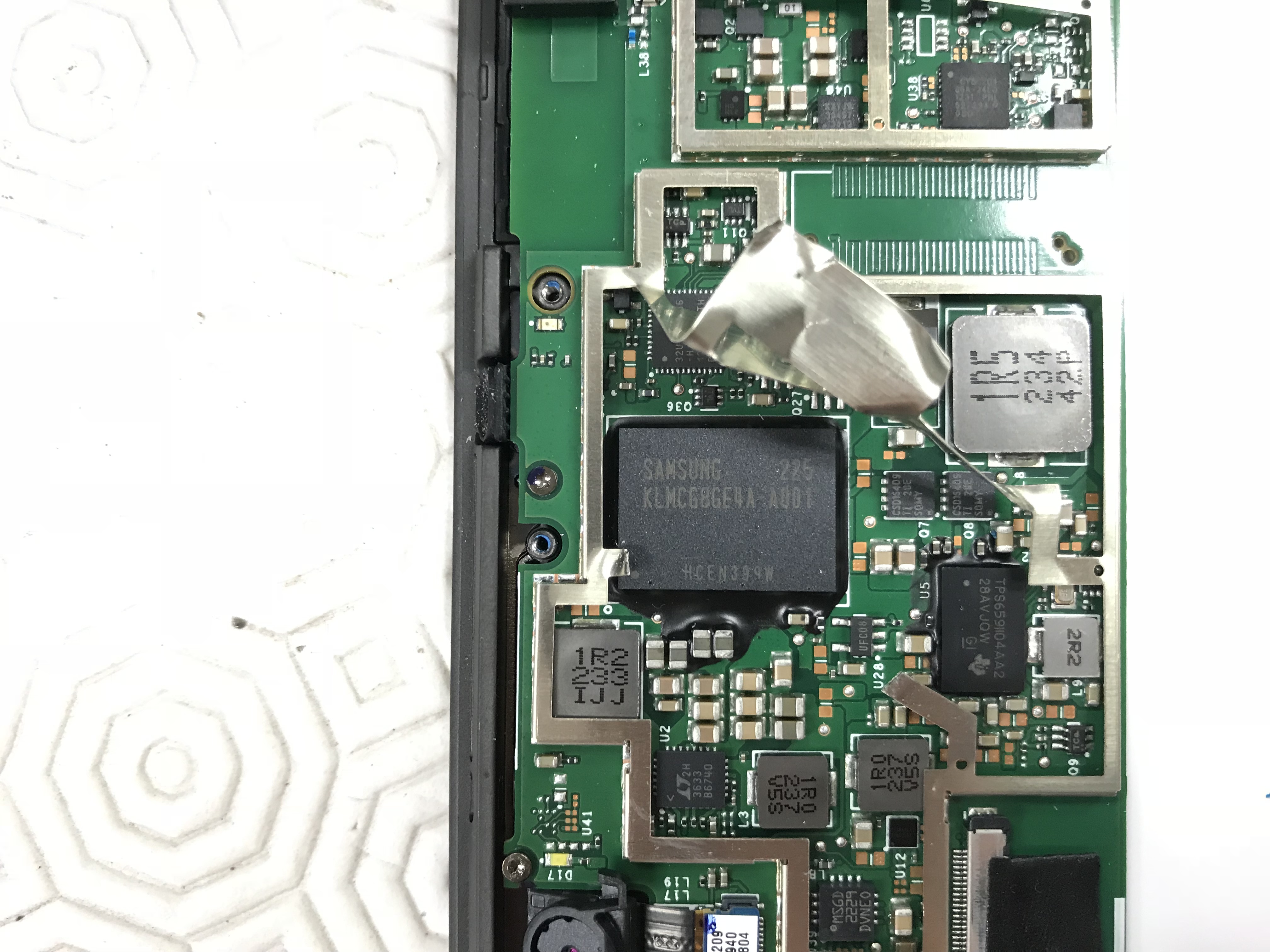

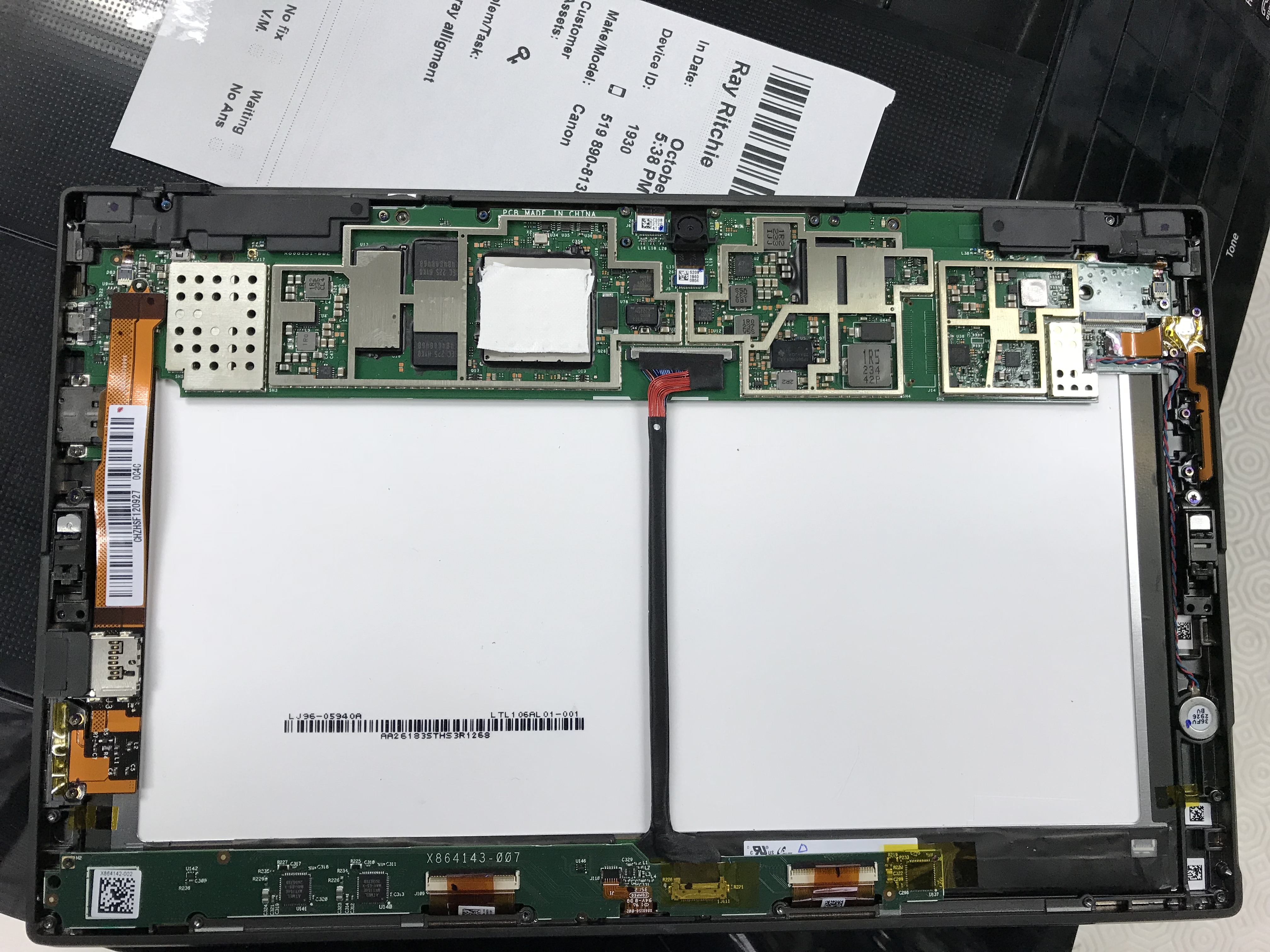

2 Pictures attached:
Is data recovery from these units possible?
It looks like the storage may be the Samsung chip that was hidden under the lower shield?

Postby DataMedics » 12.10.17, 16:20
Yes, that's the one. It's an eMMC chip.
Here's the datasheet for it: http://www.datasheetspdf.com/datasheet/ ... ?id=810339
Do you have a way to read a BGA169 eMMC?

I do not have a reader for this but I do have the PC3K flash.
I would imagine there is encryption somewhere in the dump. Data Medics, have you ever recovered a surface?
Looks like a rabbit hole
Thanks for the datasheet, I think that link is missing the /1 at the end.
Looks like this is the link to the pdf:
http://www.datasheetspdf.com/PDF/KLMCG8 ... 1/810339/1

Actually, you don't need PC-3000 Flash or any other flash recovery tool to read eMMC. If the chip is alive, you can use any of eMMC reader - there are a hundreds of Chinese versions that will help you to read this eMMC like a common SD card:

There’s no on chip encryption?

If your eMMC still working as monolith (it controller works fine), you will bypass encryption on the fly through internal CPU. Problem of encryption will appear only:
1. IF user use encryption on his device;
2. If internal CPU is damaged and you need to solder eMMC by NAND protocol.
In your case everything should work like a common SD card through card reader :)
