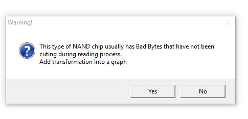

After reading a NAND I get this prompt.
What is cuting?

Hello. Please read our article about Bad Columns:
http://blog.acelab.eu.com/how-to-de ... -dump.html
This message will appear if your chip is TLC and it contain Bad Bytes. In this case, sometimes, our software can help to remove all Bad Bytes automatically during chip reading and add new string of result in transformation graph. So press on YES.
