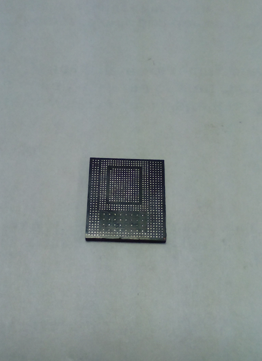

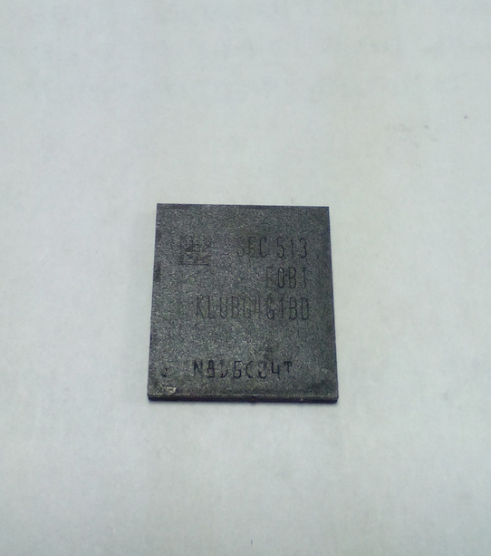

I have a NAND chip from a Samsung Galaxy S6,
The markings are
SEC513
E0B1
KLUBG4G1BD
(images attached)
The bottom connections are very unusual (images attached).
Have anyone done recovery on this type of chip before?
Does anyone know what kind of chip this is called? Seems like this is the new version of eMMC chips.
Thanks.

Postby Cableguy » 15.08.16, 16:57
This is indeed a new type of memory chip. Instead of 8-bit parallel half-duplex interface (eMMC) it has a 2-bit serial full-duplex interface (M-PHY). It is called UFS 2.0 and you can find everything about it here: http://www.samsung.com/semiconductor/pr ... orage/ufs/
Furthermore, because full disk encryption is mandatory on Android 6.0 and above it is not likely you get any readable info by commencing a chip-off and reading the chip like you did with the eMMC chips. The highest change of getting any user data is by the use of an ODIN-like approach by rooting it. Samsung will use this memory on its flagships from Galaxy S6, S7 and above. Other manufacturers are also ready to produce and implement (Toshiba, SK Hynix).
Galaxy S6 uses UFS 2.0 in a FBGA95 layout, Galaxy S7 uses UFS 2.0 in a FBGA153 layout. This FBGA153 looks exactly like the eMMC layout but contacts have different functions!
