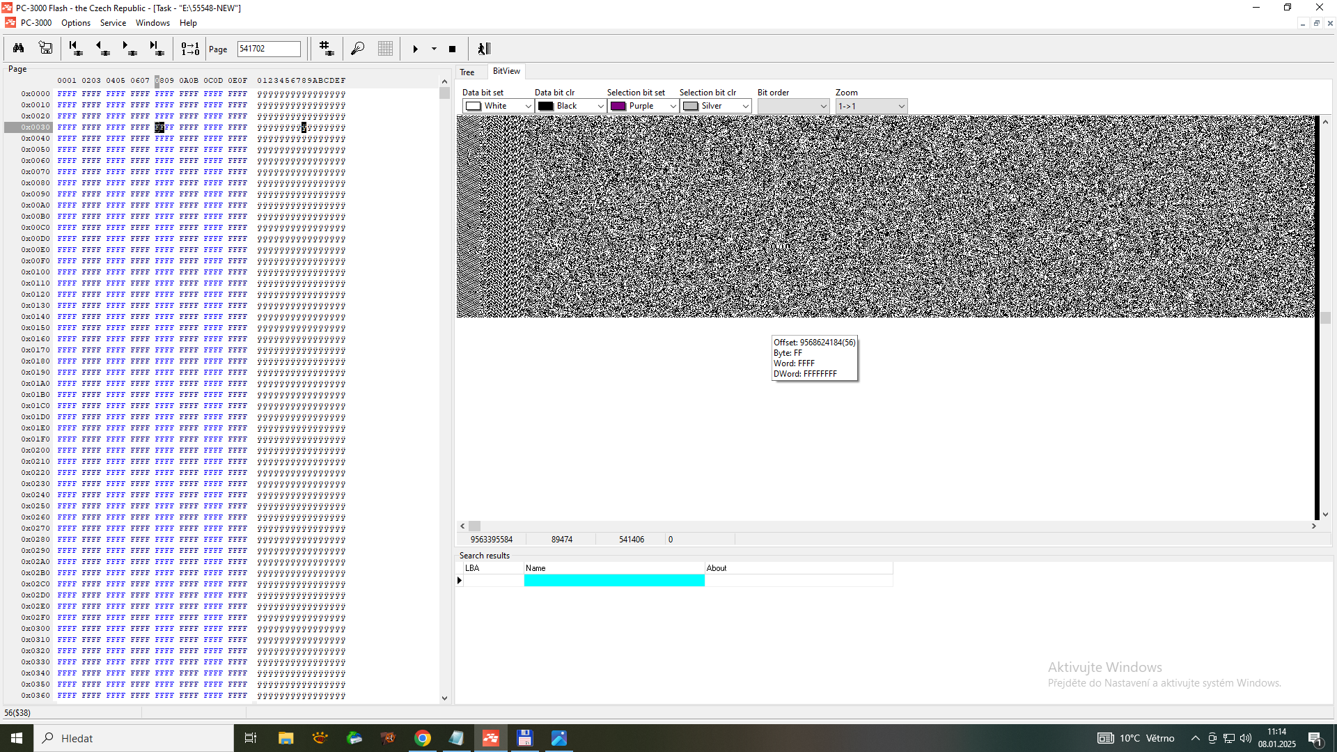

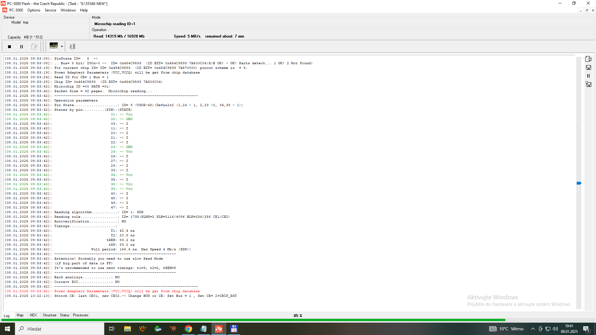

Hello, I have this microSD Sandisk extreme 16GB. Tried to read dump, but only half of dump was read. (See picture). Does it mean that chip is damaged or something should be changed in reading paramters?
Pinout: TYPE1
Thank you

Chip is not damaged. Most likely it has a specific configuration CE for LUN that require a manual adjustment. Please make a ticket in ts.acelab.eu.com, and we will guide you.
