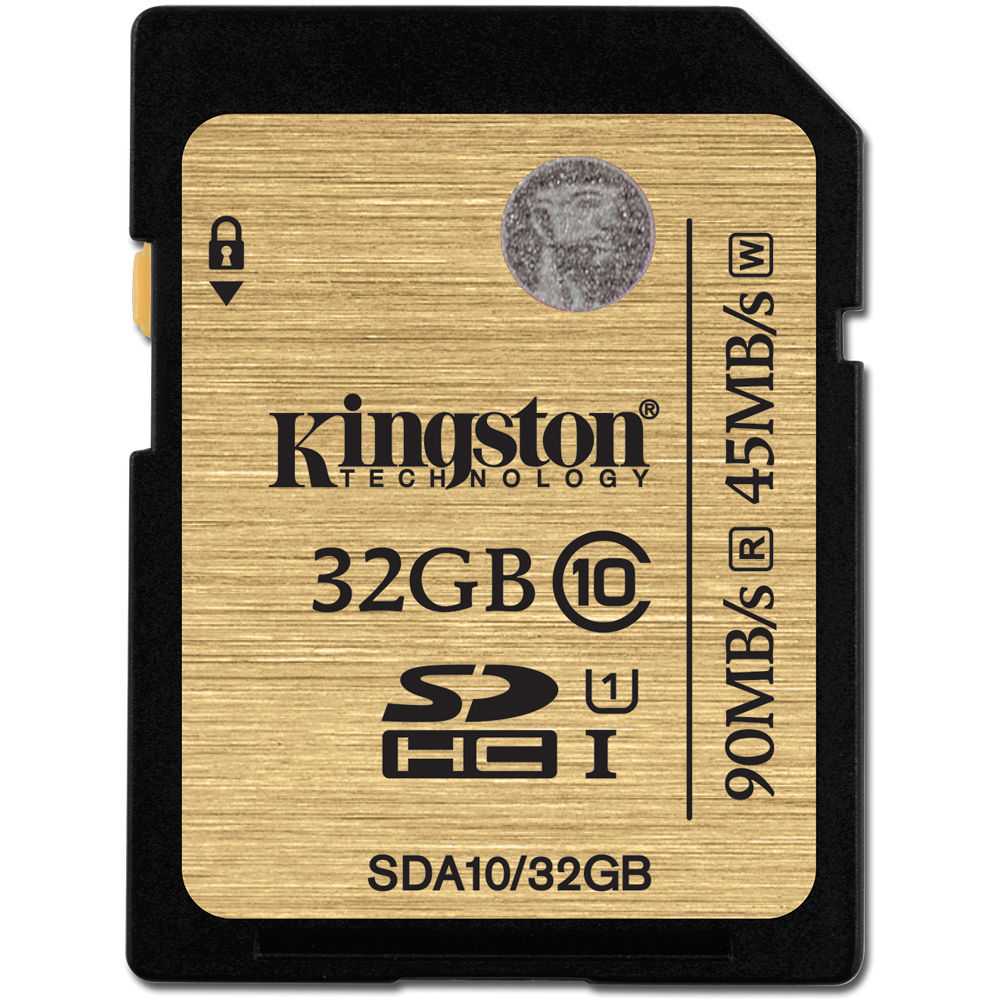

Re: Kingston SD 32Gb on PS8210-0
Postby Amarbir[CDR-Labs] » 30.04.16, 09:51
Marek wrote:Source of the post Thanks :) For Answer :)
Regards :)
Marek ,
Can You Post a Picture Please I Am Interested To See How This SD Card Looks Incase i Get It In future
Marek
Posts: 56
Joined: 01.12.15
Postby Marek » 17.05.16, 10:49
Like this
