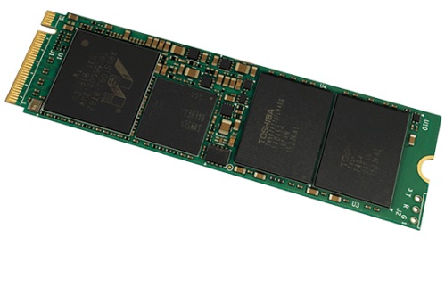

It is a SSD as I have mentioned and it has a PCIe interface, but does it plug into a PCIe slot on the motherboard? It looks like it can, but is there a new PCIe format?
Here is the description: CX2-8B512 M.2 2280 512GB NVMe MLC SSD PCIe 3.0x4
CX2-8B512 M.2 2280 512GB NVMe MLC SSD PCIe 3.0x4.jpg (6.05 KiB) Viewed 17886 times

This drive does not contain SATA controller inside CPU. You can put it to m.2 to SATA adapter, but it will not works. New generations of NVMe drive is use only PCI-E controllers, and right now it's not possible to recover it through SATA bus. The only way - use PCI-E card to your PC. You can find one on eBay, Aliexpress or in Amazon.
http://www.ebay.com/itm/PCI-E-3-0-x4-La ... SwlMFZErwi

Yes, but it would be a different device. Express, Portable and UDMA-E can work only with SATA-based devices. For PCI-E we need absolutely new device, with it's own architecture, buses and internal structure.
