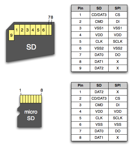

First of all let us know what BGA cover you got - 153/169, 162, 221 or 529 ? Then let us know if controller is working so you can communicate with eMMC by native controller build it - you can check this by connecting BGA to microSD and putting to your PC by blocker.
If it's not connecting then you will need to use Monolithic adapter to connect eMMC by NAND protocol and use PC3000 to find structure, parameters, XOR etc - unfortunelly before this you will need to get same eMMC and use Logic Analyser to find pinout similar as it's described in Blog for Monolith - nobody unfortunelly share eMMC NAND protocol pinouts
Attached SD card pinout

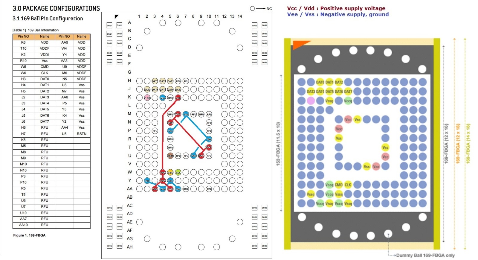

You CAN work with eMMC and with Spider Board. The question is - are you really want to use more complex way?
eMMC chips are not required any special equipment - it is just an SD card in BGA package. Much more easy to use q third-party adapters for their reading. It's cheaper, easy and convenient if you are dealing with Smartphones recovery.
Don't forget that PC-3000 Flash is a perfect tool for data recovery from Storage Devices, like UFD, digital cards, monolith. eMMC - is additional branch from mobile phones, and of course you can use Spider for recovery, but it's just additional feature, not main. So - why not to use special adapters, if you want to deal with eMMC very often?
By the way - here is the picture for eMMC reading through Spider Board. Needles should be setted as on the picture - several for VCC, a couple for VCCq and GND.
And don't forget - during task creation, you need to chose CARD ADAPTER functionality, not a common PC-3000 Flash.
You need to set the following needles:
1. Command line - CLK, CMD, DAT0
2. Power Supply - VCC (red VDD);
3. GND (blue VSS);
3. GND (blue VSS);
