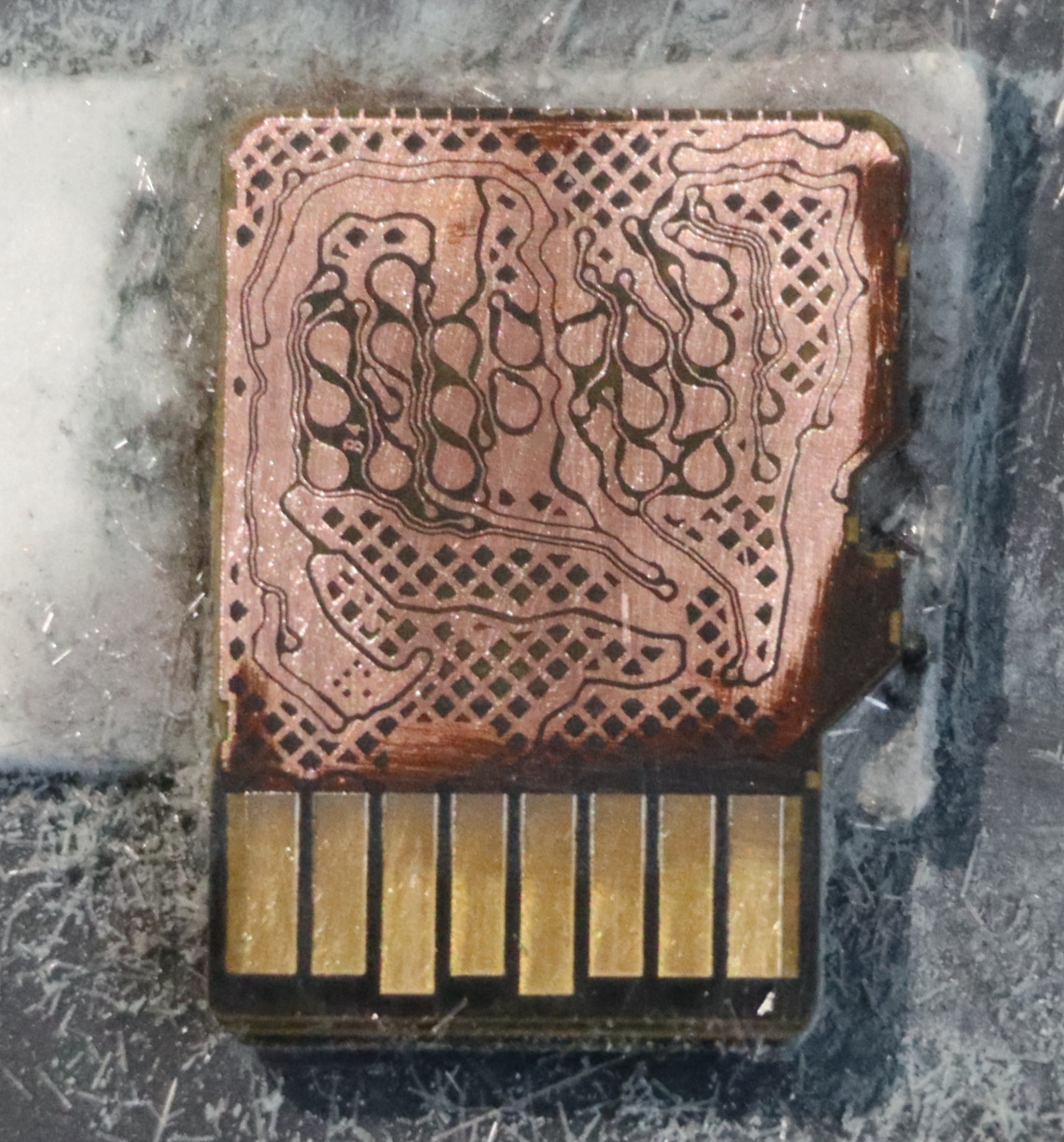

Hello everyone,
This is my first case for monolith data recovery.
My friend with the drone said that it overheated when plugged into the PC. He went to another data recovery company, and they said the card was shorted and couldn't do anything about it.
I want to try to do a pinout data recovery with the spiderboard.
It also has a B4 mark on it, which I believe is funny. I don't know what it means.
Any advice is very welcomed
Thank you

Did you check if it is really shorted? If it is, you won't recover it.

This case use LDPC. Chip-off is not possible here for current day.
