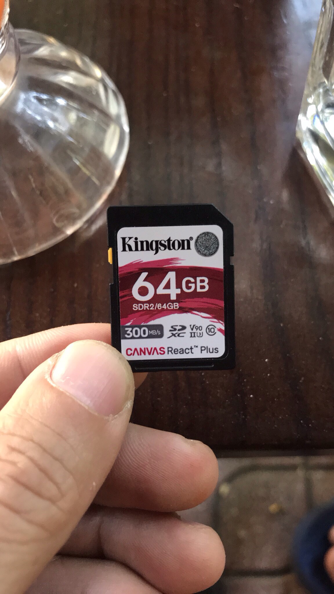

Postby gameboybin » 17.10.22, 10:58
Is this recoverable???
Do we have pins out for this

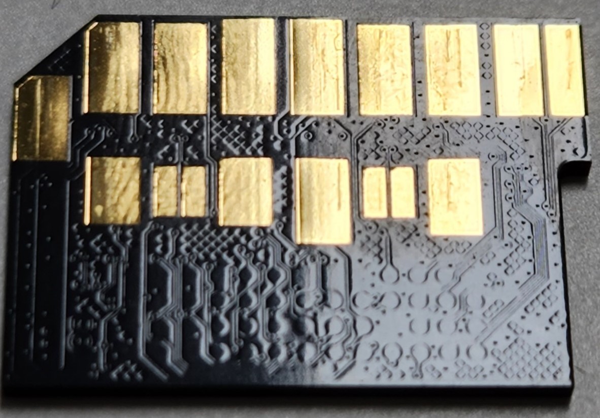

Extract monolith from case and show the photo.
Re: Kingston CANVAS React Plus 64GB
Postby gameboybin » 18.10.22, 03:34
arvika wrote:Source of the post Extract monolith from case and show the photo.
Here it is :wave: :wave:
Postby arvika » 20.10.22, 23:59
Similar to: http://odzyskiwanie-danych.com.pl/image ... arvika.jpg I do not have 100% same case. So hard to tell if is recoverable or not. Need read dumps and check what is inside.

Postby gameboybin » 11.11.22, 09:16
arvika wrote:Source of the post Similar to: http://odzyskiwanie-danych.com.pl/image ... arvika.jpg I do not have 100% same case. So hard to tell if is recoverable or not. Need read dumps and check what is inside.
Wait, how can you Read Dumps if you don't know the pinnouts to connect the monolith to PC3000 Flash??
Postby northwind » 14.11.22, 10:18
he will discover pinout, he's good at that :)
Postby arvika » 04.12.22, 11:21
This cards use sector 4568_4632. Its LDPC... :(, possible encryption also.
