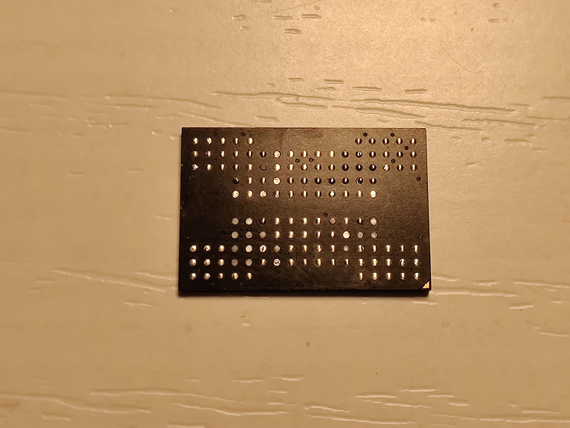

Hello, we received a USB pendrive with no markings at all.
The controller is SM3281L and I know is supported.

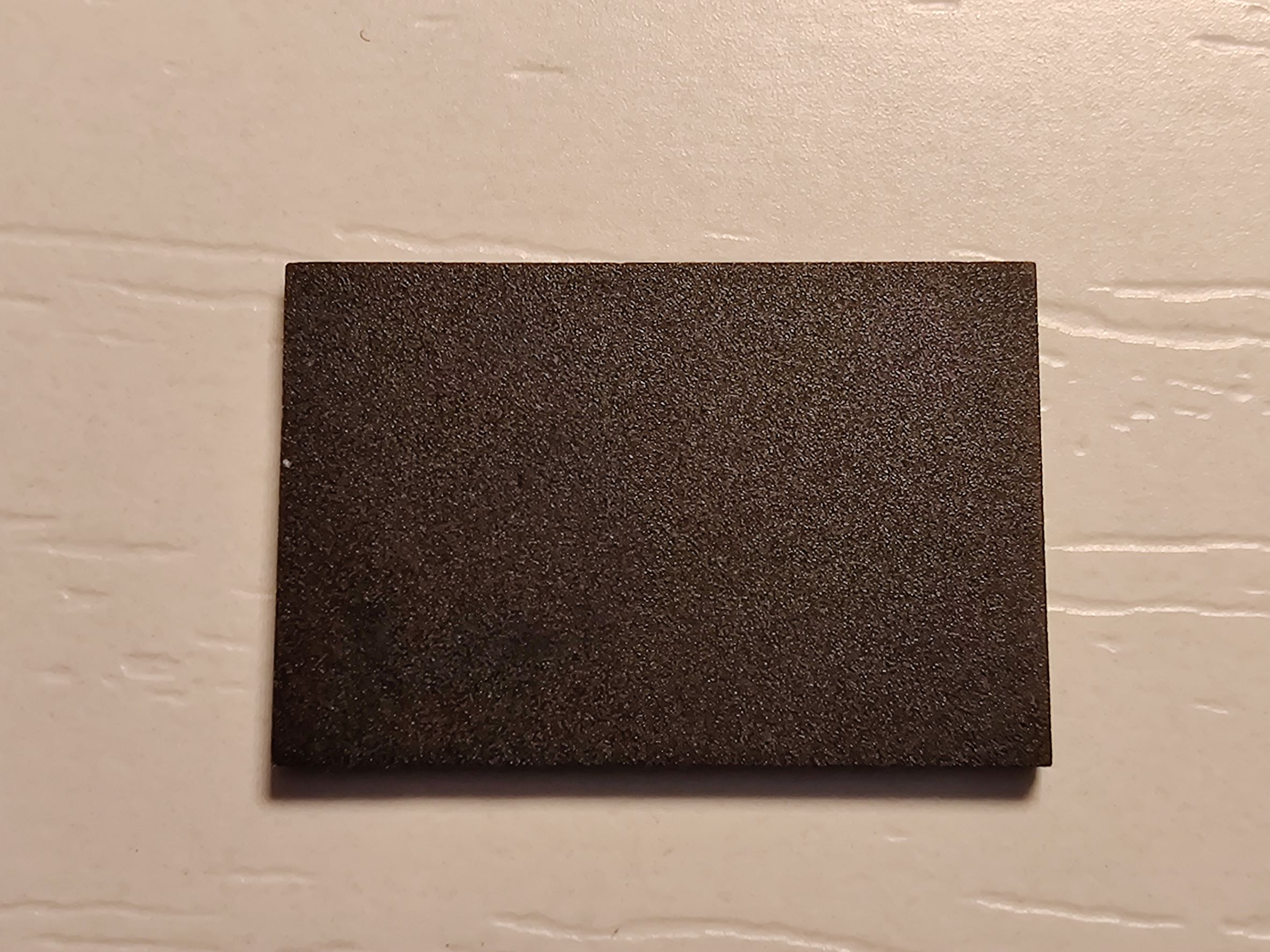

The 2 memory chips however don't have any markings on them, they should be of 128GB each.

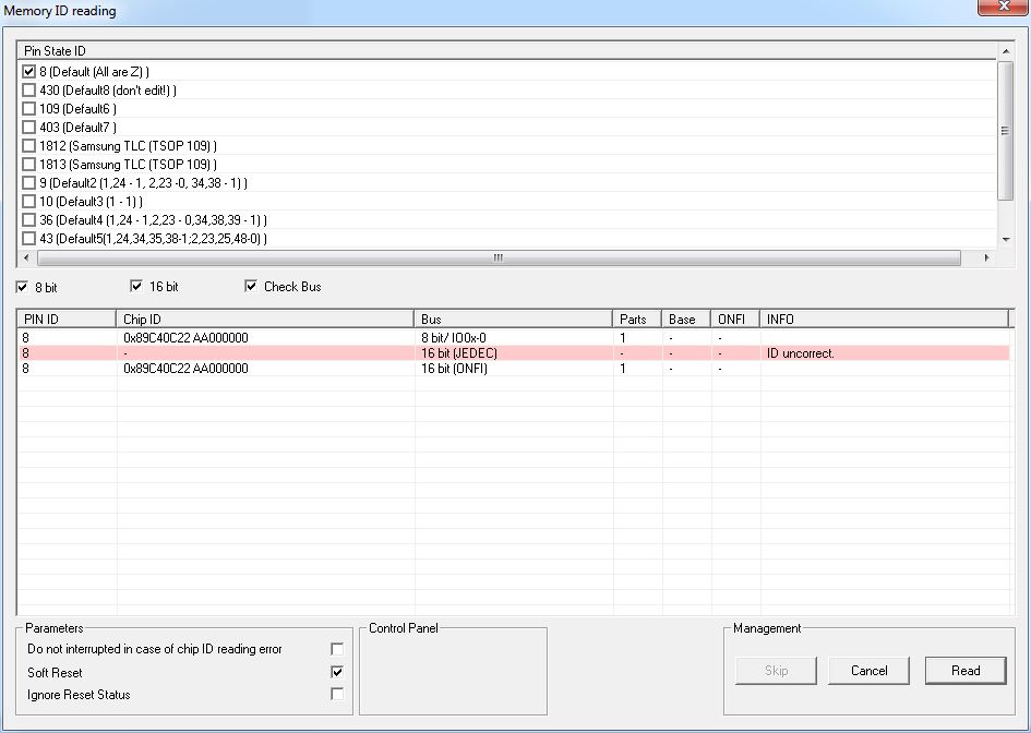

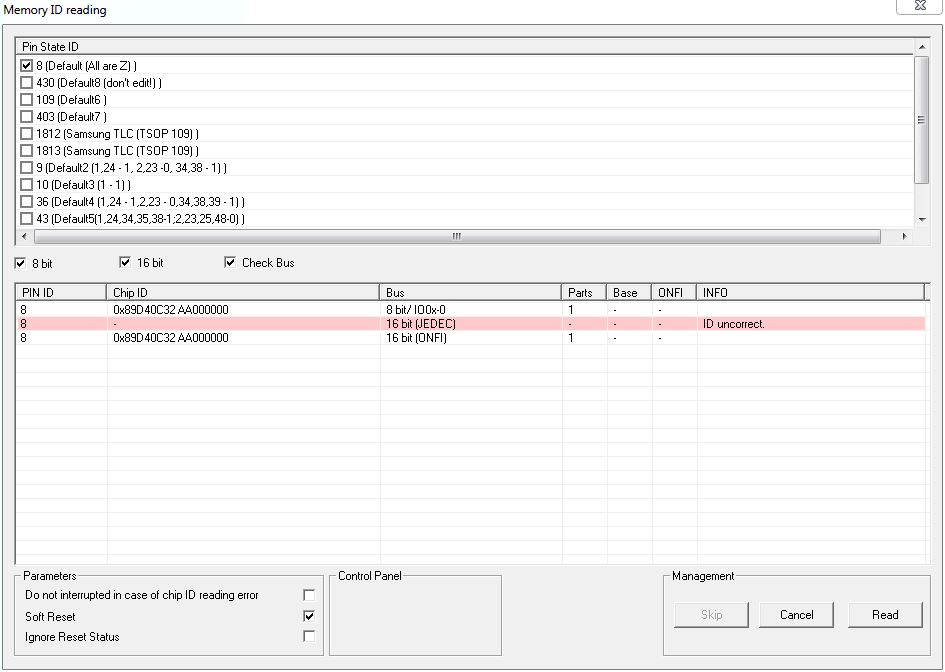

When I tried to read them the ID are 0x89C40C22-AA000000 and 0x0x89D40C32-AA000000.
Are these supported?
Thank you.

0x89D40C32-AA000000 - it's a QLC chip and it is already in PC-3000 Flash database and fully supported. We even have a ReadRetry for it. Usually, we can get not bad recovery result for this NAND ID.
As for 0x89C40C22-AA000000 - looks strange. Not sure that ID is correct, but theoretically we can add it in support list. You need to make a ticket and prepare the latest software version of PC-3000 Flash (7.5.14)
