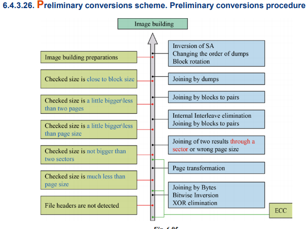

When I go for a raw recovery I find many files, everything looks near perfection but I'm having a small checked size and according to the manual in section: 6.4.3.25. Raw recovery mode I believe i'm failing to have my files reaching all the checkpoints in order for them to be complete.
I'm now following the attached checklist and after doing this steps, i'm still failing, I know i'm doing something stupid wrong but I can't figure out what.
I'm not looking for a quick fix for this test chip, but just to understand what basic mistake i'm making (besides lack of basic knowledge).
Thank you for your help

I've read, corrected ECC, then followed the procedure on the attached image always checking for improvements with no luck.
I'm gonna keep trying.

That sheet is very useful and gives you the basic outlines. But these days chips tend to be quite complex in their layout. Although the SSS6677 is normally pretty basic. For example some, chips need to have typical interleave applied more than once. If the chip has more than one part sometimes you need to join by page, some chips join by dump etc etc. Did you try translator SSS6690?
Can you post a screenshot of where you are now.

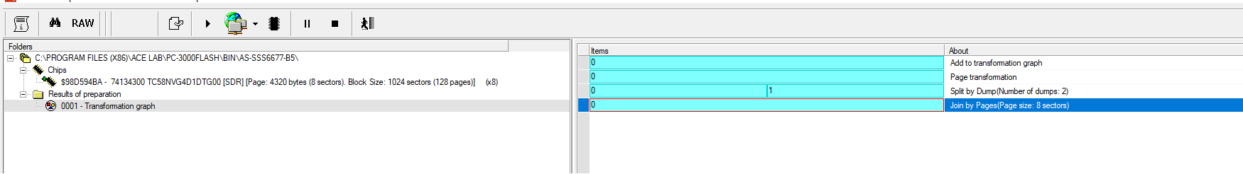

Hi again.
This is what gave me the best results (some files have same size vs checked size but still few open)
