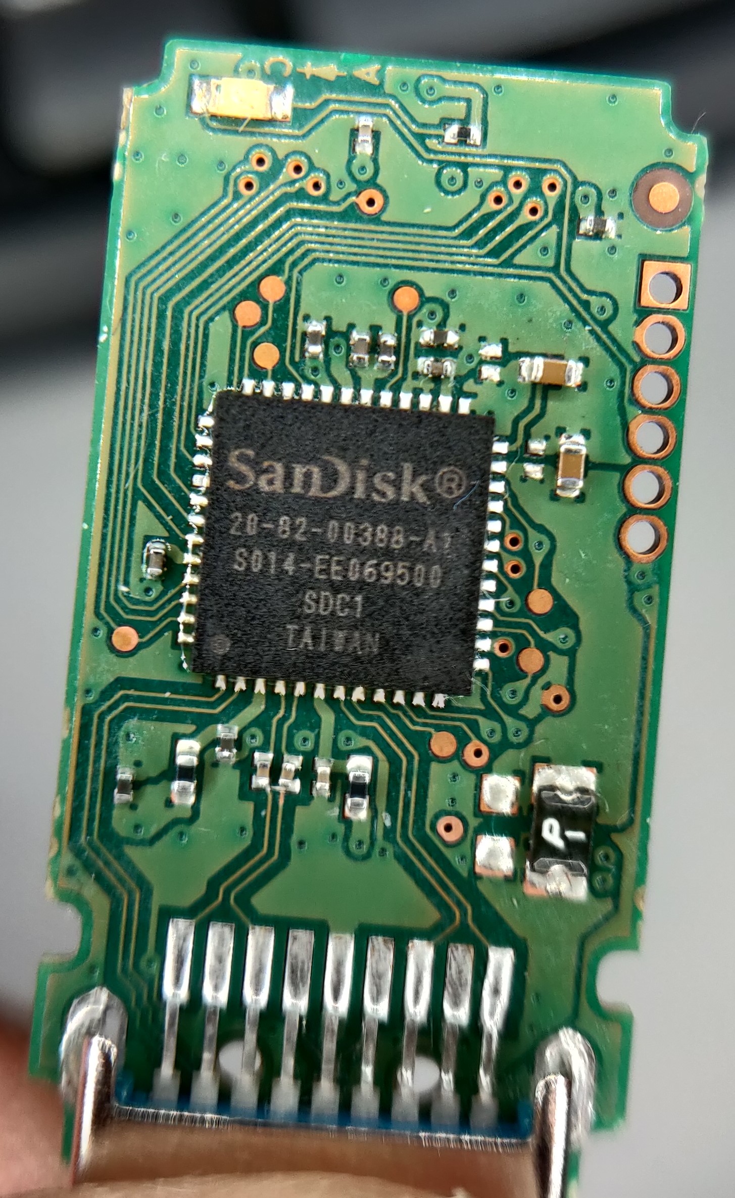

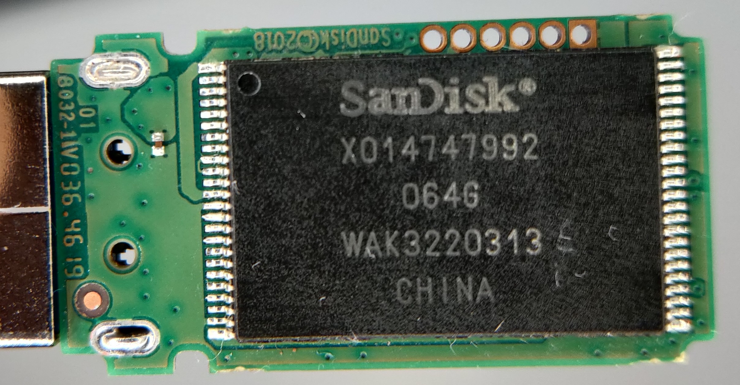

Hello everyone,
I'm having some trouble identifying the model # of this SanDisk USB flash drive.
It was brought in without an enclosure and I can't power it up so we need to locate some donor parts.
Attaching some pics of the board.
Any help will be appreciated. :wink:
Thanks!
SanDisk usb 2 smaller.jpg (12.51 KiB) Viewed 5561 times
SanDisk usb smaller size.jpg (699.88 KiB) Viewed 5561 times
Re: Identifying SanDisk Flash
Postby Roman_TS » 04.10.22, 15:15
Hello!
This CPU is supported, so you can use a chip off to remove the NAND and read it with the help of PC-3000 Flash. Please contact our engineers on ts.acelab.eu.com and we will guide you.
