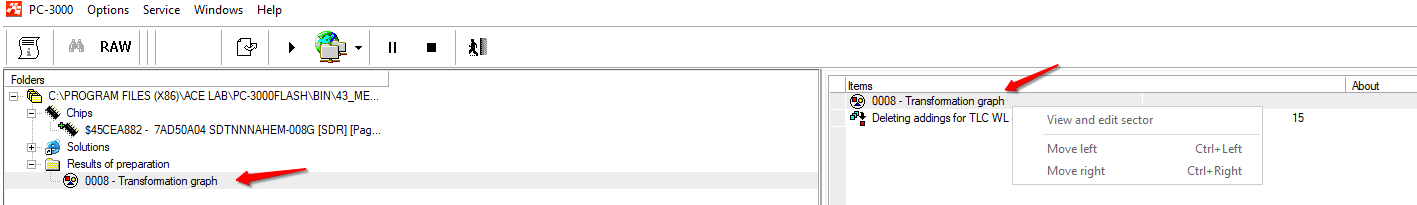

I have a strange problem in PC-3000 Flash (ver. 7.2.6). It seems like the menu on the right pane doesn´t update when I try to open the Transformation graph. So when I click "Transformation graph" in the left side menu, the graph doesn´t show on the right side - instead I see the menu item "Transformation graph" on right and left side. Have a look:
What am I missing.. How can I reset the settings to default view?

I recommend you to download PC-3000 Flash 7.2.9 which is already in your updatebox. It's already include some bugfixes. I'm sure, this bug has been already fixed too.

Thanks Roman. Tried to update, but same problem.. I'll create a ticket.

Reason for menus not updating was that current task containined too many unions and old attempts of auto-solution (due to try-and-fail). Cleared from Task-folder, and all good.
