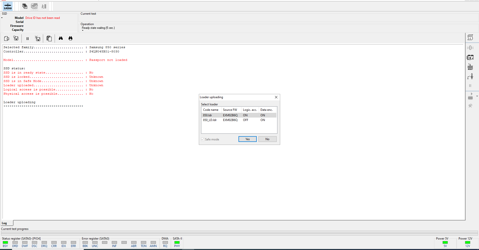

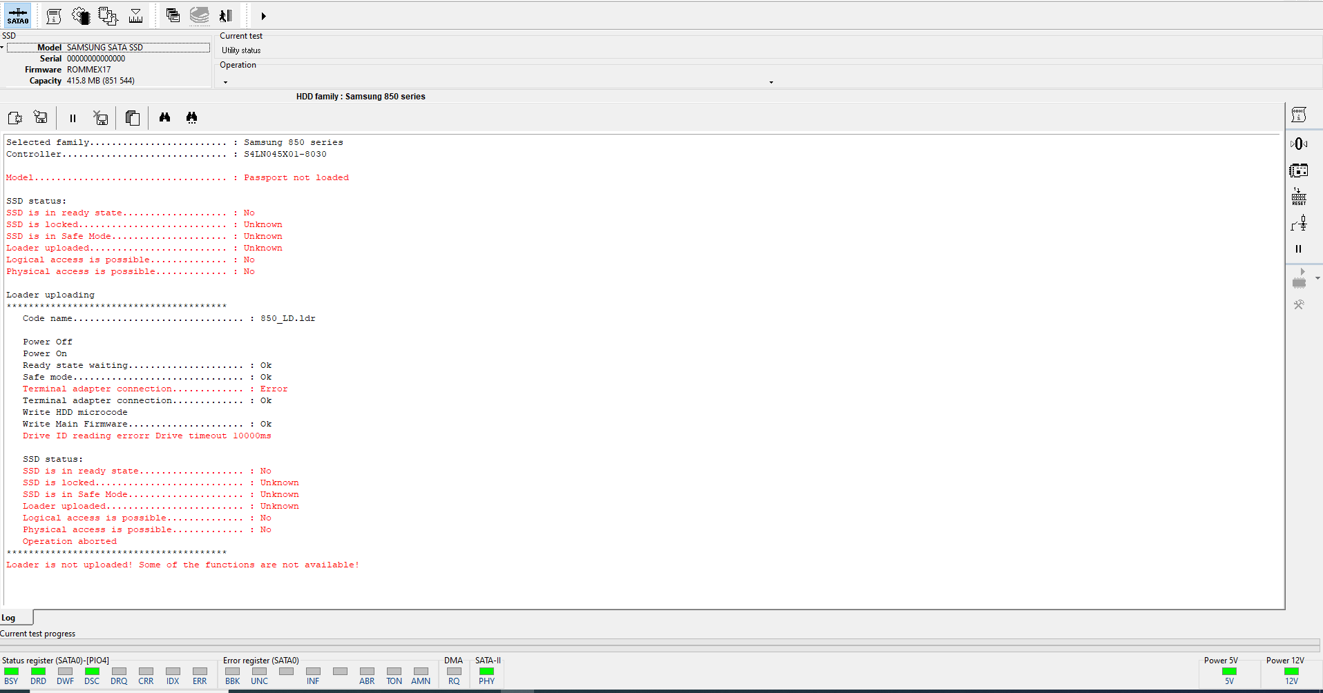

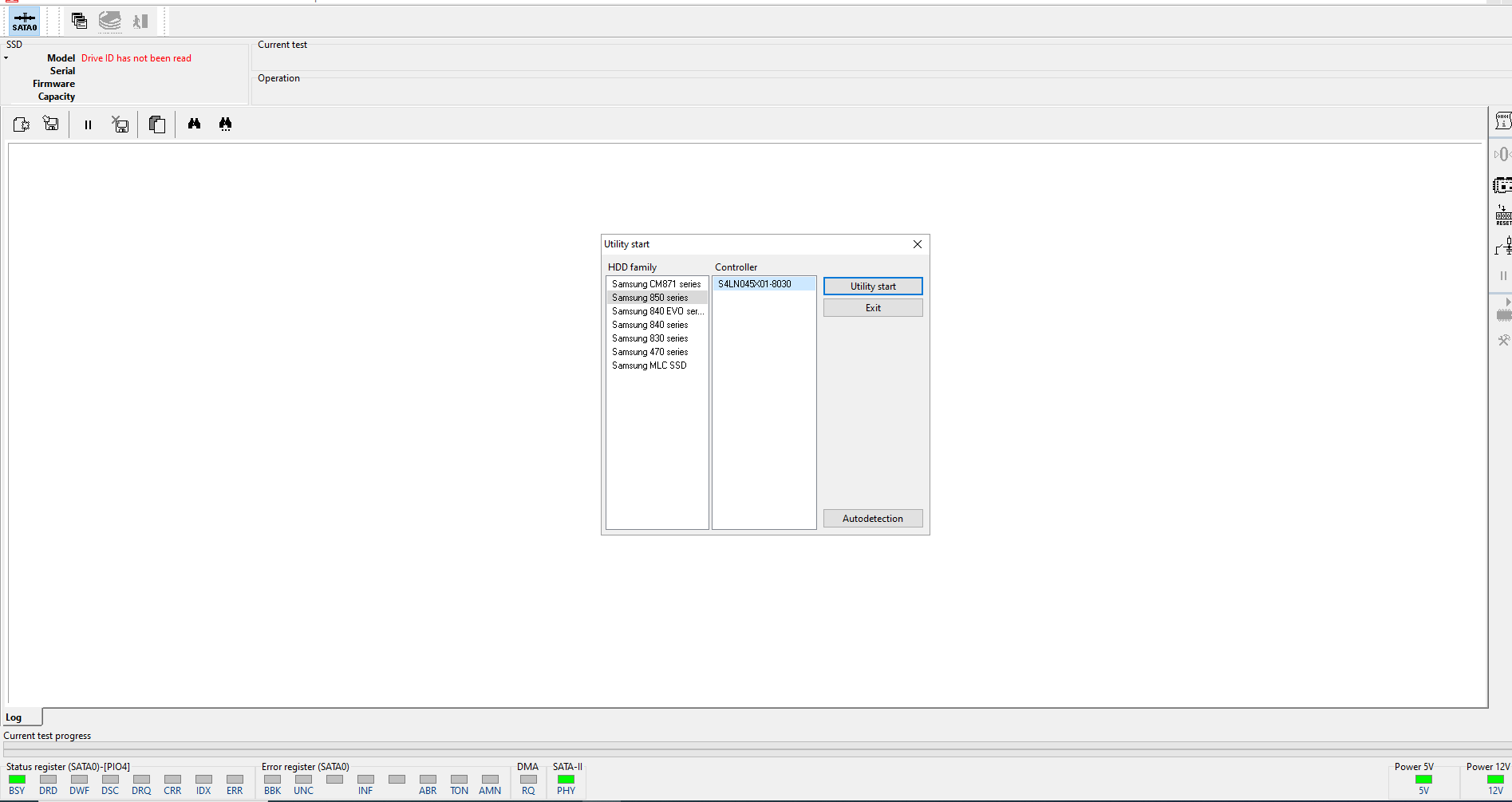

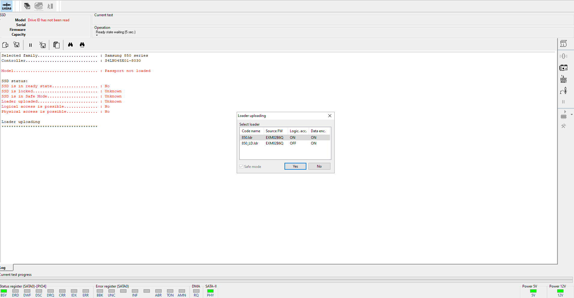

I followed the instructions in the video but I can't load the loader.
The screen shots speak for themselves.
Did it happen to you too?

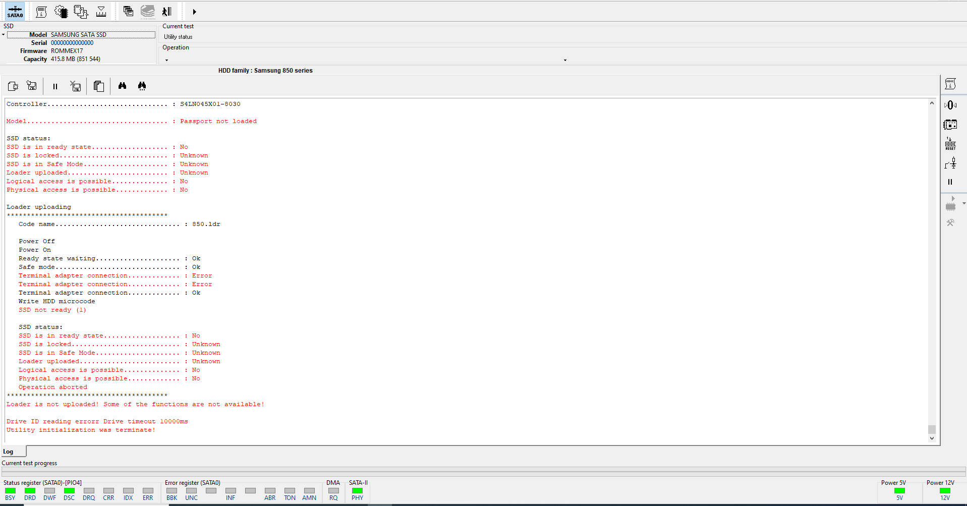

Hello. There were a few revisions of Samsung 850 PRO, some of them are not supported due to the locked Techno Mode. Some of them have incompatible Firmware.
As the result, we are not able to initialize the drive.
If you plug terminal correctly, but both existing loaders doesn't work, then I'm afraid, we have no good solution for your drive.

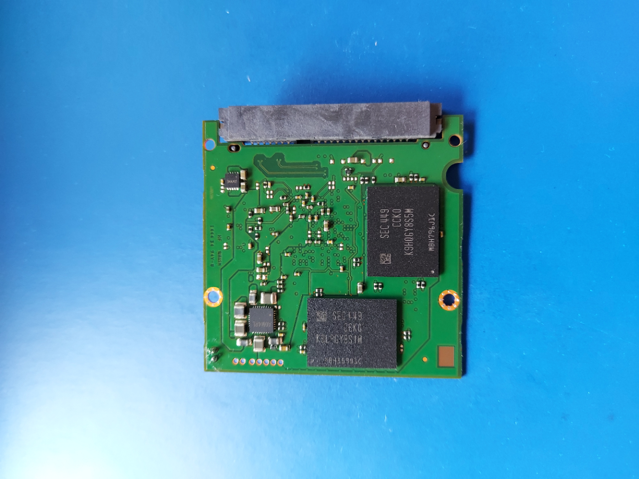

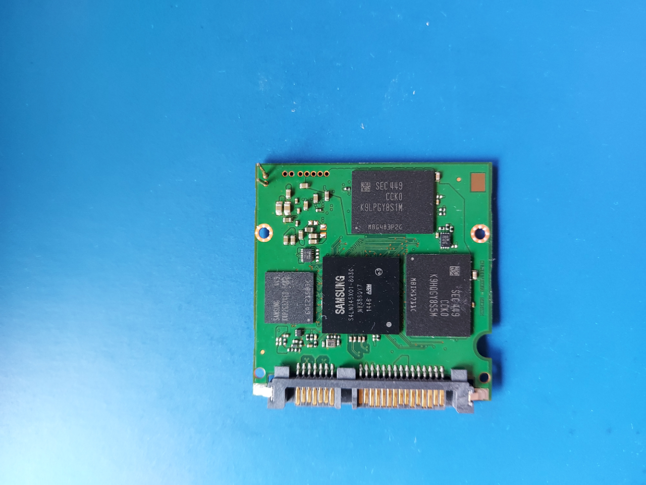

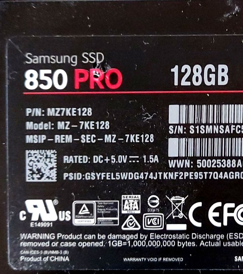

Roman, without even doing it on purpose, the SSD I have seems to be the same as the one in the video (see cover).
I also attach photos of the PCB if these can help to understand the revision.

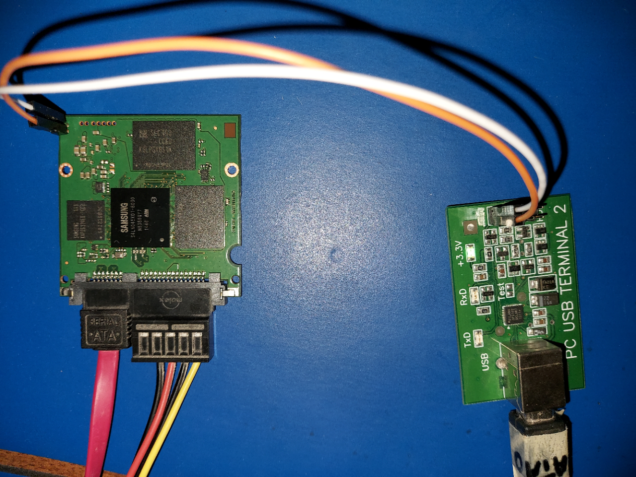

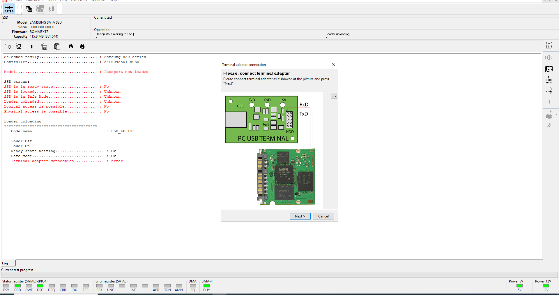

Also attached are the connections with the usb adapter.
Loader is not uploaded.PNG (62.38 KiB) Viewed 4504 times

PCB revision is the same, but internal firmware could be incompatible with existing loaders. If both of them are not working, then, I'm afraid, there is no other solution.
