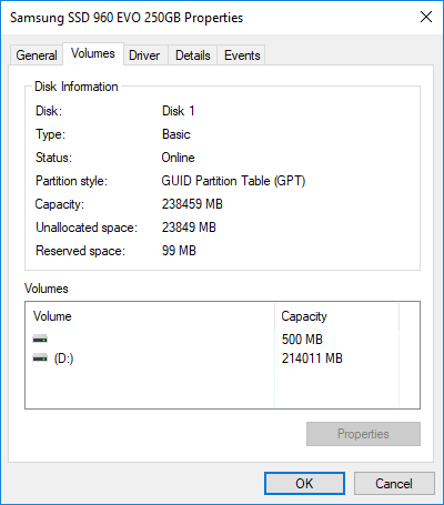

SSD Properties in Device Manager:
ssd properties.png (18.56 KiB) Viewed 12768 times

Any hint on how to proceed?
Thank you very much.
