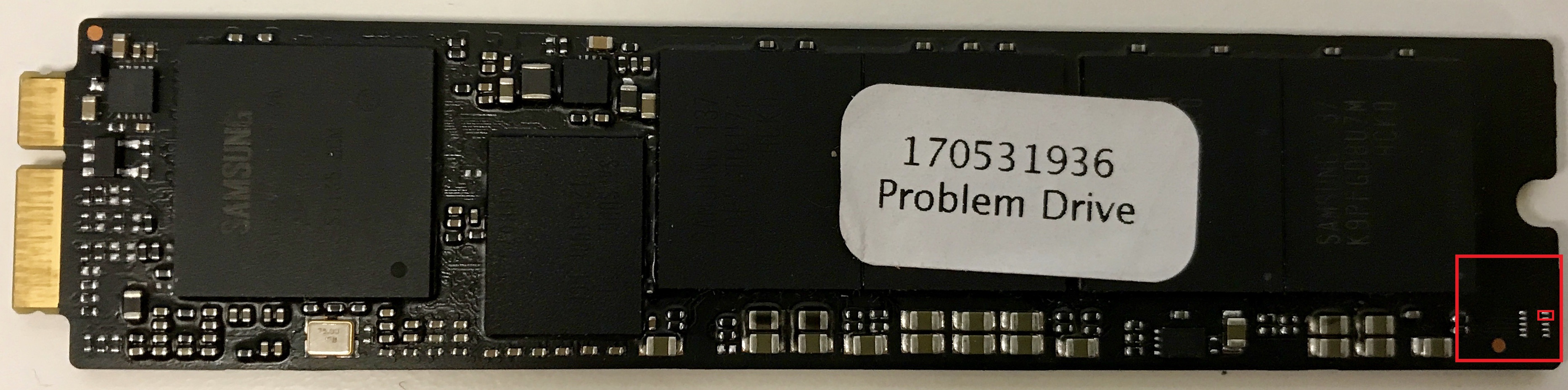

I've mounted this SSD in a SATA Adapter and connected it to the PC-3000, when powered on, it remains Busy. All of the components were tested and the SSD is electronically sound. Appears to be a Firmware issue or Controller Chip failure. I search the board for anything that looked like it could be used to initiate Safe Mode, but nothing stood out.
Controller Chip is S3C29MAX01-Y330
Is this model supported by the SSD utility and is there a way to get this SSD into Safe Mode?

Hello! Looks like a MacBoock Air drive. I'm right?
Can you attached pictures from front and back side of SSD board? I would like to check something.

Yes, MacBook Air, Mid-2011

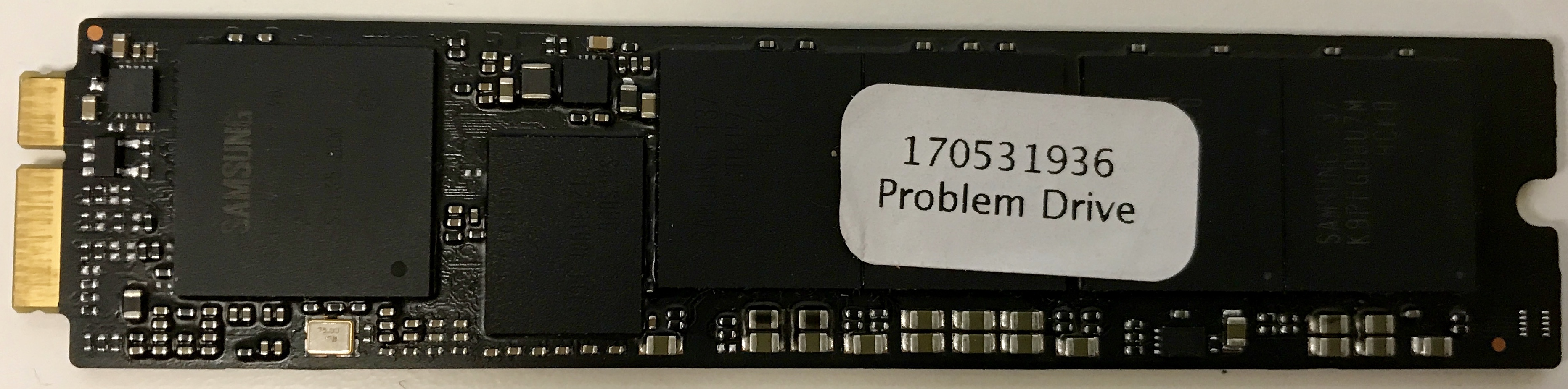

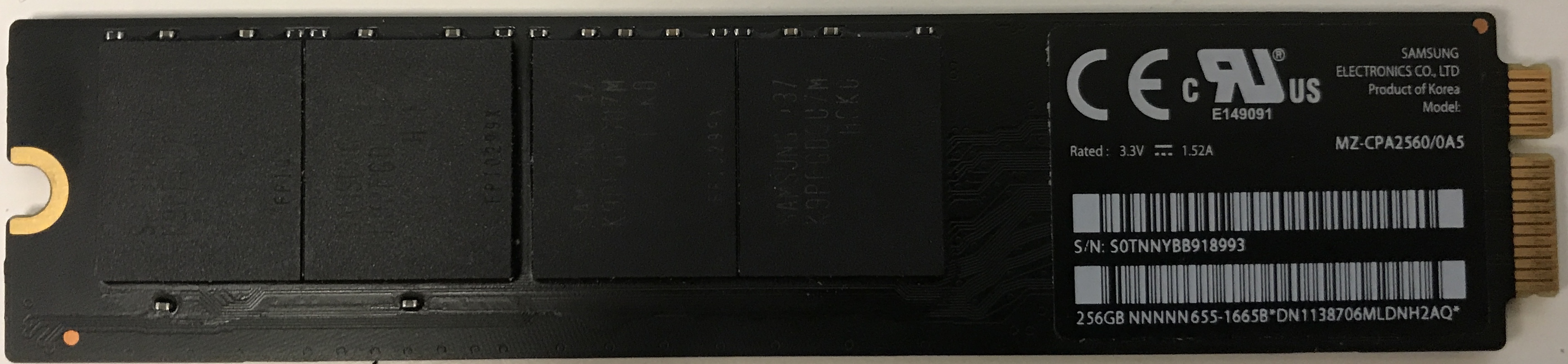

Here they are:

The contact points did allow the SSD to reach a ready state during the Loader startup process. The only loader that would load was the 470A_LDR.ldr, which did not allow sector access. The three other options failed to reach the end of the loading process without producing and error. Looks like the current loaders are not compatible with this SSD. Does anyone have a Loader that would work with the above SSD?
