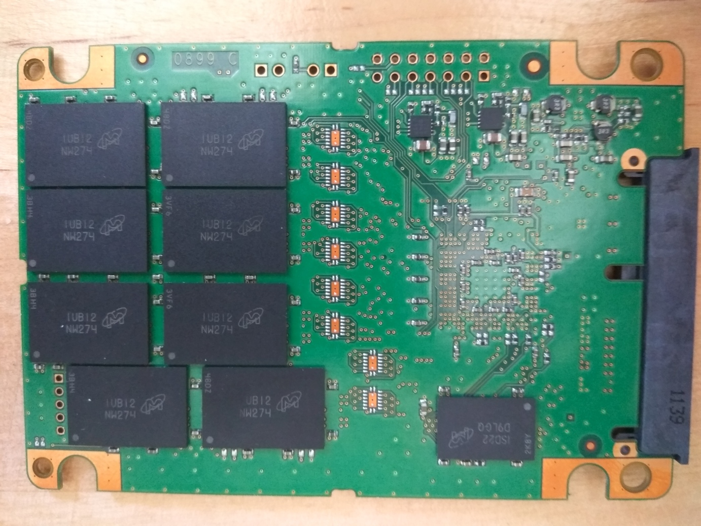

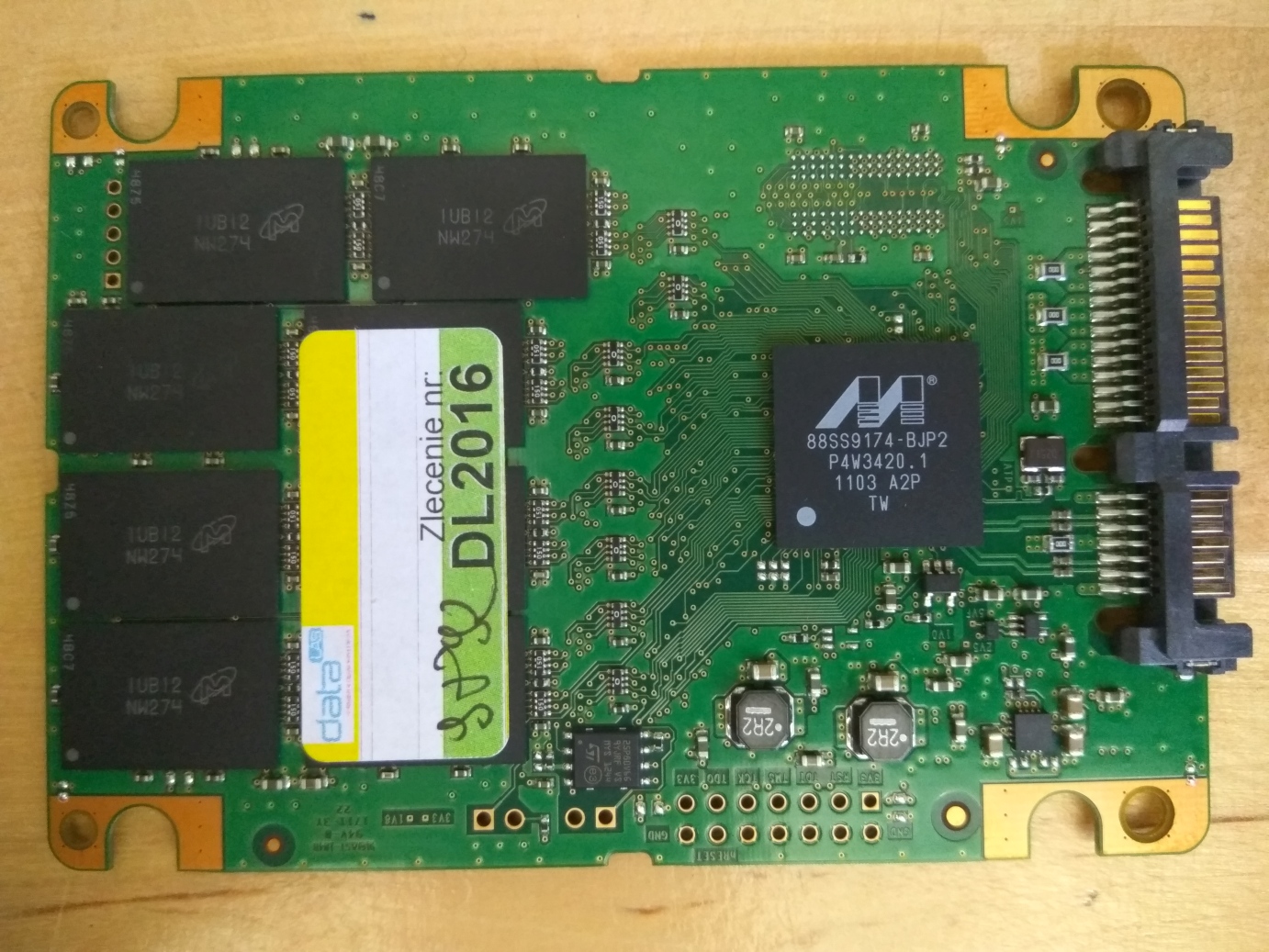

I have case with SSD that when i turn it on in PC3000, state is RDY... When i want turn on utillity - SSD is change to BSY... And that is...
Not recognized ID, Capacity, etc...

Hello! Looks like this drive has serious problem with FW - when you trying to send any command on it it goes in BSY. Will try to find what we can do.
P.S. This drive does not required hardware shorting for switching in SAFE.

BSY problem is popular in Marvell based SSD. First of all, if you want to recover data from such drive, it should be supported by PC-3000 and your drive (exactly your model!). Also, in case if VanGogh (family of Marvell controllers) stay in BSY, need to wait for 1-2 hours. Sometimes drives goes in Ready after several minutes or hours - it's typical feature of those SSD. Something become corrupted inside drive Firmware, and it goes in loop loading. After some time it should finished all initialization processes and goes in READY. But usually it's useless because we still need technomode for data recovery, and if drive is not in the support list, we can't do anything.
