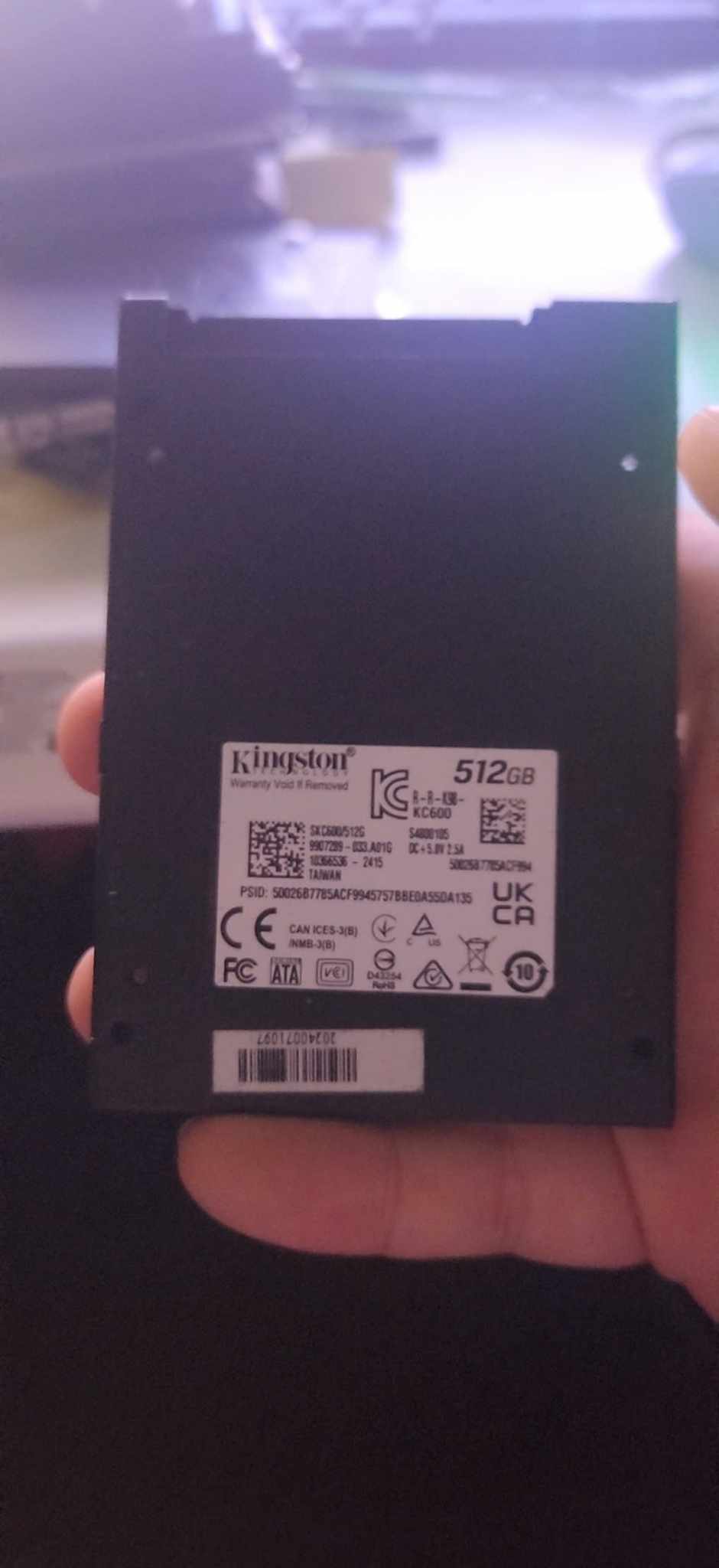

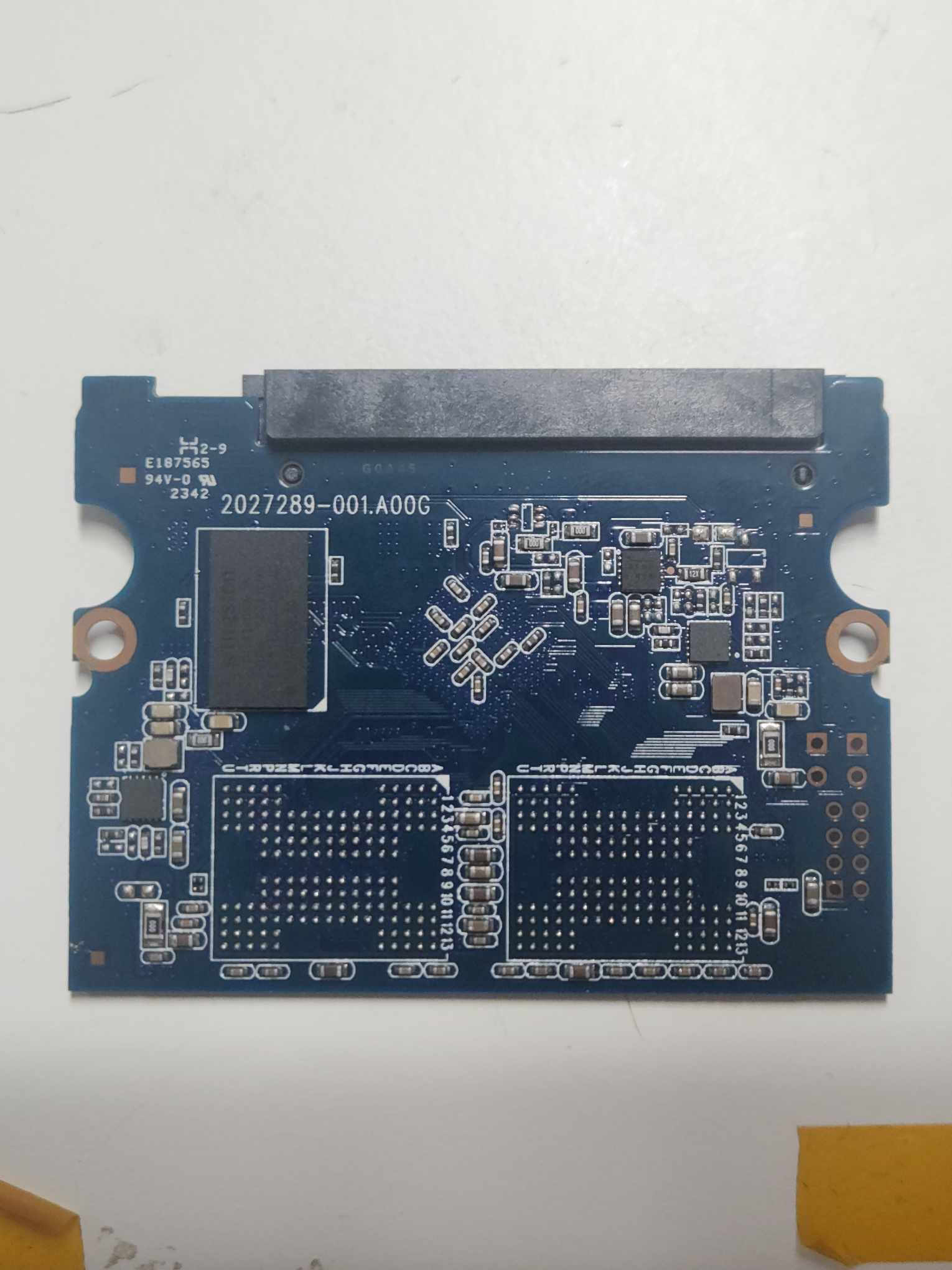

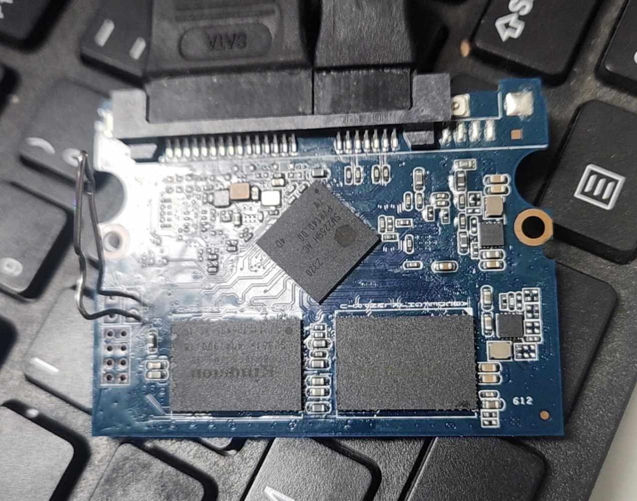

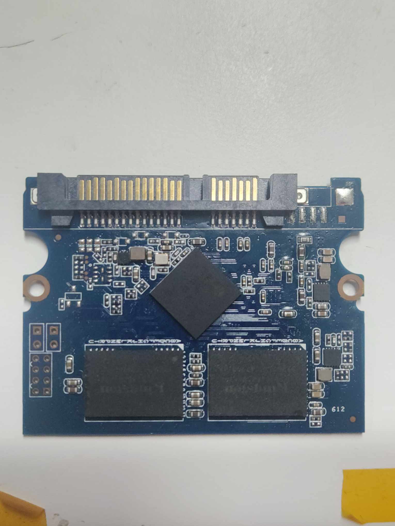

Postby gameboybin » 03.01.25, 09:06
Exact same problem like in Lasek post. Still no correct loader for this SSD. I have tried every single one of them loaders. None of them Recognized the SSD as a 2x256GB chip SSD
Kingston SKC600/512 S4800105 SM2259H AC
