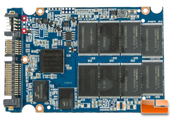

I have a Kingston SSD Now V200 128GB for data recovery.
If i just power it the drive stays BSY. If i short red pins in Picture bellow it gets DRD DSC.
It is then detected as
Picture 2.png (2.85 KiB) Viewed 11937 times
I read on PC-3000 SSD List of supported SSD that Kingston V200 (JMF 667 and Toshiba TC58NCF667GDT) – has partial support;
Problem is mine has TC58NCF668GDT which i guess it is JMF668, so i think it's not supported at all.
But i do not see any info anywhere about how it is JMF667 partially supported.
I measured voltages on PCB and it seems like everything it's ok, all memory banks are powered by 3.3V, Ram chips are powered by 1.8V and CPU it seems like has both 1.0V and 3.3V.
No short on the pcb, no strange behaviour. All chips get warm which is a sign they are working.

Is there any loader for this one? Or any way to fix it?
Thanks.
Posts: 770
Reputation: 28 / (280)
Re: Kingston SSD Now V200 128GB
Postby Roman_TS » 01.06.18, 20:48
Hello. JMF668 modification is not supported at all. That's why Log shows you wrong capacity and NAND ID because such translator \ Firmware is not in the list. Unfortunately for now we can't do anything with this drive.
