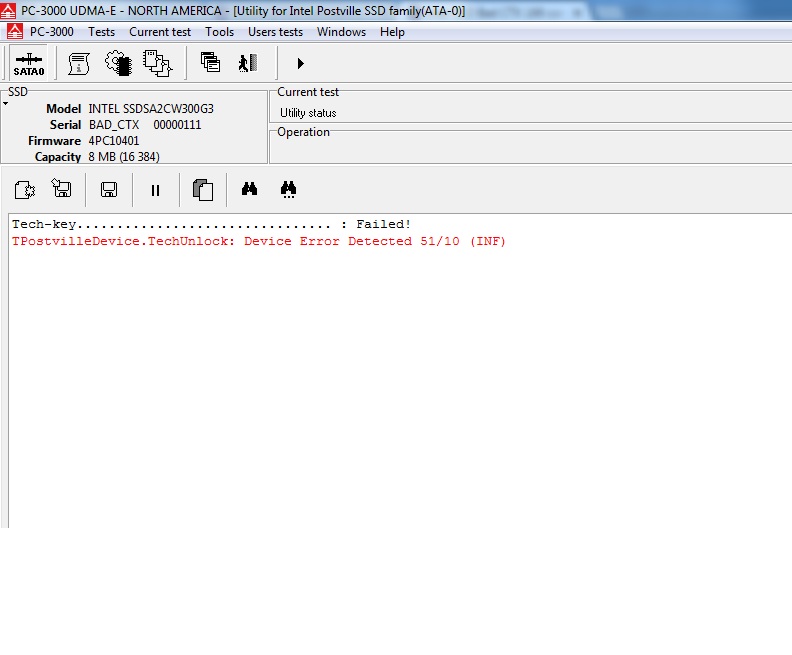

I got teck-key failed, are there anyway I can get in?
Thanks.

Try to increase timeout to 60 seconds instead 10. It might be the reason why this drive can't activate tech key - it just required more time...

I did increase to 60 following the other post, but same error. :(
Thanks.

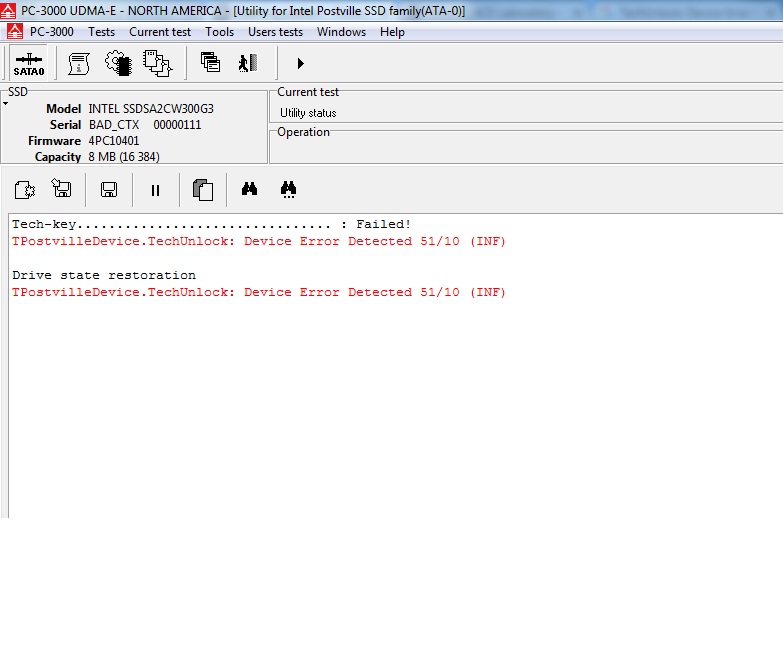

If just power on, there is the error message.

If it possible - please, reach me in TS department. I will try to check your case with TeamViewer.

Hi Roman,
I setup the TV ready.
Also I notice the control is different, PC29AS21BA0, will it be a problem?
Thanks.
