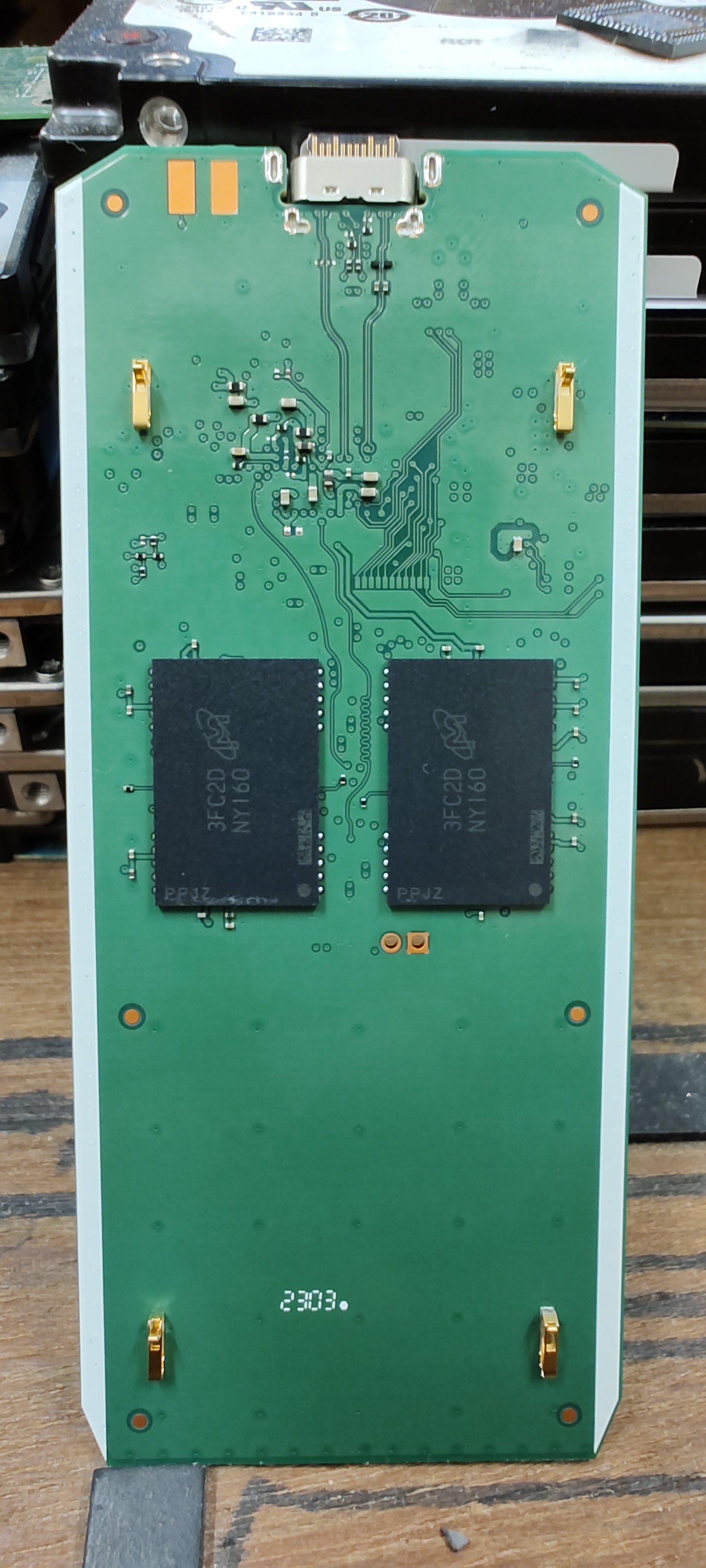

Hi All,
Is there a possibility of finding old translation tables and recovering data from this crucial X8 ,Controller is Phison PS2251-17-43 .
Re: Crucial X8 - Formatted DATA Recovery
Postby Roman_TS » 15.03.24, 09:50
Hello Amarbir. It's a complete SSD controller with USB C interface. To work with it we should have a special utility for current controller. At this moment we don't have any.
Postby Amarbir[CDR-Labs] » 15.03.24, 10:24
Roman_TS wrote:Source of the post Hello Amarbir. It's a complete SSD controller with USB C interface. To work with it we should have a special utility for current controller. At this moment we don't have any.
Thanks ,
I will inform the client ,Photos should be nice for reference for other clients an you folks also
