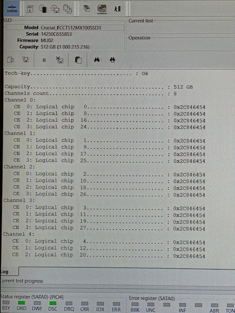

Entering the utility, the drive display Nand Chips id properly.

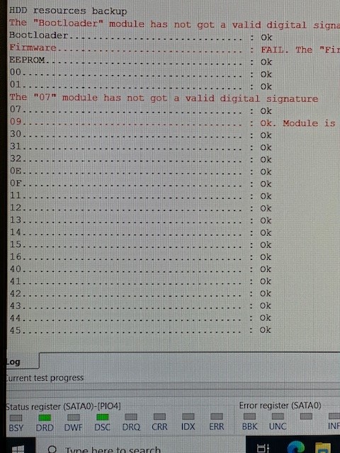

When backing up resources there are three errors: Bootloader, Firmware header and MOD 7.

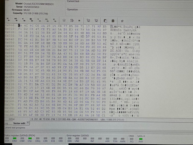

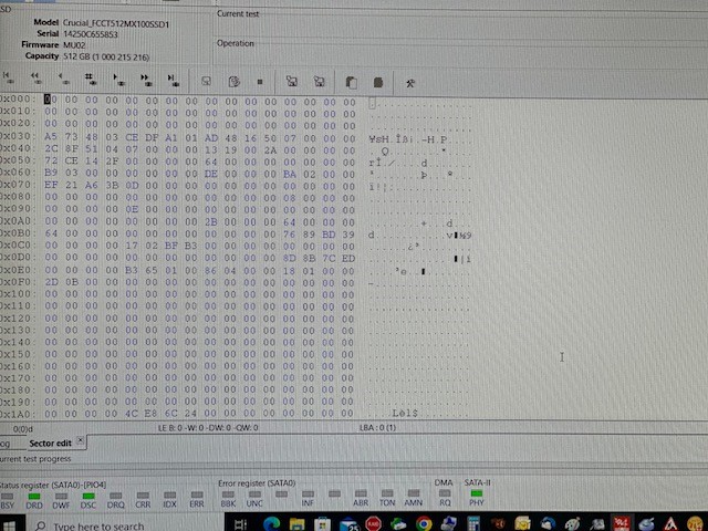

Creating a Data extractor task and attempting to read from utility reads with no errors but nothing is found.
The drive is not encrypted or password protected.
No NTFS or RAW files are found.

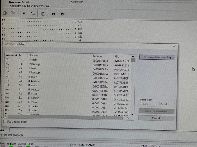

I then attempted Translator building from utility.
A list of IP modules is generated and I tried the top 10 results.
I changed the reading parameters and selected logical reading using L2P table for each of the results
but attempts with Data extractor were unsuccessful.
I have attached pictures to show above results.
