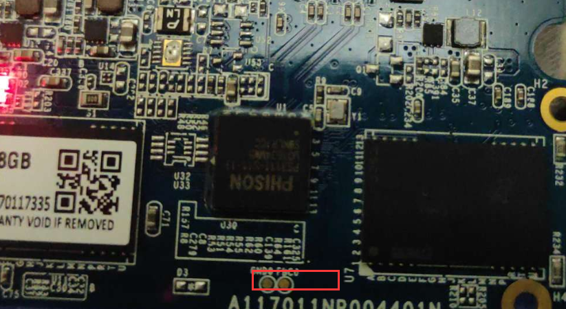

Roman_TS wrote:
Abdurrahim.sopon
Hello! This controller us fully supported. Contact ts.acelab.eu.com and our engineer will guide you.
i was try with PATA adaptor ssd show busy .
but when i connect it sata port it show ready and detected with full capacity .
i try to short pin with PATA Adapter but it always busy .
maybe my short pin out is wrong . (i use points under controller are shorting points)

Re: Corsair Force LE 200 PHISON PS3111-S11-13
Postby Roman_TS » 06.11.20, 10:50
Abdurrahim.sopon
Please upload the picture how did you connect your drive to PATA adapter.

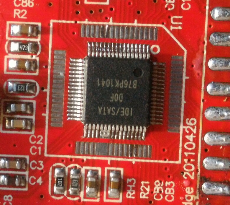

Abdurrahim.sopon
Thank you for your quick reply.
i will upload my PATA Adaptor picture .
Adaptor mcu number : DOF - B75KD0241
i lost my pc3000 IDE adaptor
Postby Roman_TS » 06.11.20, 14:48
Abdurrahim.sopon
Try to use other PATA to SATA adapters. This one doesn't work correctly.
But of course, always better to use official ACELab adapter - it always works.
