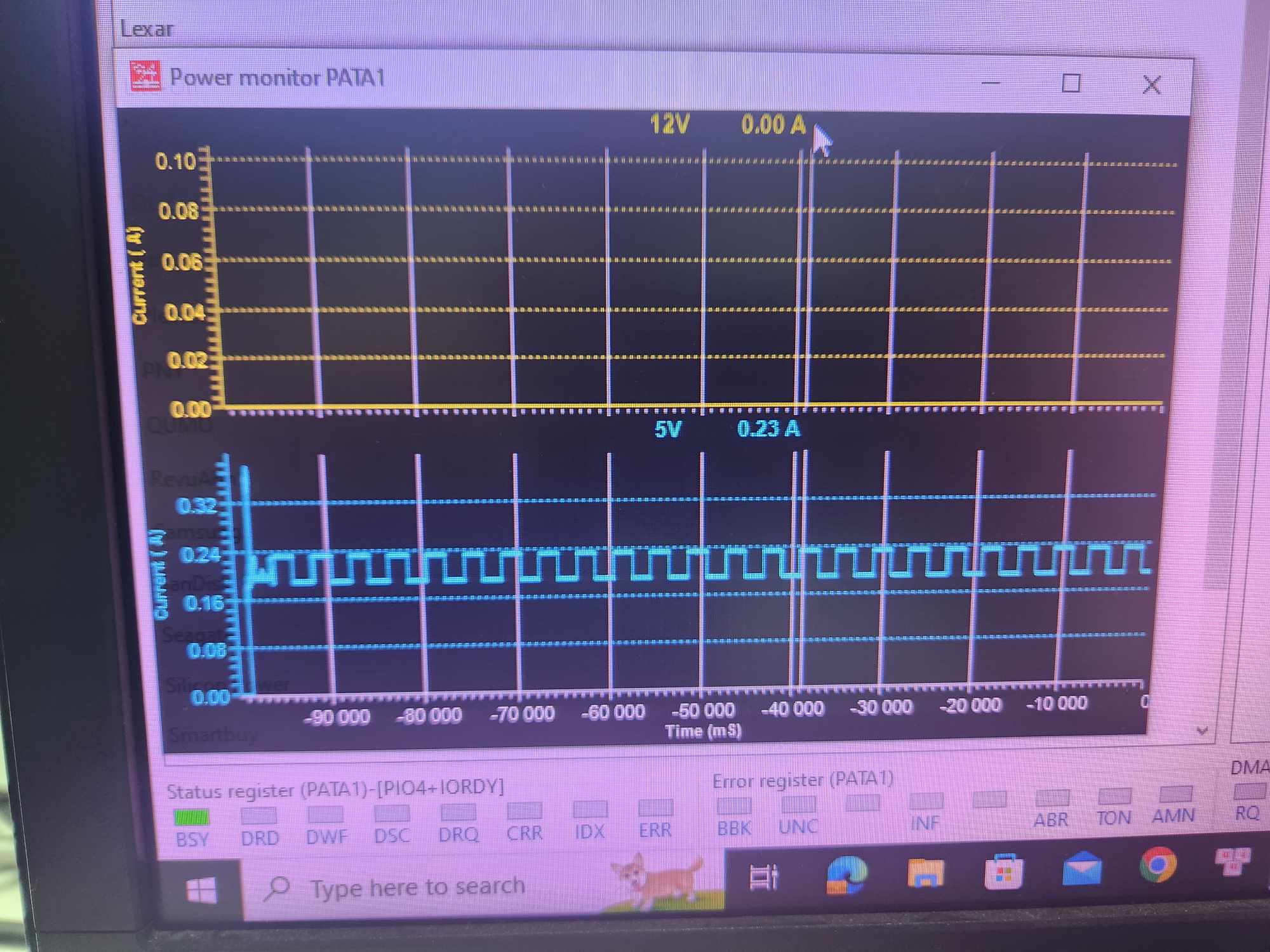

So i have this 1TB Pioneer SSD
Upon turning on it stays BSY and shows Square Waves jumping from 0.19A to 0.23A
Anyone knows the what can be the problem of this SSD
I tried shorting ROM pins which readied the drive. However shows only 00000 information in ID
What i think it can either be FW or bad components??
Thanks for any help! :wave: :wave: :wave:

Did you use PC3000 SSD to upload loader?

d_d_recovery wrote:Source of the post Did you use PC3000 SSD to upload loader?
I havent got the newest version of PC3000 Sadly
Re: Pioneer 1TB SSD Maxio MAS1102B controller
Postby gameboybin » 28.08.24, 10:15
And i found out that the newest version won't help
Postby Roman_TS » 28.08.24, 19:44
MAS0902 is under research as well as MAS1102, but MAS0902 has better success, new update bring some extended translator features for MAS0902, while MAS1102 is still under researching and we can work only with ADATA SU650 240GB based on MAS1102.
