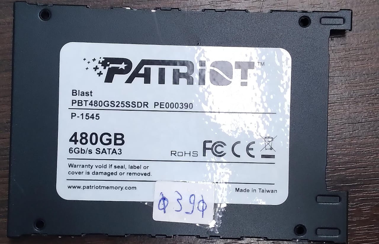

Hello, I have the following disk:
Model: PBT480GS25SSDR
Manufacturer: PATRIOT
Capacity: 480 GB
Cover Label: PE000390
P-1545
Controller Label:
PHISON
PS3110-S10-2
U01533C
SNSCT1DC
I attached the pins shown in the picture attached, and uploaded loader12 the utility cannot make the translator, i attached the log file
any one can help. Please not the attached pic when i start in safe.
thank you

Is the short pins for safe mode correct
Re: Patriot Plast cannot make translator
Posted: 15.11.23, 16:50
by Roman_TS
You can contact ACELab even if your contract has been expired.
Shorting pins you marked are correct.
