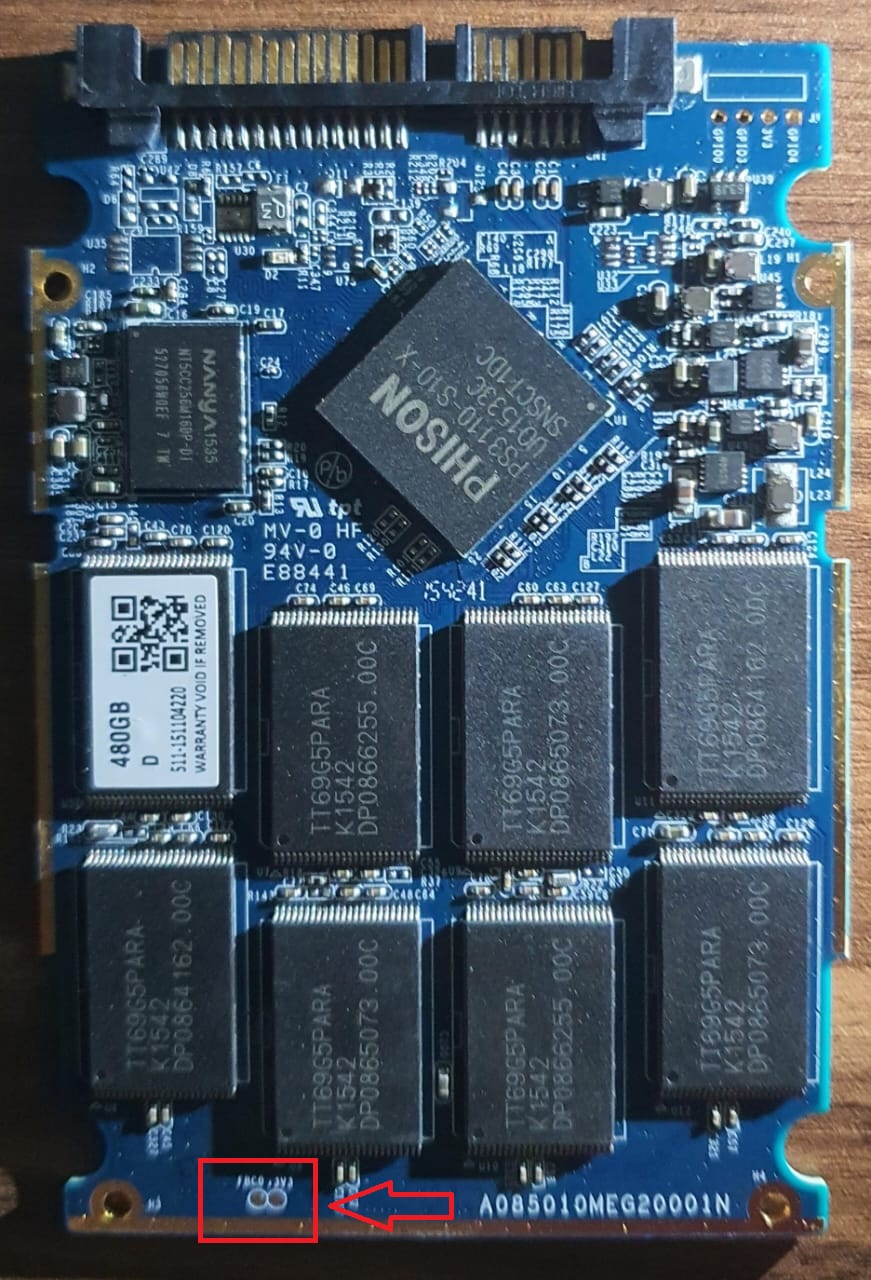

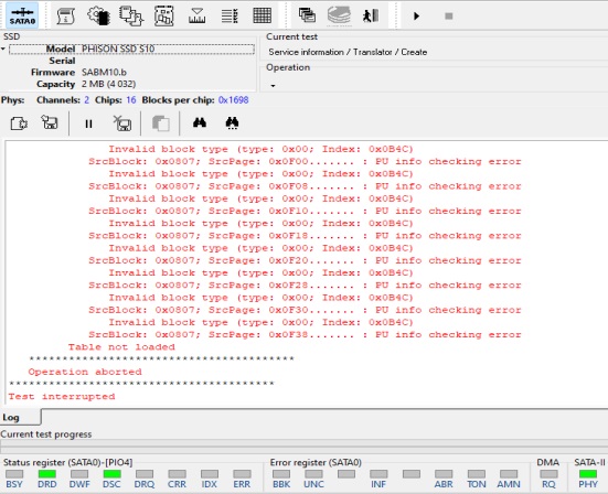

Hello, I have the following disk:
Model: PBT480GS25SSDR
Manufacturer: PATRIOT
Capacity: 480 GB
Cover Label: PE000390
P-1545
Controller Label:
PHISON
PS3110-S10-2
U01533C
SNSCT1DC

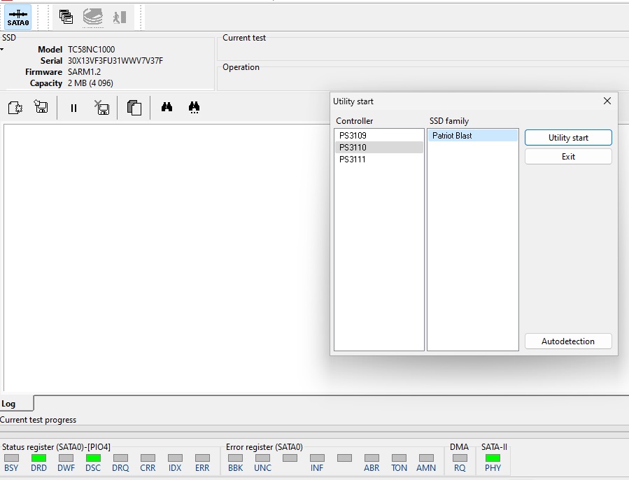

I attached the pins shown in the picture attached, and uploaded loader12 the utility cannot make the translator, i attached the log file
any one can help. Please not the attached pic when i start in safe.
thank you
log.log
(75.35 KiB) Downloaded 833 times

It's a very good case description. The only problem is that PC-3000 Forum - is not the place where TS engineers can guide you with such specific case. So please, make a ticket on ts.acelab.eu.com and we will help you. :D

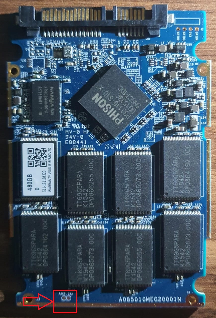

Is the short pins for safe mode correct
Posts: 770
Reputation: 28 / (280)
Re: Patriot Plast cannot make translator
Postby Roman_TS » 15.11.23, 16:50
You can contact ACELab even if your contract has been expired.
Shorting pins you marked are correct.
