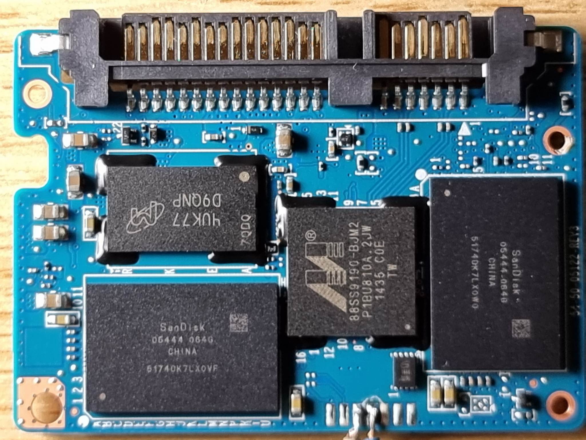

Hello Guys!
Sandisk X300 SD7SB6S-256G 88SS9190 fatal failure!
Need safe mode short pin guide this drive.
Terminal outputs:
<MSG 895246 uS> Rebld XOR star 1 MB 37 pageCnt 232 lastWr 0x7c0941c0
<MSG 904698 uS> Rebld XOR star 2 MB 15 pageCnt 940 lastWr 0xbc03c740
<MSG 931847 uS> Rebld XOR star 3 MB 47 pageCnt 1088 lastWr 0xfc0bc860
<MSG 1031880 uS> Rebld XOR star 0 MB 32 pageCnt 160 lastWr 0xfc080120
<MSG 1039574 uS> Rebld XOR star 2 MB 36 pageCnt 332 lastWr 0xbc090280
<MSG 1050322 uS> [ST] Previous temp 45, current temp 35
<MSG 1052674 uS> Rebld XOR star 1 MB 23 pageCnt 244 lastWr 0x3c05c1e0
<MSG 1065369 uS> Rebld XOR star 3 MB 9 pageCnt 920 lastWr 0x7c024720
<MSG 1250959 uS> STAR 4 .. UNGRACEFUL ..
<MSG 1278027 uS> STAR 5 .. UNGRACEFUL ..
<MSG 1284272 uS> STAR 7 .. UNGRACEFUL ..
<MSG 1530407 uS> Rebld XOR star 4 MB 20 pageCnt 677 lastWr 0x4c050540
<MSG 1551022 uS> Rebld XOR star 7 MB 45 pageCnt 1100 lastWr 0xbc0b4880
<MSG 1582136 uS> Rebld XOR star 5 MB 61 pageCnt 682 lastWr 0x9c0f4540
<MSG 1605443 uS> STAR 6 .. UNGRACEFUL ..
<MSG 1667711 uS> Rebld XOR star 4 MB 22 pageCnt 48 lastWr 0xfc058040
<MSG 1672366 uS> Rebld XOR star 5 MB 59 pageCnt 960 lastWr 0xfc0ec760
<MSG 1701311 uS> Rebld XOR star 7 MB 46 pageCnt 672 lastWr 0xfc0b8520
<MSG 1800900 uS> Rebld XOR star 4 MB 47 pageCnt 852 lastWr 0x3c0bc6a0
<MSG 1825977 uS> Rebld XOR star 5 MB 12 pageCnt 1044 lastWr 0x3c030820
<MSG 1855926 uS> Rebld XOR star 7 MB 34 pageCnt 160 lastWr 0xfc088120
<MSG 1939017 uS> Rebld XOR star 5 MB 6 pageCnt 92 lastWr 0xbc0180a0
<MSG 1944872 uS> Rebld XOR star 4 MB 10 pageCnt 220 lastWr 0xbc0281a0
<MSG 1954235 uS> Rebld XOR star 7 MB 14 pageCnt 1144 lastWr 0x7c0388e0
<MSG 1986603 uS> Rebld XOR star 6 MB 59 pageCnt 13 lastWr 0xcc0ec000
<MSG 2013823 uS> Rebld XOR star 6 MB 60 pageCnt 176 lastWr 0xfc0f0140
<MSG 2054346 uS> Rebld XOR star 6 MB 26 pageCnt 1204 lastWr 0x3c068960
<MSG 2105888 uS> Rebld XOR star 6 MB 55 pageCnt 1272 lastWr 0x7c0dc9e0
<MSG 2325721 uS> Track ID 80
<MSG 2325816 uS> Err UECCbit 0xF eraseBit 0x0 EH_step 0 isLow 1 C 0 pl 2 d 0 CE 0 b 1071 p 37 EC 0 RepBlk 1071
<MSG 2349631 uS> SLC DyR exhausted. Star 0 die 0, ch 0, ce 0, pgNum 37 FirstCase 0 CurrentCase 0
<MSG 2355636 uS> Soft Reset Status (75h cmd): 80h
CVD Channel 0, CE# 0, Die 0, Plane 2, Block 1071, Page 37, WL 37
<MSG 2365725 uS> Ret stat track 80 msgType 0 msgID 0 st ffffffff
<MSG 2371479 uS> Rebld XOR star 2 MB 44 pageCnt 1064 lastWr 0x7c0b0840
<MSG 2404554 uS> Rebld XOR star 3 MB 22 pageCnt 1039 lastWr 0xec058800
<MSG 2434242 uS> Rebld XOR star 0 MB 23 pageCnt 123 lastWr 0xac05c0e0
<MSG 2441080 uS> Rebld XOR star 1 MB 18 pageCnt 260 lastWr 0x3c048200
<MSG 2451531 uS> Track ID 59
<MSG 2451624 uS> Err UECCbit 0xF eraseBit 0x0 EH_step 0 isLow 1 C 0 pl 2 d 6 CE 0 b 1070 p 38 EC 0 RepBlk 1070
<MSG 2463951 uS> SLC DyR exhausted. Star 6 die 6, ch 0, ce 0, pgNum 38 FirstCase 0 CurrentCase 0
<MSG 2469953 uS> Soft Reset Status (75h cmd): 80h
CVD Channel 0, CE# 0, Die 6, Plane 2, Block 1070, Page 38, WL 38
<MSG 2480046 uS> Ret stat track 59 msgType 0 msgID 0 st ffffffff
[FATAL FAILURE]
Log Version : 2
FW Version : HI:0x50647238 LO:0x3439304C
Current CPU : CPU0
Module : SATA_Aux.c
Line : 248
CPU Registers : CPU0 CPU1
---------------> [R0 ] = 0x0 0xFF
---------------> [R1 ] = 0x400377C 0x40292CCC
---------------> [R2 ] = 0x400377C 0x3
---------------> [R3 ] = 0x0 0x40137E38
---------------> [R4 ] = 0x0 0x31
---------------> [R5 ] = 0xC 0x1DF
---------------> [R6 ] = 0xDC 0x3
---------------> [R7 ] = 0x4015D7F0 0x0
---------------> [R8 ] = 0x0 0x4002ACC
---------------> [R9 ] = 0x0 0x1DF
---------------> [R10 ] = 0x401238C4 0x1DF
---------------> [R11 ] = 0x0 0x58
---------------> [R12 ] = 0xC 0xF
---------------> [SP ] = 0x4006AC8 0x4001500
---------------> [LR ] = 0x80023214 0x8007C12C
---------------> [SPSR] = 0x60000053 0x0
---------------> [CPSR] = 0x40000053 0x80000053
Intr Task's PC : 0x000006E0
Intr Task's LR : 0x80023214
Intr Task's SP : 0x04006AB8
RTOS ErrNo : 0xFFFFFFFF
SW Timestamp : 243 ticks
HW Timestamp : 2486130 uS
User parameters:
---------------> [ARG0] = 0x0
---------------> [ARG1] = 0x0
---------------> [ARG2] = 0xDC
---------------> [ARG3] = 0xF8
RTOS Task ID : [0x4 = FE]
Record CRC : 0x90CC9C40
Collect show functions with compression .
Total compressed from 6654 to 1428 bytes
Collect show functions with compression ................
Total compressed from 213234 to 33035 bytes
<MSG 8659172 uS> FS Meta block Erase: channel - 0x2 block - 0x431 die - 0x7 plane - 0x2
<MSG 8669008 uS> FS Meta block Erase: channel - 0x2 block - 0x430 die - 0x0 plane - 0x0
<MSG 8679583 uS> FS Meta block Erase: channel - 0x2 block - 0x431 die - 0x7 plane - 0x2
<MSG 8689419 uS> FS Meta block Erase: channel - 0x2 block - 0x430 die - 0x0 plane - 0x0
fatal_failure>
fatal_failure>
fatal_failure>
fatal_failure>
