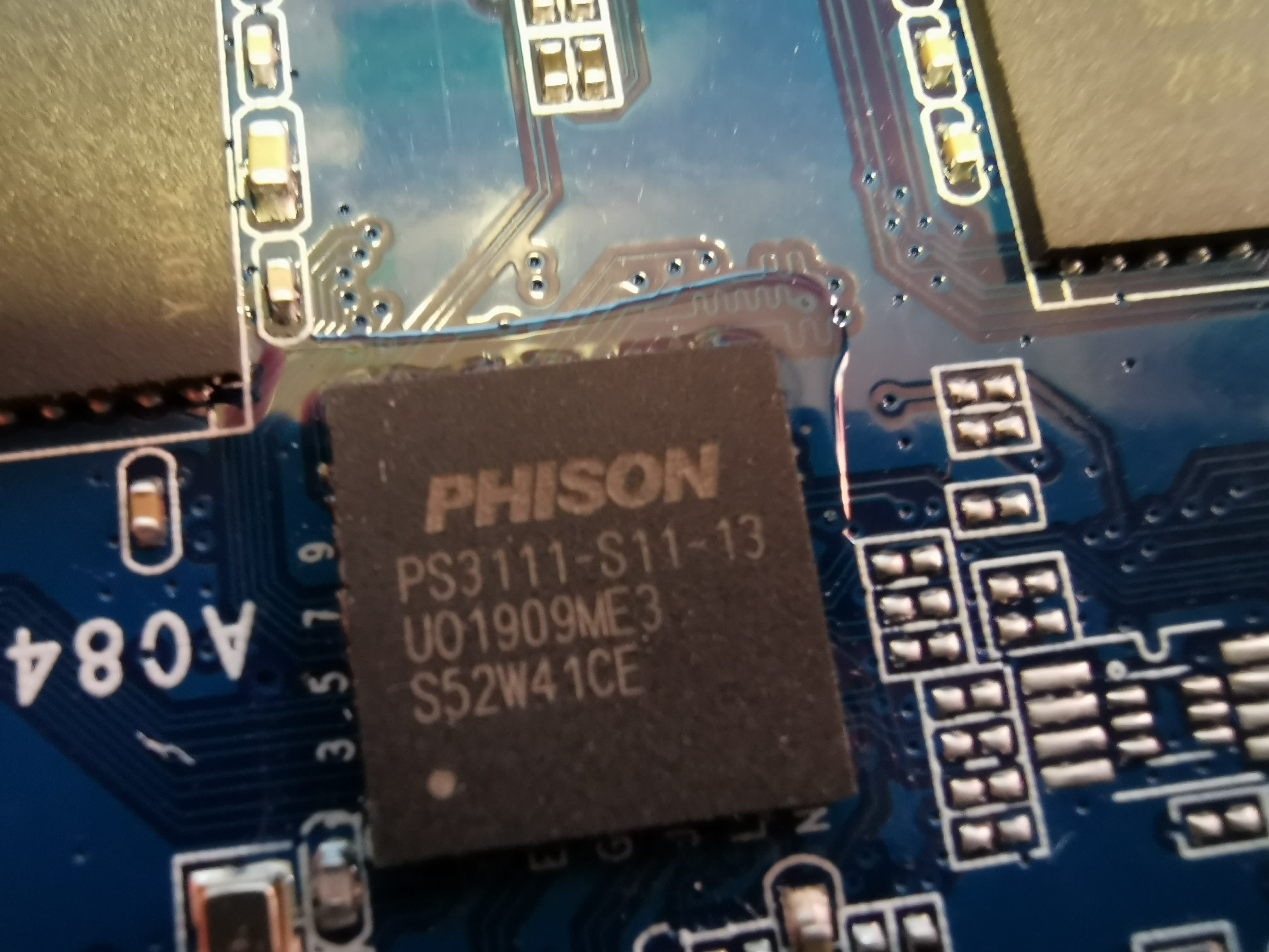

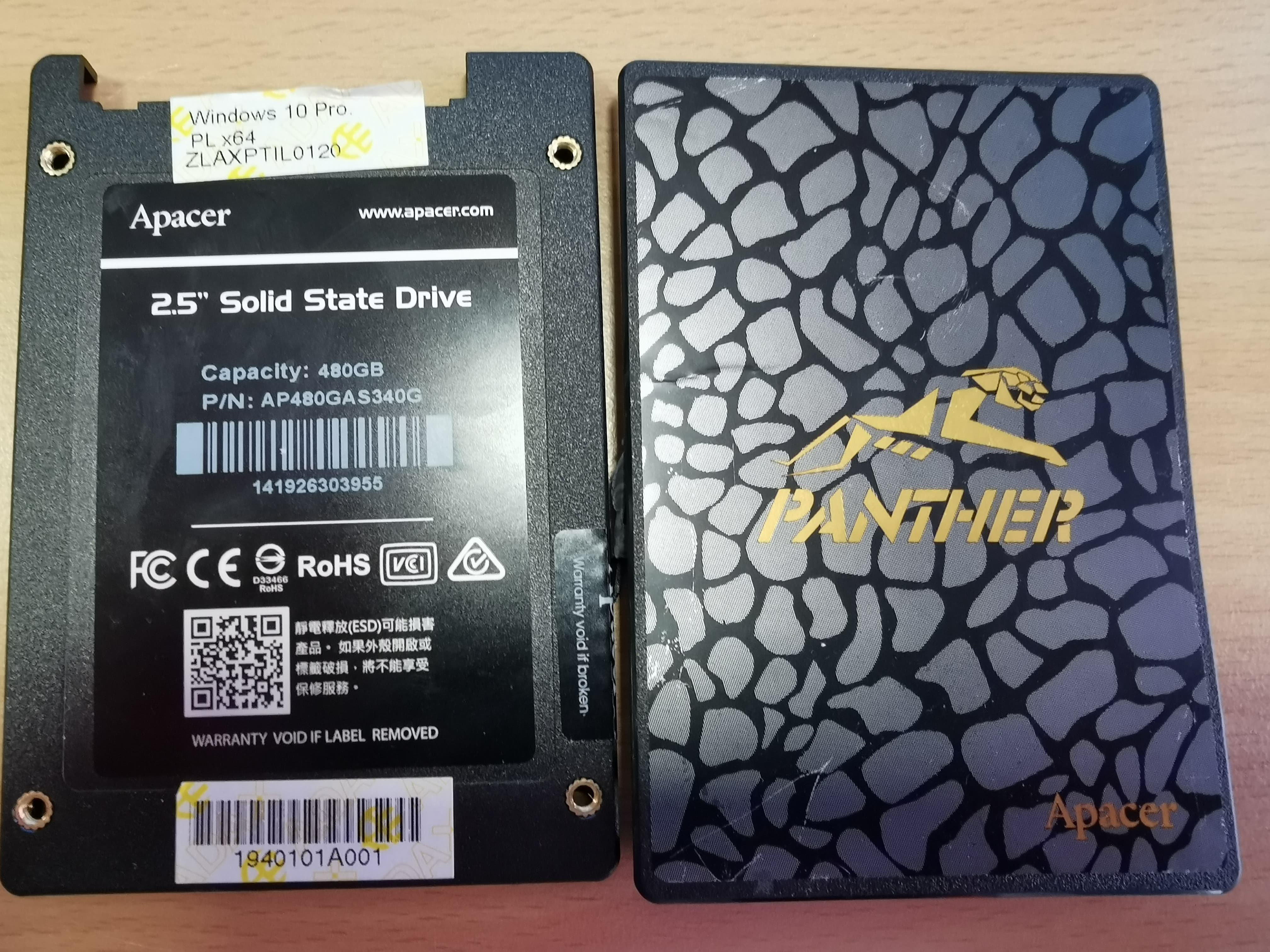

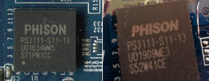

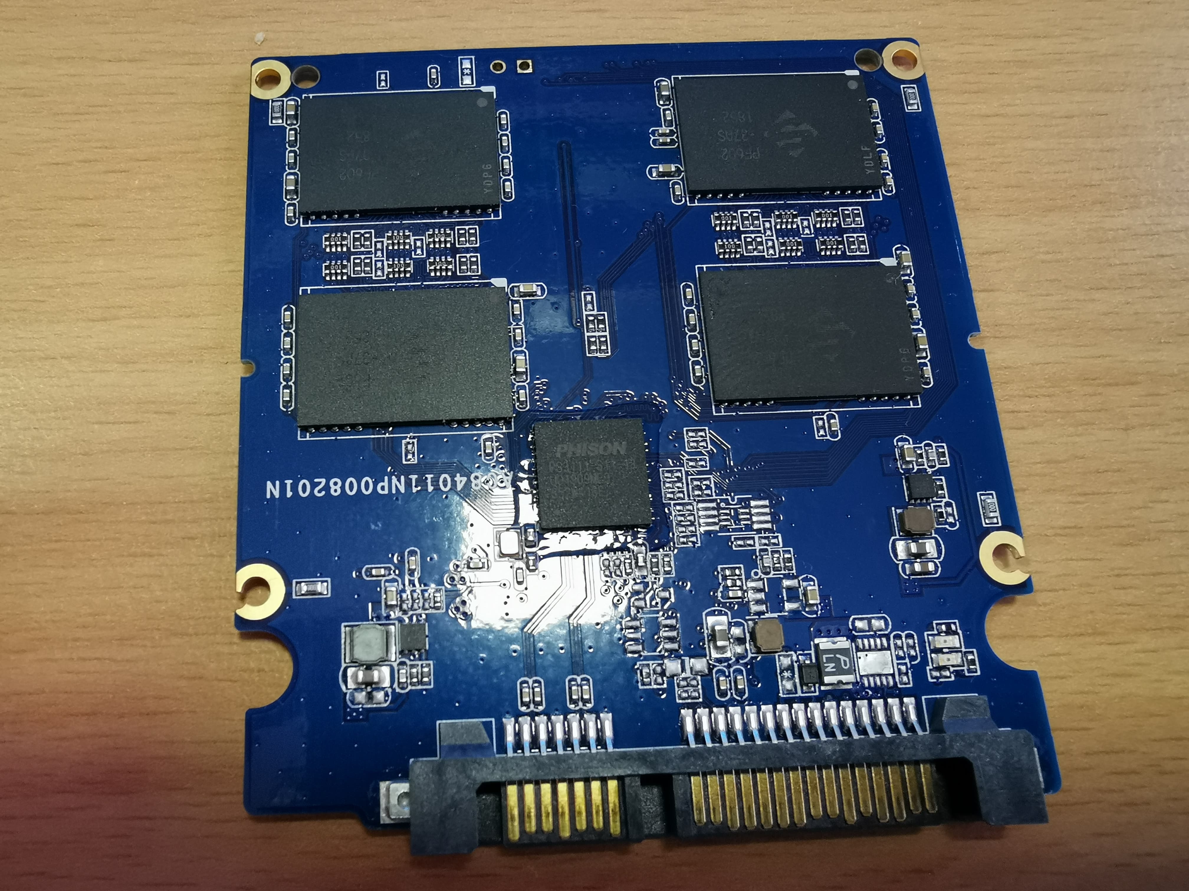

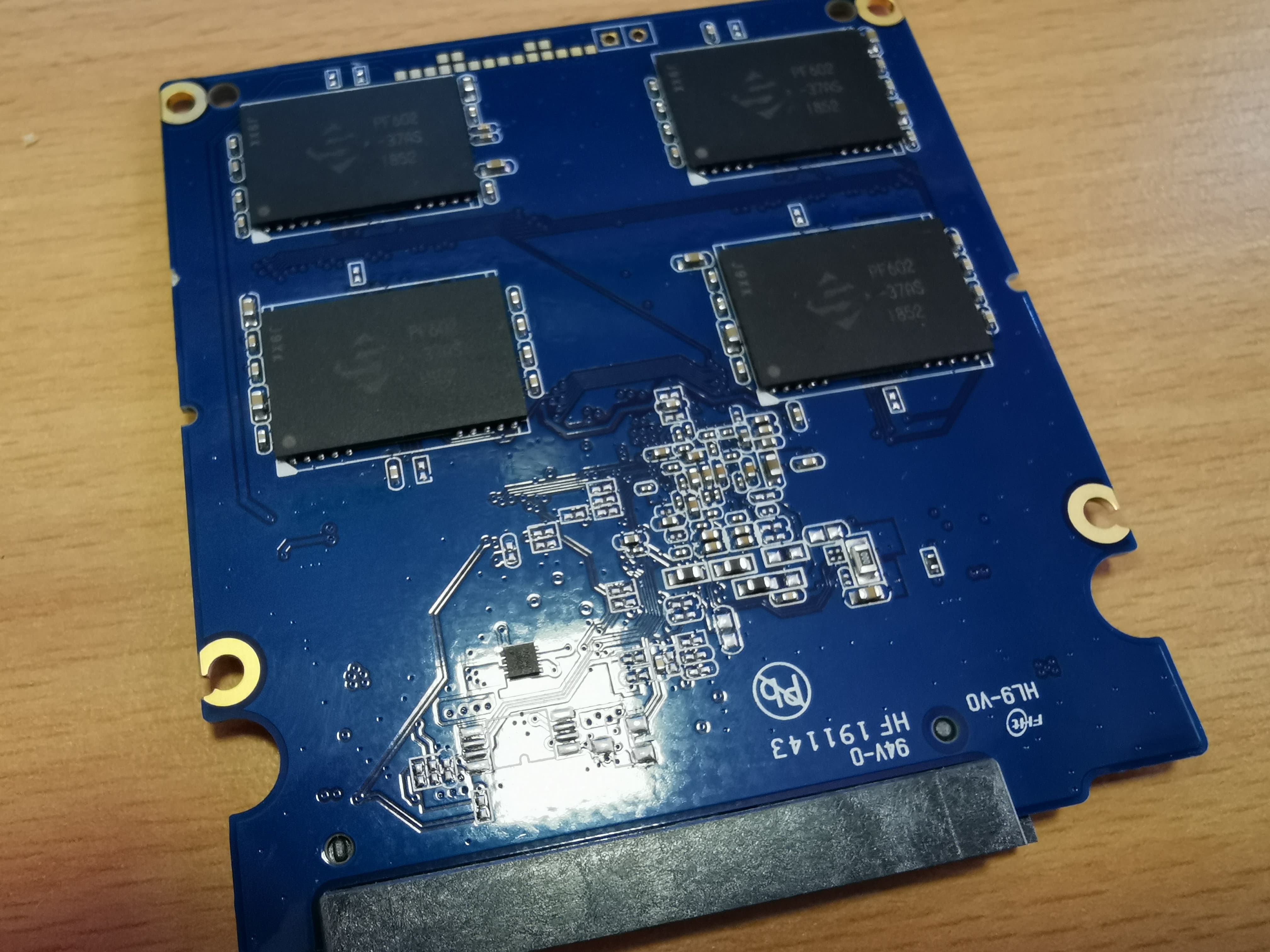

Hey
Have you met with a similar disk with such a controller? It is completely different than the normal PS3111 (not only about the type of font used on it)
No loader is compatible in the current pc3k version.
The disk is detectable but all its capacities are zero

Hello. I'm doubt that it's a Phison fake, because PS controllers are the cheapest in SSD sphere.
Try to short it in SAFE MODE and leave it shorted all the time. Also, use PATA to SATA connection to communicate with it.
If all loaders doesn't provide any good result, then please contact with TS on ts.acelab.eu.com, we have some ideas.
