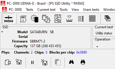

i had a case like that
the ssd model was TLC SATA III 240 GB, its controller was asolid AS2258BN

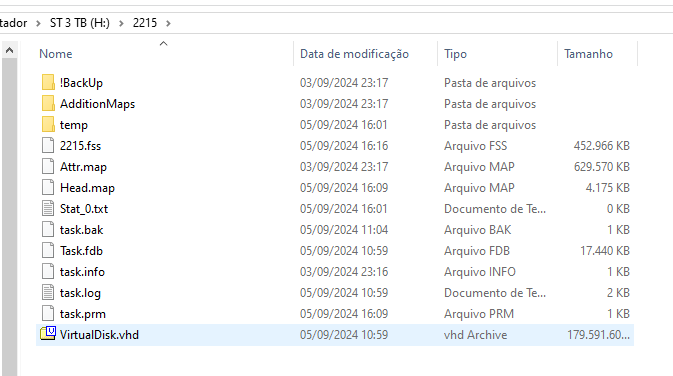

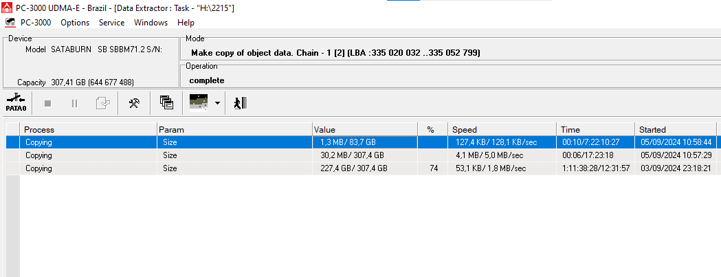

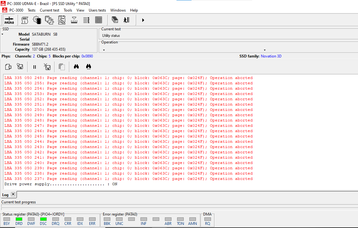

it was recognized for my pc3k only chosing SSD family Novation 3D model SATABURN SB firmware SBBM71.2, in the utility reconized 137 GB and in the extractor recognized 307 GB , it was cloned sucessifully 227,4 GB and data was recovered, i had to make before short circuit and Loader uploading.
