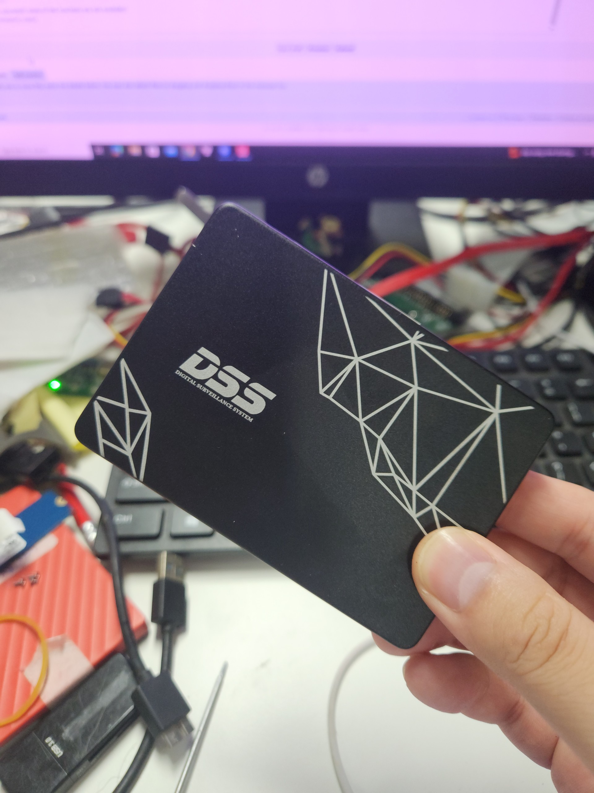

I am just uploading this cases for the future updates of PC3000
DSS Digital surveillance system SSD from Dahua
Using SM2259XT controller
Model : SM59XT2A-80-50000001
Serial : (03)5526888-20080228
Firmware : 20210308
Capacity : 1 GB (2 096 640)

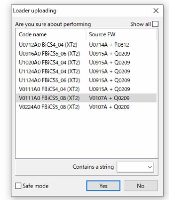

Same problem here! Invalid FW mode 5 (0) iv selected the firmware suggested by the utility but i get Invalid FW mode 5 (0) ! sometime i can rebuild the translator but serial number and capacity doesnt change! im stuck

Roman_TS wrote:Source of the post Passport ID in Utility means nothing. It always shows you the default template, no matter what is the real capacity of the drive. You can see the real capacity only in DE when you make a new task.

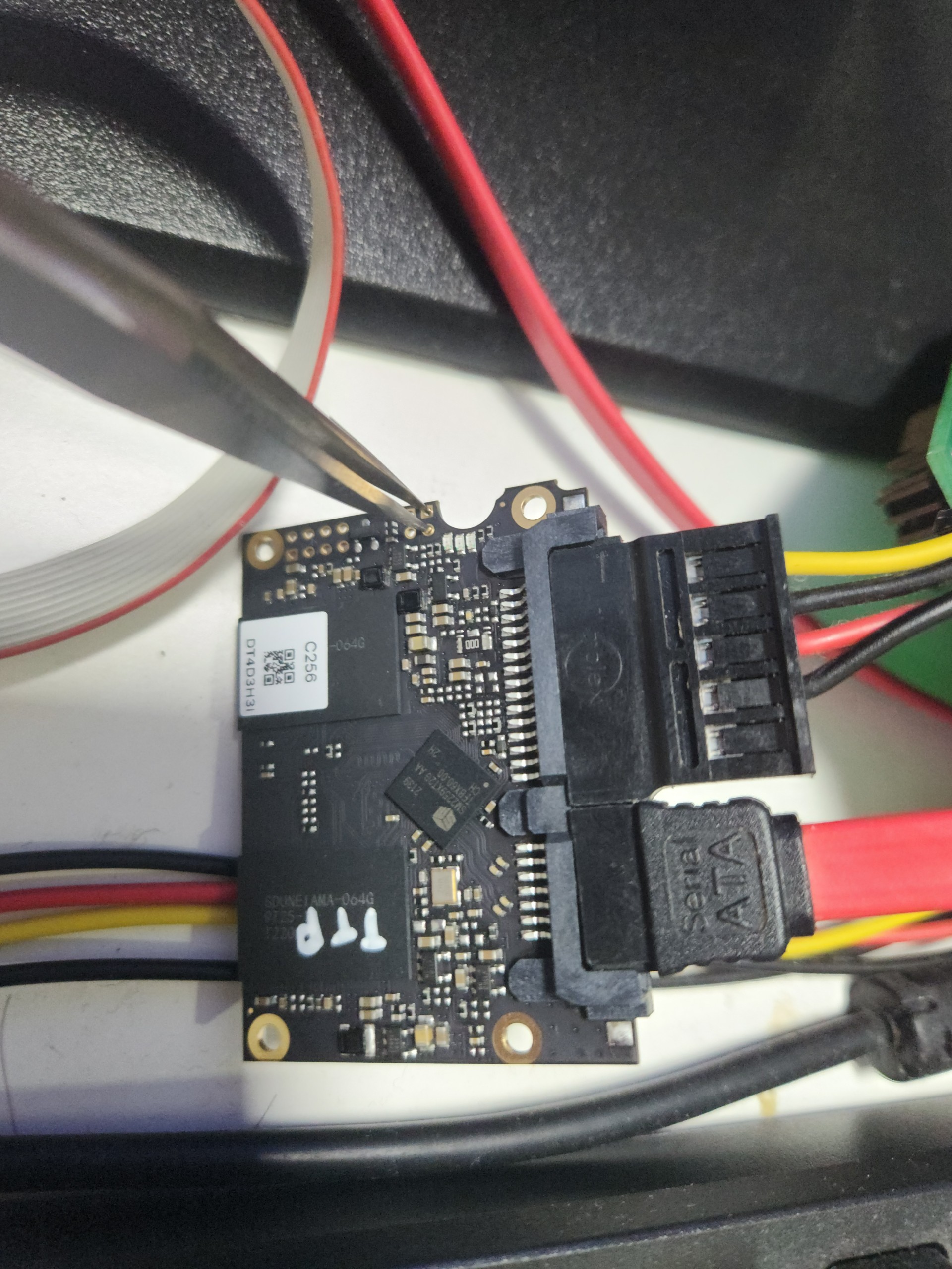

thank you Roman! but the guide is not clear and i still get Invalid FW mode 5 (0) when i select the loader! should i keep shorted ? should i check on SAFE MODE?
safe mode.JPG (10.54 KiB) Viewed 17141 times
Re: SM2259XT New Firmware, Loader needed in future SSD updates
Postby Roman_TS » 31.10.24, 09:06
Here is the guide about correct loader uploading:
https://blog.acelab.eu.com/pc-3000-ssd- ... t-xt2.html
If your internal drive firmware 100% compatible with the loader, but you got some issues with the final drive initialization - ask your customer about the story of this drive. Probably SSD was formatted, or customer already tried to update FW by himself.

The guide you gave me doesnt work properly! the utility finds the loader but it doesnt work.....
Postby Roman_TS » 07.11.24, 08:52
Make sure that all NAND chips IDs are reading fine. There could be a hardware problem with this SSD.
Also, you can try to check neighbour loaders with similar V01XXXX FBiCS5_08 family.
